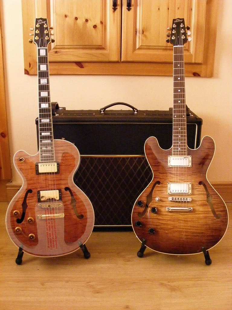

SouthpawGuy Posted August 31, 2010 Posted August 31, 2010 A side by side shot of both for comparison. My Millie has HRWs and the Prospect has Seth Lovers, they are vastly different in tone. The Millie does tend to sound more like a solid body, especially the bridge pickup which is actually very good for metal type tones with od / distortion and with a clean sound can be very tele like. Shot of the Millies' semi solid construction ...
koula901 Posted August 31, 2010 Author Posted August 31, 2010 SouthpawGuy, I take it the Millie is the one on the left side (single cut). Yes, the one I heard had HRW's and I loved the sound. So they are two different beasts. I notice that they both pose in front of a lovely Vox! Are there ever any problems with the floating block in the Prospect?
tulk1 Posted August 31, 2010 Posted August 31, 2010 SouthpawGuy,I take it the Millie is the one on the left side (single cut). Yes, the one I heard had HRW's and I loved the sound. So they are two different beasts. I notice that they both pose in front of a lovely Vox! Are there ever any problems with the floating block in the Prospect? Both of my Prospects had a "tendency" towards feedback. I used the 'ol Nuge trick of putting a bit of natural sponge between the block and the back. Has no noticeable effect on tone, but sure helped tame the occasional feedback problem.
