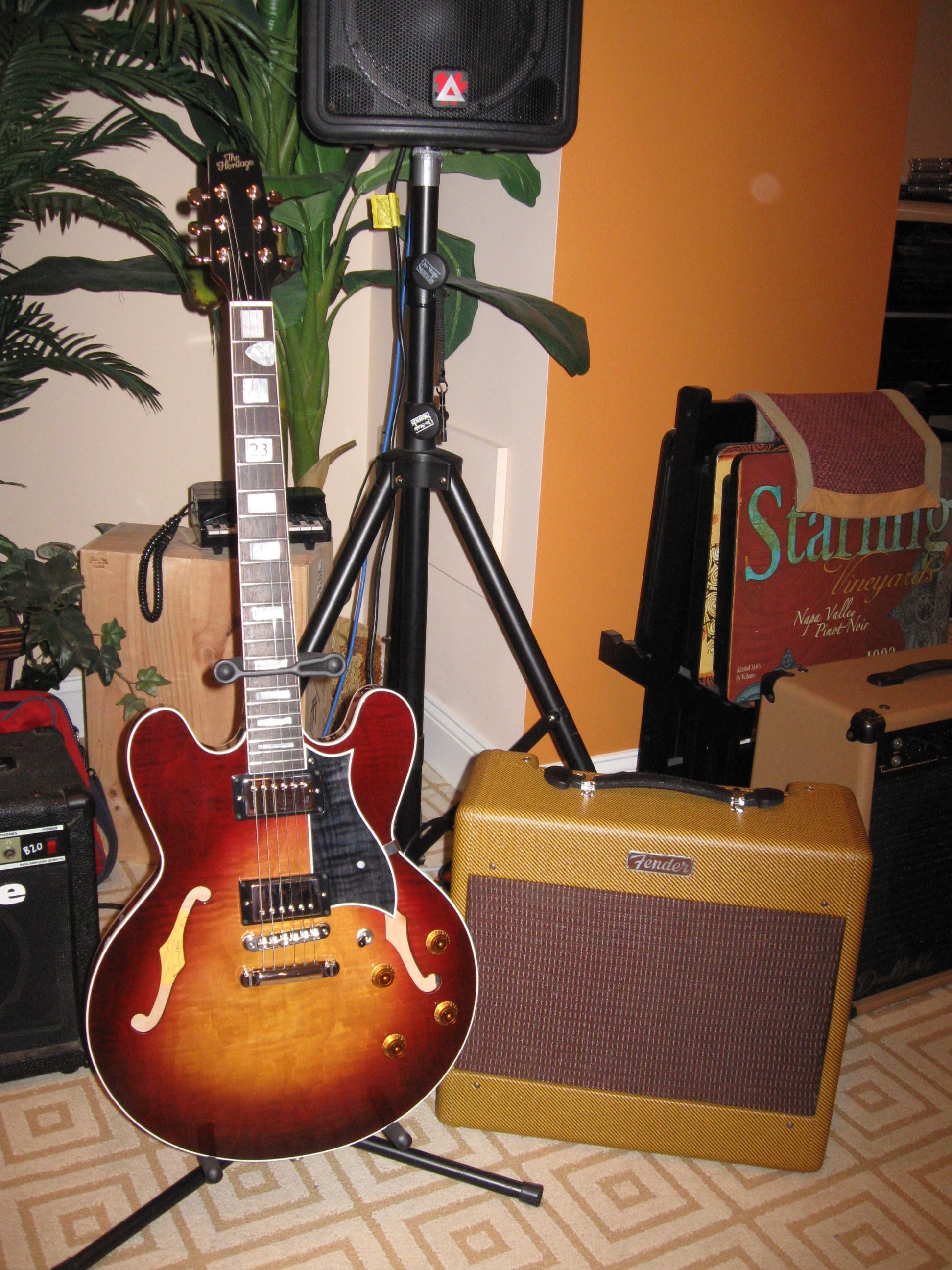

NoNameBand Posted September 14, 2010 Posted September 14, 2010 Being as I just figured out how to get pictures in here and, the thread is about a 535, I thought I would finally show a picture of my 23rd Anniversary 535. First appearance on the site.

schundog Posted September 15, 2010 Posted September 15, 2010 Being as I just figured out how to get pictures in here and, the thread is about a 535, I thought I would finally show a picture of my 23rd Anniversary 535. First appearance on the site. Wow, Mark, as much as I love the look of that 535, especially with blocks, that tweed Fender about knocked my socks off!! How long have you had it? Verrry cool.
NoNameBand Posted September 15, 2010 Posted September 15, 2010 Wow, Mark, as much as I love the look of that 535, especially with blocks, that tweed Fender about knocked my socks off!! How long have you had it? Verrry cool. Thank you fore the complements. They do make a nice couple don't they? The Tweed is a '55 and was a gift to me from one of my best friends and mentor, the original owner before he passed away in 2007. He had recovered it in 1964 to appear more modern, with black nogahide. I called Fender to ask their advise on a restoration and they suggested MOJO Music in S. Carolina. Mojo is who makes all of the Tweed cabinets for Fender's Vintage Amp series. The extent of the restoration was: new tweed w/ aged lacquer, re-chrome the handle brackets & re-stitch the leather handle. The rest was just cleaning. Everything is original except the tweed, tubes and a 3 way power cord. It has and remains working fine. Great warm, clean sound on 3 or 4 as well as a great nasty sound cranked up to 11. The 535, now with Pyramid Pure Nickel classic strings (jewelery), is having an affair with the Tweed. I believe they were made for each other.
