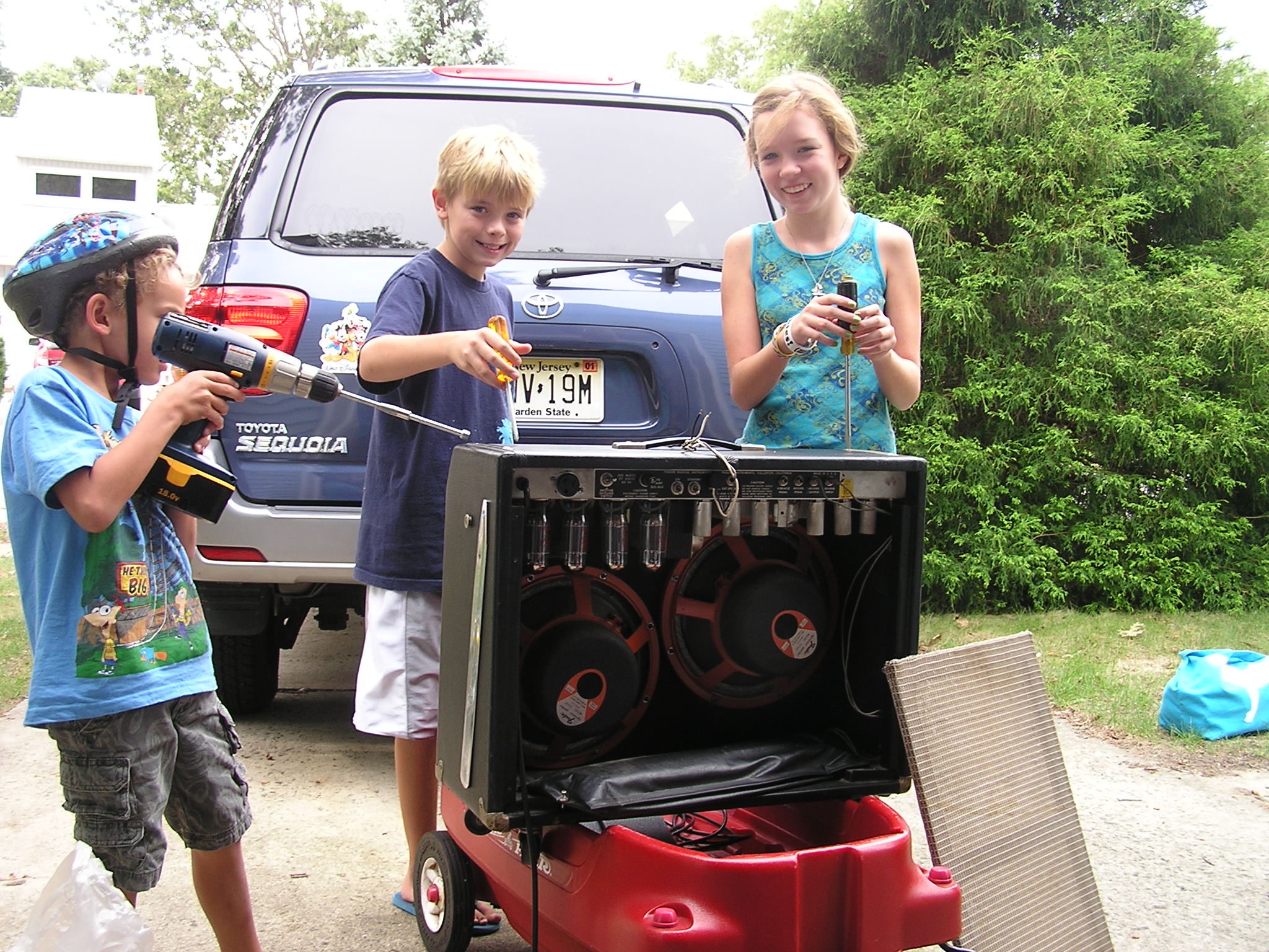

Hfan Posted October 16, 2010 Author Posted October 16, 2010 Just nearly had a heart attack, my new Eminence Red white and Blues arrived a few days ago had been on back order from Muscians Friend for weeks, had them in my garage waiting for time to install them. Just walked into my garage and the box is covered with holes, looks like it was shot up. Turns out my 6 year old son thought it was a good idea to poke holes in the defenceless box, all 4 sides. Opened it up, only one hole made it thru one of the the actual Eminence boxs inside, it was right over the paper portion, but luckily did not make it into the speaker. Would this have been covered by warranty? http://s715.photobuc...current=013.jpg
Gitfiddler Posted October 16, 2010 Posted October 16, 2010 Just nearly had a heart attack, my new Eminence Red white and Blues arrived a few days ago had been on back order from Muscians Friend for weeks, had them in my garage waiting for time to install them. Just walked into my garage and the box is covered with holes, looks like it was shot up. Turns out my 6 year old son thought it was a good idea to poke holes in the defenceless box, all 4 sides. Opened it up, only one hole made it thru one of the the actual Eminence boxs inside, it was right over the paper portion, but luckily did not make it into the speaker. Would this have been covered by warranty? http://s715.photobuc...current=013.jpg Hmmm...looks like your son is headed for a career with UPS. Glad nothing happened to the speakers.
Hfan Posted October 23, 2010 Author Posted October 23, 2010 Finally installed the Red White and Blues (after checking again for kid installed holes thru them), I like the results. Although they are not "broken in" yet, there is a grittier quality that I like. Also the amp seems to be a little lighter then with the JBLs installed. I still have a little bit of an issue with what I would describe as a buzz or rattle sound on decay when playing a loud bass note (the low A seems to bring it out especially) occurs on both channels. Don't have the time or inclination to rip out the chassis again and go hunting (my workshop is the kitchen table when the wifey and kids are not around, not condusive to leisurly nonrushed troubleshooting). Although any thoughts from our resident gurus would be welcome, I may rip it apart again at a later time. Will do some pre amp tube swapping first. I did a pretty thorough restoration last summer though I did leave all but one of the old blue Mallory caps installed (coupling caps if I remember right). She does sounds sweet at family room levels though. Thanks for everyone's input on the project.
