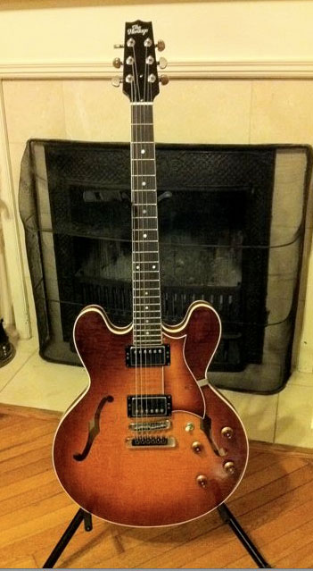

jackmusic Posted October 4, 2010 Author Posted October 4, 2010 Thanks for the advice. I think I have some graphite lube in the workshop. I'll try that. Later this year I'll have my luthier put in a bone nut. Here's a photo of the guitar. (I hope this works.) Snapshot_2010_10_03_20_52_55.tiff
schundog Posted October 4, 2010 Posted October 4, 2010 Sweet 535, brother! I'd be surprised if the graphite didn't work.
tulk1 Posted October 4, 2010 Posted October 4, 2010 Thanks for the advice. I think I have some graphite lube in the workshop. I'll try that. Later this year I'll have my luthier put in a bone nut.Here's a photo of the guitar. (I hope this works.) Snapshot_2010_10_03_20_52_55.tiff ALSB - always looks great on 535s.
smurph1 Posted October 4, 2010 Posted October 4, 2010 +1 on the graphite, chap stick, or nut sauce..Sweet 535..I absolutely love mine!! Just ask anyone on this board..

jackmusic Posted October 7, 2010 Author Posted October 7, 2010 Pardon my ignorance of things Heritage, but what is ALSB? ALSB - always looks great on 535s.
Thundersteel Posted October 7, 2010 Posted October 7, 2010 BTW thanks for all the free advice. Free? Wait until you get the bill! Pardon my ignorance of things Heritage, but what is ALSB? Almond Sunburst.
Patrick Posted October 7, 2010 Posted October 7, 2010 Pardon my ignorance of things Heritage, but what is ALSB? ALSB = Almond Sun Burst. . . that's the color of your 535 . . . and it's pretty!!!

jackmusic Posted October 9, 2010 Author Posted October 9, 2010 Free? Wait until you get the bill! Almond Sunburst. So that's what my color is!!! I love it, and every who sees it is wowed by it.
