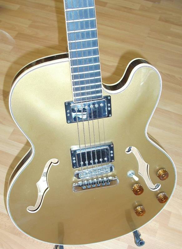

Guest mgoetting Posted October 5, 2010 Posted October 5, 2010 I have a Roy Clark single cutaway 1 5/8" nickel which craves a Bigsby. The Bigsby site shows this guidance on selection: ■Model B-3 is designed for thin electric guitars ■Model B-5 is designed for flat top solid-body guitars ■Model B-6 is designed for large acoustic and arch top guitars ■Model B-7 is designed for thin electric guitars with more downward pressure ■Model B-11 is for thin electric guitars with an arch ■Model B-12 has a pressure bar and is designed for large acoustic and arch top guitars So do I need a B3 or B7 or B11? What is the downward pressure about? Bigsbys look easy to install. Any pitfalls? Thanks.

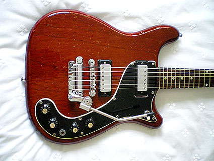

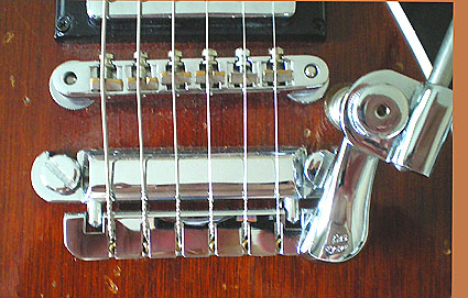

peteraltongreen Posted October 5, 2010 Posted October 5, 2010 I have a Roy Clark single cutaway 1 5/8" nickel which craves a Bigsby. Thanks. I Favour the unit shown below.It fits directly on to the studs,and doesn't need screws damaging the guitar top.It leaves no marks at all.I've used this unit on my H140CM,my ES335,and it's currently on by '64 Epiphone Wilshire. It's called a Les Trem,made in Germany & Distributed by Duesenberg.It's also very stable in use. Peter Alton Green.
Kuz Posted October 6, 2010 Posted October 6, 2010 I have a Roy Clark single cutaway 1 5/8" nickel which craves a Bigsby. The Bigsby site shows this guidance on selection: ■Model B-3 is designed for thin electric guitars ■Model B-5 is designed for flat top solid-body guitars ■Model B-6 is designed for large acoustic and arch top guitars ■Model B-7 is designed for thin electric guitars with more downward pressure ■Model B-11 is for thin electric guitars with an arch ■Model B-12 has a pressure bar and is designed for large acoustic and arch top guitars So do I need a B3 or B7 or B11? What is the downward pressure about? Bigsbys look easy to install. Any pitfalls? Thanks. Again Mark, I would point you toward contacting Heritage directly. The curve on the top of the bodies are different between models and you need to make sure you get the right one that fits. Call Ren. That's my advice. Good luck.

Guest mgoetting Posted October 6, 2010 Posted October 6, 2010 I Favour the unit shown below.It fits directly on to the studs,and doesn't need screws damaging the guitar top.It leaves no marks at all.I've used this unit on my H140CM,my ES335,and it's currently on by '64 Epiphone Wilshire. It's called a Les Trem,made in Germany & Distributed by Duesenberg.It's also very stable in use.Peter Alton Green. Peter, How does it compare to a Bigsby in the vibrato effect? I'm worried it may work like those crappy SG whammy bars I twanged with as a kid. The Les Trem seems too good to be true! My Roy Clark won't take a hit in its image with a Bigsby. I may even look for those dice knobs Big Bob had. Thanks for your help. If you find the Les Trem sounds similar to a Bigsby, I'm interested. I'll also ask Ren for his take on this.
big bob Posted October 6, 2010 Posted October 6, 2010 I Favour the unit shown below.It fits directly on to the studs,and doesn't need screws damaging the guitar top.It leaves no marks at all.I've used this unit on my H140CM,my ES335,and it's currently on by '64 Epiphone Wilshire. It's called a Les Trem,made in Germany & Distributed by Duesenberg.It's also very stable in use.Peter Alton Green. Danger Do not buy a les trem. get a bigsby... One who knows...

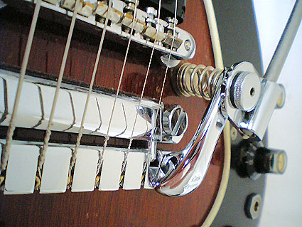

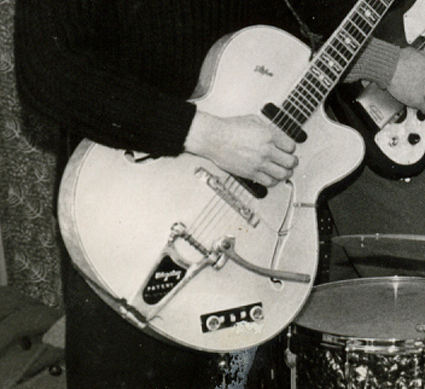

peteraltongreen Posted October 6, 2010 Posted October 6, 2010 Peter, How does it compare to a Bigsby in the vibrato effect? I'm worried it may work like those crappy SG whammy bars I twanged with as a kid. The Les Trem seems too good to be true! My Roy Clark won't take a hit in its image with a Bigsby. I may even look for those dice knobs Big Bob had. Thanks for your help. If you find the Les Trem sounds similar to a Bigsby, I'm interested. I'll also ask Ren for his take on this. I see I have disapproval already.If your trem use is light,and semitone pitch drops,the Les Trem is fine.If you are more adventurous i.e. Whole tone drops & frantic whammy,I agree,don't get one.By using a Bigsby,you are adding an American made product to an American made guitar,and generally accepted.My comment is that the damage caused by the Bigsby is unsightly upon it's removal.I've seen too many great guitars spoiled by a Bigsby's screw holes. However,if you can get a short Bigsby,( photo 1 ) as show fitted to my 1960 Hofner Club 60,then that's great,as the only screws are in the end,and covered by the tailpiece plate on removal ( if it has one ). I think they still do a longer one for larger bodied guitars ( photo 2).Do make sure you get a good break angle over the bridge.The Bigsby only successfully operates about the same as the Les Trem,in my experience.If you want to sharpen the tone,the spring can drop out,or re locates,same as the Les Trem. I just think the Les Trem's a good idea,easily fitted & removed,with no damage,and re located to another guitar in minutes. Please take on board everyone else's comments,most members are younger than I,and play a more modern style,then decide. Peter Alton Green

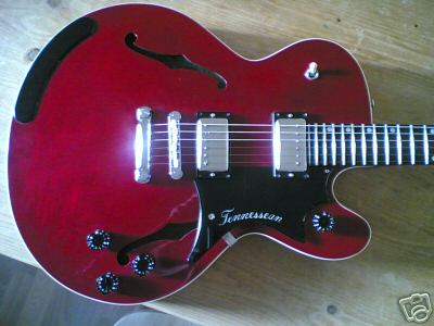

H Posted October 6, 2010 Posted October 6, 2010 Adding a Chet Atkin's arm to the Bigsby would look great on this guitar. I was just thinking that the Roy Clark guitar looks a lot like my Chet Atkins Tennessean...
Guest mgoetting Posted October 6, 2010 Posted October 6, 2010 I was just thinking that the Roy Clark guitar looks a lot like my Chet Atkins Tennessean... I'm thinking that Chet wants to come back home.
LH575 Posted October 6, 2010 Posted October 6, 2010 I had a guy from gretschpages build me a custom screw plate for a Bigsby so I could install on my 575 without drilling new holes. PM me for contact info if needed.
jazzrat Posted October 6, 2010 Posted October 6, 2010 That's what I was gonna suggest...they make a plate (Vibramate) that ties into the stop tailpece studs so no holes are required. http://www.vibramate.com/vibramate-v7-lp-install.php Works with the carved top of an LP....not sure about the Heritage RC....best call.
