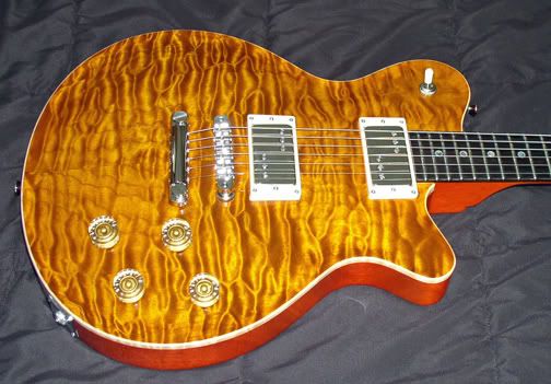

GuitArtMan Posted October 8, 2010 Posted October 8, 2010 Let me suggest one other pickup: Lindy Fralin Split Single P92. Gorgeous P90 tone, no P90 hum. I have a set in this and love 'em:

H Posted October 8, 2010 Author Posted October 8, 2010 Let me suggest one other pickup: Lindy Fralin Split Single P92. Gorgeous P90 tone, no P90 hum. I have a set in this and love 'em: Thanks for the tip, my list is gradually expanding Fantastic quilt on that guitar - is it a Framus?

GuitArtMan Posted October 8, 2010 Posted October 8, 2010 Thanks for the tip, my list is gradually expanding Fantastic quilt on that guitar - is it a Framus? Don Grosh Set Neck. Here's my other one with the stock Fralin Humbuckers (which sound really frickin' good btw):
