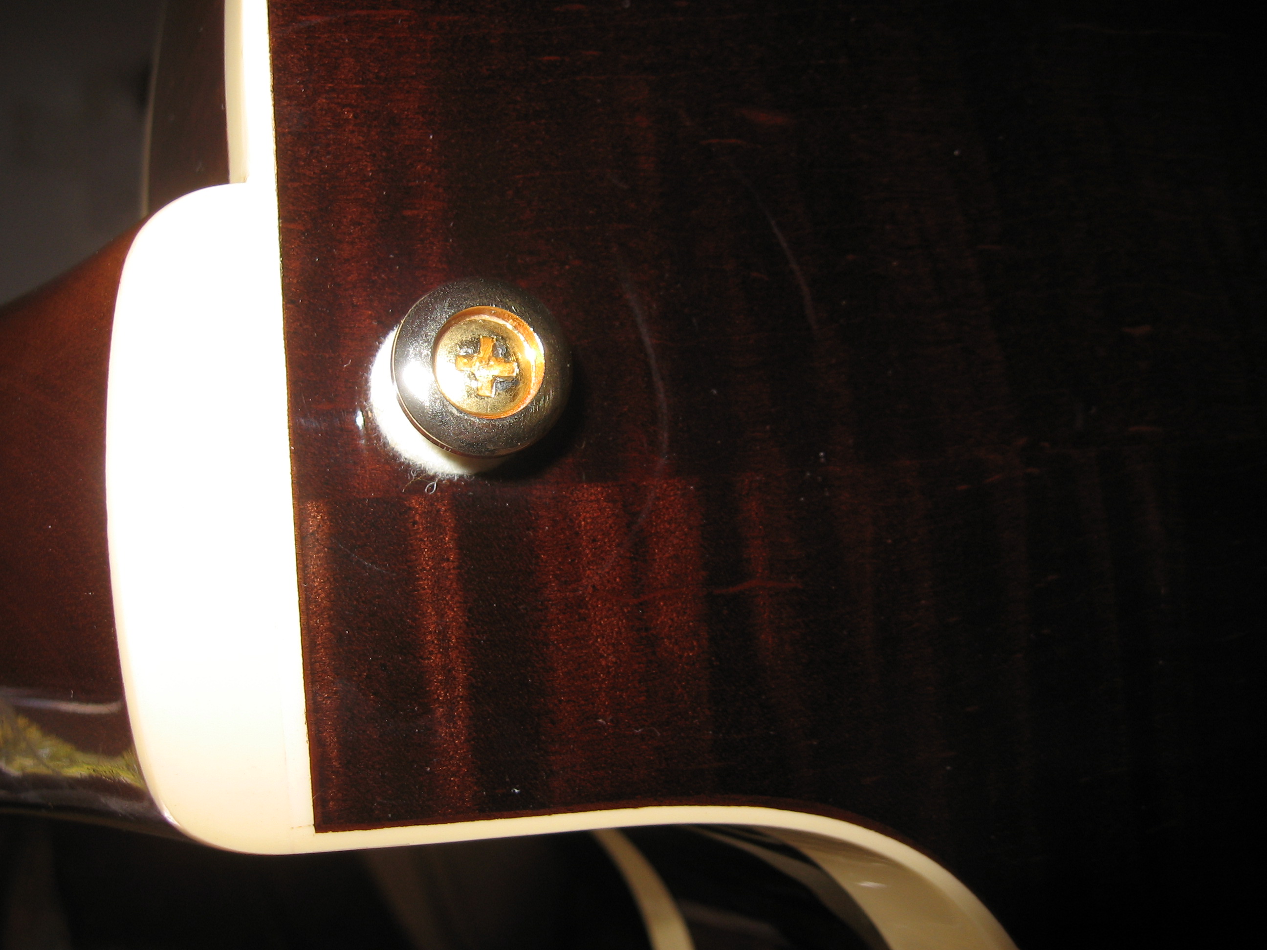

ronalr Posted October 13, 2010 Posted October 13, 2010 I had a luthier add one to my 575...just like the Heritage picture to the left ....I would not try that my self either....he did a great job and it looks like it came from the factory that way.....will have to take a picture of it with the new strap button....but here it is

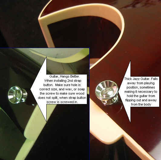

Kuz Posted October 13, 2010 Posted October 13, 2010 I would really contact Jay Wolfe first!!! I bought my 575 Custom from him and he recommend the EXACT OPPOSITE of the Heritage web pic for the strap button. He assured me the guitar would lay perfect with the strap on, and said the body is more stable for a screw to be inserted than the neck. I play most of the time standing with my 575 and it plays/hangs perfectly!!! Click to enlarge this pic and you can see where Wolfe put the strap button.
