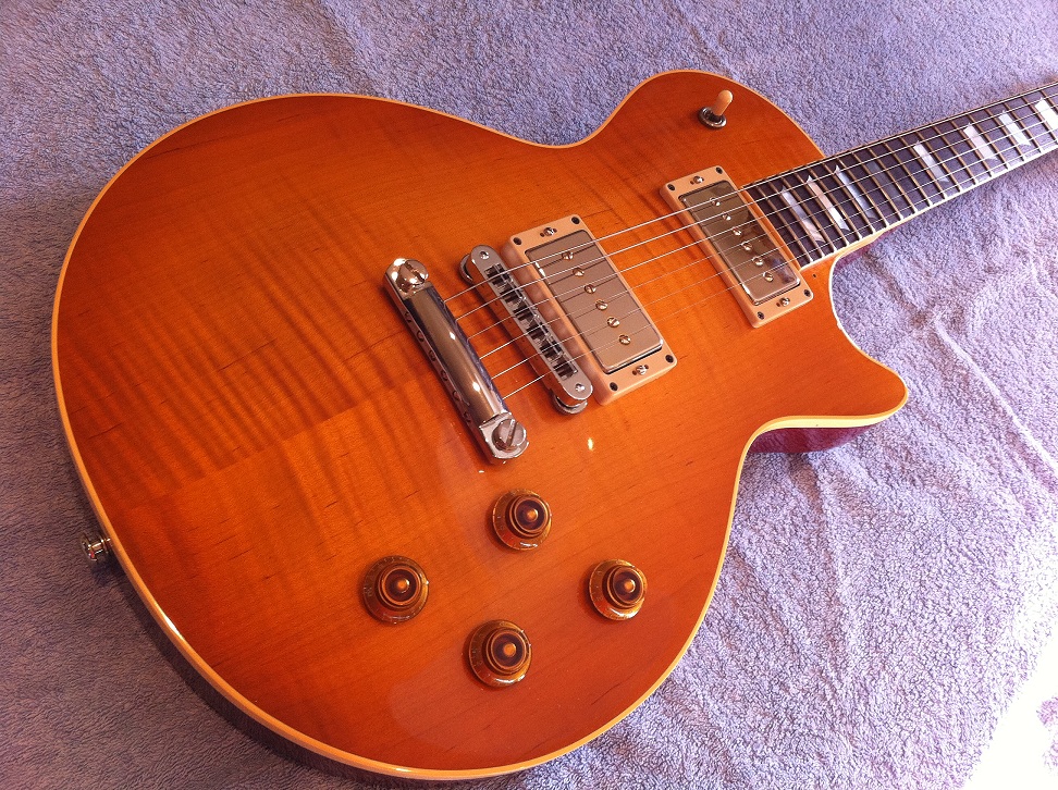

H Posted October 16, 2010 Author Posted October 16, 2010 OK -all done. It took me two hours all in However, I didn't play with the caps as I couldn't find the box with them in Left the stock .022s in there - yellow cylindrical ones with no discernable brand. Looks like I'll have to go shopping! I'm putting the photoshoot up on Photobucket as I don't seem to be able to get all the pics into my gallery. Here's the link: http://s824.photobucket.com/albums/zz165/HowardND/H-150%20Pickup%20swap/ First impressions? HUGE difference in string definition - they completely blow the SD59s out of the water! All the power, none of the mud. The neck has a smooth delivery with the tone up and fabulous 'woman' tone when rolled off. The bridge is monstrous - barking, powerful but beautifully defined even on 10. Sweet and bluesy under 7. I need to adjust the neck pickup a little relative to the strings as it's a little quieter than the neck at the same volume points on the pots. Both together I prefer to neck a little more prominent - my playing style is Cream-era Clapton and I'm pretty sure I'm going to be able to nail lots of his sounds from that time with these pickups. Through my Night Train I can have jangle, chime, blues and blues-rock just from adjustments to the volume pots and flicking from neck to bridge. Through Guitar Rig 4, I can't imagine what fun I'm going to have yet! I knew I would be pleased but I am stunned at how good these sound...
H Posted October 16, 2010 Author Posted October 16, 2010 Click on the pictures to get a bit of info on what was happening
H Posted October 16, 2010 Author Posted October 16, 2010 A pic of the finished article for those too impatient to look on PhotBucket
FredZepp Posted October 16, 2010 Posted October 16, 2010 Great Job.... The pics are quite cool. And the result looks (and I'm sure sounds also) fantastic.
