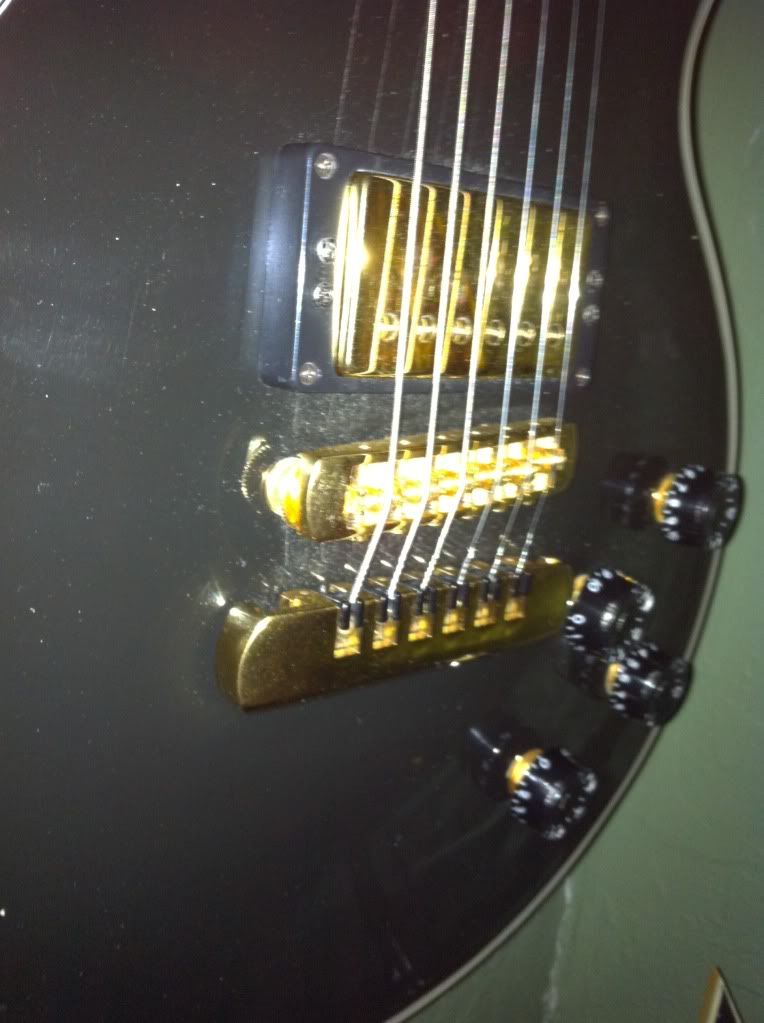

ces Posted October 26, 2010 Posted October 26, 2010 Hey there HOC, my name is Ces. I'm new here. I got my first Heritage yesterday. Long story short: I'm going to do a hw swap on my Heritage and after speaking to my luthier today, I'd like your expert opinions, please. I was advised to change my tail piece for a Nashville style tail stop. And to consider changing my bridge too. Please tell me, If i'm seeking to add a "regular Gibson Les Paul" type tail & bridge to my H-157, what should I get? Authentic Gibson or Tone Pro's? What are the part names so I get the right things? Guitar Center in my area now carries what they call something close to tone pro but different, can't remember right now. sorry. Any info is appreciated. Thanks... btw here are pics of whats on there.

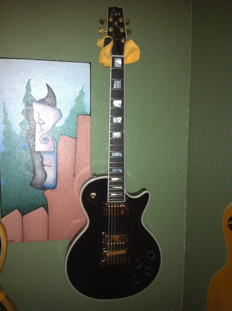

tulk1 Posted October 26, 2010 Posted October 26, 2010 Hey CES, just want to add my "welcome to the HOC". The old Schaller hardware isn't for everybody. Extremely functional, but not what so many have come to associate with the body style. Personally, I don't mind it. But thats just me. Even Heritage is now using TonePros. You could always call them and ask what part numbers they're using. I'm kind of surprised others haven't chimed in with their recommendations. But it looks like H has you all set up. Pics are expected when you get it all swapped out

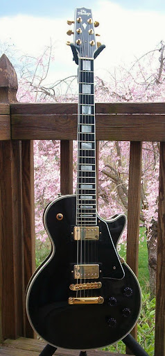

FredZepp Posted October 26, 2010 Posted October 26, 2010 I have Heritage guitars with either hardware, but it was done before I bought it so I can't help with parts. I did buy a Gotoh tailpiece off of eBay, new and supposed to fit Gibsons, that did not work on my 150, for some reason. I didn't pursue it much, as it doesn't matter much to me, I was only going to change it for appearance. Here is what your converted 157 will look like, once completed...

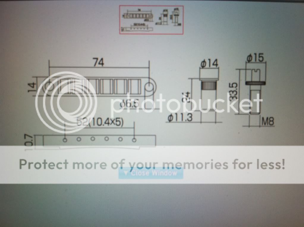

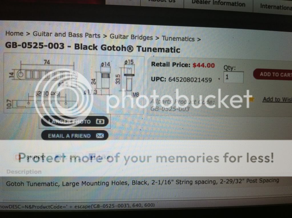

ces Posted October 26, 2010 Author Posted October 26, 2010 right on, thanks for that. After many hours of surfing, reading & studying, i see why it's confusing. There are metric/metric post threads and metric/standard post threads, and that's just one of several specs you have to match up. Now I know how people get the wrong hardware sometimes, it's overwhelming. Heritage factory was too busy and cranky today to share any real info. "call StewMac, they know everything about it" "Metric with small posts" was all i could get and I had to ask 3 times. So I decided to stop bothering the man and say thanks... but StewMac didn't have a clue and don't have black hardware. I took H's advice and called Marquis. When I finally spoke to parts, it ended up being the owner. He was friendly and knowledgeable. He quickly id'd my guitar and correct fitting parts. I ordered the tonepro nashville type bridge and tail stop, in black. full set with extra hardware. He suggested un-notched, due to the quality of the Heritage. It's best left to a luthier to notch the bridge and setup the guitar with its new hardware. Due to our close proximity, I'll have the parts tomorrow most likely. Then off to the luthier... I'm putting this info up in the hopes it's helpful for others in the future. So thanks HOC for the guidance, it worked out well. Here's what I got and where you can find it, and other correct fit parts for your Heritage guitar: http://www.marquisdistribution.com http://www.marquisdi...18b077540913cd5

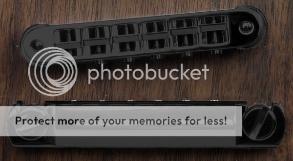

tulk1 Posted October 26, 2010 Posted October 26, 2010 Black Hardware!! Too cool. I had a Custom Stambaugh built using all black hardware. I like it!! Sorry to hear whoever you got on the phone at the 'zoo wasn't all that responsive. Best I could offer is that we're all human. But I truly thought they'd help you. Looks like you got the best help from Marquis, tho'. Good to know! Tone Pros "Zmac" material. Never heard of it. You'll have to let us know what it's like.
ces Posted October 26, 2010 Author Posted October 26, 2010 Black Hardware!! Too cool. I had a Custom Stambaugh built using all black hardware. I like it!! Sorry to hear whoever you got on the phone at the 'zoo wasn't all that responsive. Best I could offer is that we're all human. But I truly thought they'd help you. Looks like you got the best help from Marquis, tho'. Good to know! Tone Pros "Zmac" material. Never heard of it. You'll have to let us know what it's like. yeah I didn't take it personally. I'm still a fan of The H. They're busy staying in business, and technically, I'm not a customer. Anyway, yeah never heard of zmac but we'll see what's up with it. I'm leaving the post threads stock. I'm also leaving the gold Grover tuners, because I've turned a few Grover's in my life, and I've never felt ANY tuner that feel like these do. It felt like a swiss watch being wound. unreal. Also I want to remove the pup covers. anyone done that?
FredZepp Posted October 26, 2010 Posted October 26, 2010 Black hardware , indeed..! Well, yours won't look like my pic. Good luck with the customizing, it sounds like you've got it handled. I was going to post the specs for the hardware that they are sending, but I guess we should wait and make sure that all is smooth. It says metric thread on the bridge and US threads on the tailpiece....
PHILIP Posted October 26, 2010 Posted October 26, 2010 yeah I didn't take it personally. I'm still a fan of The H. They're busy staying in business, and technically, I'm not a customer. Anyway, yeah never heard of zmac but we'll see what's up with it. I'm leaving the post threads stock. I'm also leaving the gold Grover tuners, because I've turned a few Grover's in my life, and I've never felt ANY tuner that feel like these do. It felt like a swiss watch being wound. unreal. Also I want to remove the pup covers. anyone done that? yes I removed pickup covers, use a dremell with a cutting wheel, cut through the solder joint and they then pop of easily
ces Posted October 26, 2010 Author Posted October 26, 2010 yes I removed pickup covers, use a dremell with a cutting wheel, cut through the solder joint and they then pop of easily amy wax mess had to be removed on yours? the pups in my 157 are schaller... how about on mine. what should i expect under there?
ces Posted October 26, 2010 Author Posted October 26, 2010 Black hardware , indeed..! Well, yours won't look like my pic. Good luck with the customizing, it sounds like you've got it handled. I was going to post the specs for the hardware that they are sending, but I guess we should wait and make sure that all is smooth. It says metric thread on the bridge and US threads on the tailpiece.... Marquis said with the posts alone theres a metric width with a metric thread and a us standard width with a metric thread. That's where it all got super fun for me *sarcasm* I gave up on trying to understand it all. I saw many measurements and specs including the ones in these photos...
