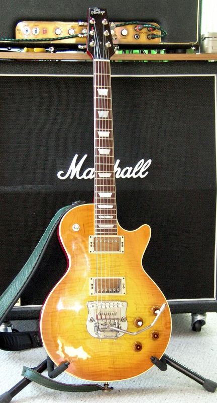

rooster Posted October 30, 2010 Posted October 30, 2010 Hi. Just putting in a review of the Stetsbars I have been using on 2 of my H150s for the last couple years. I won't deny it was a bit of work to set them up right, including "back-filing" the nut to minimize contact, and a bit of adjustment on the set point for the intonation, as a Heritage has a slightly different position of bridge/tailpiece than a modern Gibby (I wouldn't be a bit surprised to learn that the Heritage spacing is the "vintage correct" spacing). However -- they stay in tune extremely well. It took a bit of breaking in, but if I put a little Guitar Grease (basically graphite and paraffin, StewMac sells it for a very reasonable price) in the nut slots before a gig, I can dive bomb the little buggers and come back into tune with a slight tug on the bar. The tone is a tiny bit different, in that it seems a little bit brighter than before, and there is the slightest loss of sustain, but with an H150, it doesn't hurt it much -- those guitars are sustain machines in the first place. Nice units, very well made, much higher quality than just about any trem on the market as far as machining and detail, and I didn't have to cut a big chunk out of my guitars to mount them. Hats off to Eric Stets for a fantastic product at a reasonable price (made in USA doesn't come cheap, as we all know). rooster.
rooster Posted October 30, 2010 Author Posted October 30, 2010 Oh, I forgot -- this post is useless without pics... There we go. rooster.
FredZepp Posted October 31, 2010 Posted October 31, 2010 HA.. I was just ready to post about the pics.... here's one I found...
