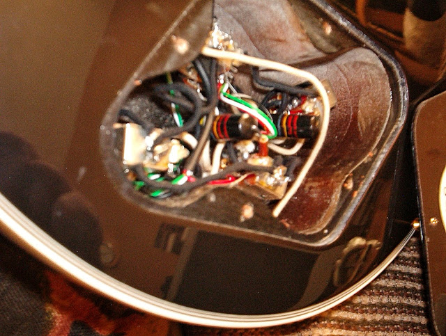

Fixed up my H-150 this evening by switching to 50s wiring, following some work at the weekend to install new caps to a Seymour Duncan diagram. Lost all my Limey Chime and the tone pots were next to useless.
Used this diagram for the 50s wiring
So now my controls look like this
and she sings again :) Beautiful :)

Thanks :) Still learning to solder but I'm not scared of getting in there :)
Lots of wire in that control cavity!

Thanks :) Main thing is that I have the tone I wanted.
Bumblebees, nice! Is the rest of the wiring for coil splits?
It's like the Page setup.. splits, phase, series on push pulls.
I remember your saying that you'd lost that chime... what was it that returned it...?
All I can say is Bumblebees RULE!!!!!!!!
Wow! I think I'd get lost with so many options in there!
I'm not sure which part of the rewire brought the chime/clarity back to be honest. After I'd wired it the Seymour Duncan way (caps piggybacking the tone controls) it got a bit woolly/muddy, as though I had the tone on 4 all the time. I researched this a bit and finally found a post on the mylespaul forum on wiring that helped, explaining how the different wiring variations (vintage, modern, independent volumes, master volume, etc) do what they do. It seemed from those posts that vintage/50s wiring was a good option for me. Twenty minutes of very careful soldering later I had a sound that I'm happy with; not perfect but more than good enough.
