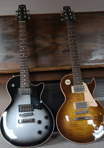

Eric Posted November 20, 2010 Author Posted November 20, 2010 Thanks for the suggetions. Here is a side by side comparison of the two...
yoslate Posted November 20, 2010 Posted November 20, 2010 Thanks for the suggetions. Here is a side by side comparison of the two... That's Brent's silverburst, innit!?
mars_hall Posted November 20, 2010 Posted November 20, 2010 Thanks for the suggetions. Here is a side by side comparison of the two... My quick take on the guitar is to replace the roller bridge with a fixed one. Some have decent luck with the rollers but I would say most probably don't. The roller, being a bearing, will eventually wear on its axle over time and allow the string to move in an undesired direction (i.e pivot) and the roller gap around the axle will increase. Bottom line, the fewer moving parts holding the string, the less chance for energy loss away from the string.
FredZepp Posted November 20, 2010 Posted November 20, 2010 Thanks for the suggetions. Here is a side by side comparison of the two... Excellent .. I love the 140 .. great look to that one. And you have one of the rare Brentrocks Silverburst models. It appears that maybe the 140 maybe has upgraded pickups , with only one adjustment screw per side. Maybe some Duncan 59's or something. And the 140 has nashville style hardware while the 150 still has the roller bridge and Schaller tailpiece. Many would tell you that changing out the Schaller hardware would increase sustain, although I have both and don't have any problems with Schaller . The pickups may make a difference.. you can test some of this by comparing sustain on the two unplugged (acoustically) to see how they compare. You may compare the setup on each , to see if one is set up higher and is allowing the string to resonate more, as that could be a factor. And the wood in the 140 may just have more sustain anyhow.

mars_hall Posted November 20, 2010 Posted November 20, 2010 That's Brent's silverburst, innit!? You would think so, but according to this his poplar one had a bound head, which jives with what I recall. Brent's description Don't know if he had more than one poplar Silverburst. Silverburst I was a H157
