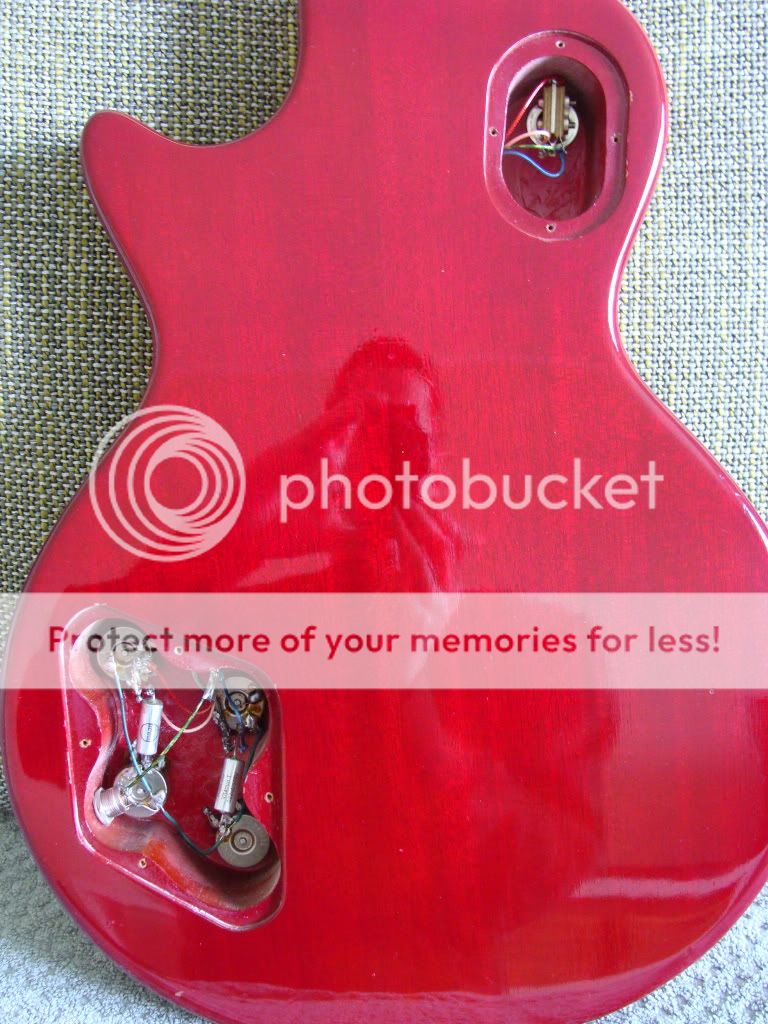

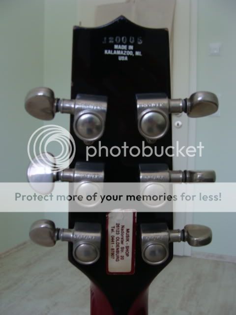

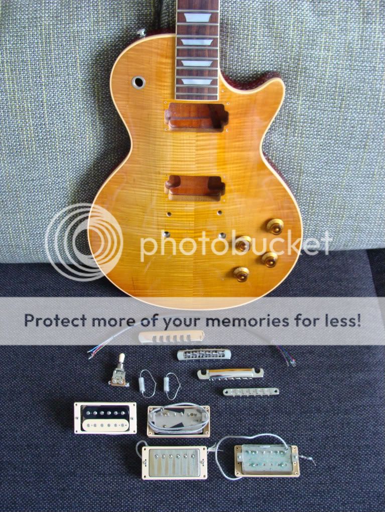

Guido Posted November 26, 2010 Posted November 26, 2010 Hello Everyone! I already started a thread a few month ago about modifying my H150: Modifications to my H-150. Well it took a while to finish the project. But I'm glad to say the journey for 'my' perfect tone is over. I found it! I will never own a '59 Les Paul, but I consider my H150 to be my '59. Because it just can't get any better. A while ago I also did a thread about my pickups. They're from the german luthier Boris Dommenget. You can read the thread here: Pickup comparison with soundfiles. So I won't bother you with the same infos again. I will let the pictures tell the story! The guitar is from 1993 and had no modifications at all when I got it. I bought it used from a german guitar store. It was loaded with SD '59s. Very nice sounding but not what I wanted. Unfortunately the guitar had a sticker on the back of the headstock since '93. But with Virtuoso cleaner and polish I was able to remove it safely. Here you can see the old and the knew parts. The top has been polished with Virtuoso polish and the fretboard has been cleaned with Fret Doctor. I did the aging of the hardware all by myself. I did everything for the first time. But I am really pleased with the results. I left the original pots and the ground wiring untouched. I also didn't use braided wire for the rewiring. I wanted the"Heritage" wiring look. But I used special wire and did also a 50's wiring. Here's the rewiring. First I used Vitamin T caps from MOJO. But after experimenting with caps again I have now some Gudeman Vitamin Q caps installed. Perfect! If you are interested in caps I can recommend axegrinderz.com! After a bad experience with a german Heritage dealer and a knew nut I decided to do it on my own. After three attempts I had a great knew bone nut. I also experimented with strings and found a perfect set for me: DADDARIO EPN110. Of course I did the nut after I found my set of strings. The guitar has a great setup and a very low action. The bridge is right on the top and I have no string buzz at all. It took a while until I found the right truss rod adjustment, but it worked out great. I did everything for the first time and never worked on a guitar before. So I can only encourage everybody to try it. It's a lot of fun and gives you a much better understanding of your guitar. I'm very pleased and proud with the result! So here's my 1959 H150: Hope you enjoyed my thread! Guido

DetroitBlues Posted November 26, 2010 Posted November 26, 2010 What are the new pickups? They look used.

Guido Posted November 26, 2010 Author Posted November 26, 2010 What are the new pickups? They look used. The pickups are from Boris Dommenget. I posted a link in the thread. I wanted all the hardware parts to look used and old. I've never seen a '59 with new parts!

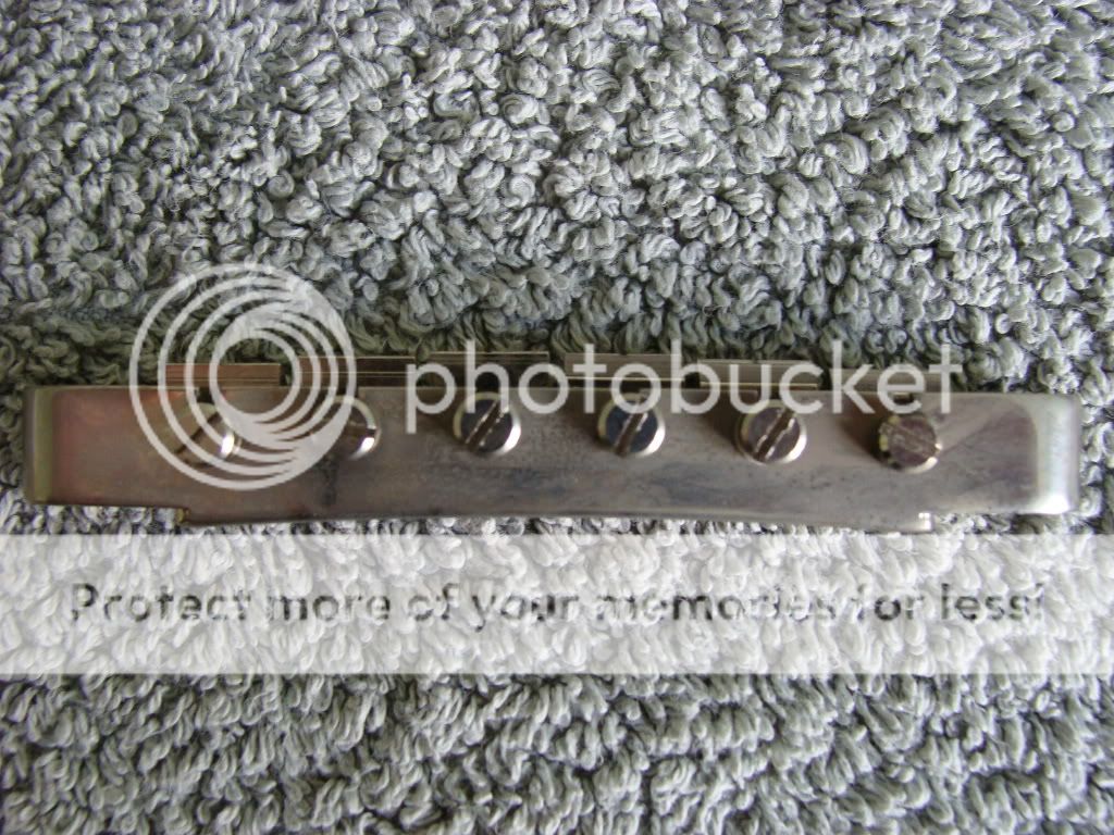

conorb Posted November 27, 2010 Posted November 27, 2010 That looks really nice. Good job. How did you do the aging? Anything you could share or all trade secrets? conorb

Guido Posted November 28, 2010 Author Posted November 28, 2010 That looks really nice. Good job. How did you do the aging? Anything you could share or all trade secrets? conorb Of course I can tell you how I did it. The pickups have been aged by Doris Dommenget which built them. I aged the bridge and the tailpiece and wanted them to match the tuners. So I needed some lighter aging than the look of the pups. I used hydrochloric acid. Here's a link to a video: .But honestly I wouldn't do it again this way. It's very nasty stuff and you really need to be careful while handling it. How it's done is explained in the video. It worked out good and created some tarnish on the parts. But something was missing. So I put the parts for 12 hours in some really strong espresso. I read it in another forum. It really worked out good. But you need to do the hydrochloric acid aging before. Honestly next time I would buy the Faber bridge and tailpiece (the parts I use) already aged. They look great and you don't need to handle the acid. Here's a close pic of the bridge, so you can judge yourself:
