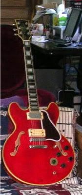

111518 Posted January 12, 2011 Posted January 12, 2011 I agree that this is mostly a matter of style, with perhaps a small measure of tonal difference, as mars_hall (as usual) well explains. The received wisdom ("old guitar player's tale) was that uncovered pickups were brighter and "rock-ier" --remember the Gibson "dirty fingers" pickups, that were uncovered from the factory? I think the advent of the after-market pickup world also had an influence, since the early pickups were almost universally sold without covers, and tended to be creme or zebra coiled, when most factory pickups were black. DiMarzio's, etc., were marketed to be seen. The couple of guitars I still own from my first round of playing back in the late70s/80s show the style that I followed in those days: no cover on the back pickup, cause that's what you used for the bright, rock stuff, cover on the front. I think I was inspired to do this because my most influential teacher, who became a friend when we both worked at the same shop, played a '59 dot neck 335 that had an uncovered original PAF zebra in the back, and I thought --maybe still think-- that guitar was the single cool-est instrument I've ever encountered. Teenager see, teenager do. I wouldn't bother to remove rear covers now, but neither am I inspired to go back and restore the covers to my old warhorses. It is a "look."
MartyGrass Posted January 12, 2011 Author Posted January 12, 2011 That 355 brings back memories. I could have done without the Varitone though. I left it wide open. My teacher had a Johnny Smith. Last year, which is many years later, I finally bought one also. His was a Gibson, mine is a Heritage. Different body depth and pup, both with Johnny's signature. I like mine better. Seriously.
