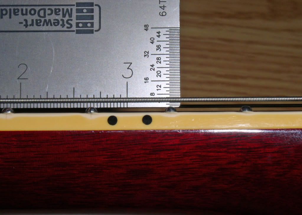

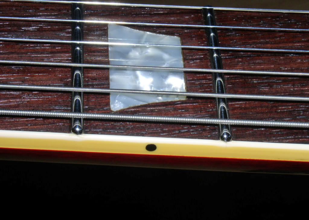

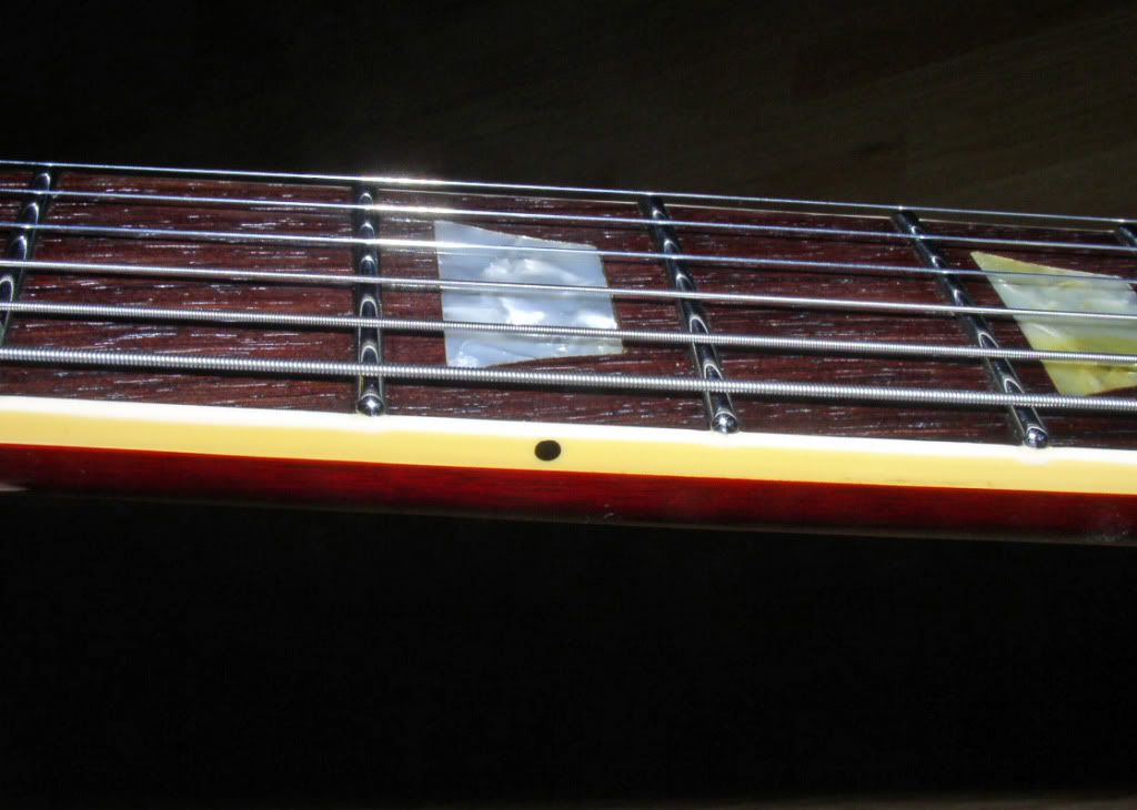

GuitArtMan Posted January 28, 2011 Posted January 28, 2011 PLEK SCHMECK!!! I've owned a bunch of guitars now that were all PLEK'd up. Thank God I found Michael Tuttle and he could get the frets right. Sorry, but I just haven't played a PLEK'd guitar that I felt played as good as an Tuttle, or Anderson, or Grosh or PRS (early ones). Besides it aint the PLEK anyway, it's the guy running it. Just like it aint the radiusing blocks or the neck jig or the fret files, it's the guy using them. Some real fret porn for you courtesy of Michael Tuttle (and no they weren't PLEK'd): My '88 Les Paul Flame Top RI - frets courtesy of Michael Tuttle 3/64" at the 12th fret - no buzzes. My H-535 fretwork by Micahel Tuttle Hmmm... 3/64" at the 12th fret again and not buzzes. A close up of the frets on my Tutlle Classis S-model The slight green cast is a reflection of the Surf Green body. PLEK SCHMECK!!!
FredZepp Posted January 28, 2011 Posted January 28, 2011 Besides it aint the PLEK anyway, it's the guy running it. Just like it aint the radiusing blocks or the neck jig or the fret files, it's the guy using them. Yeah, I've heard of people with plek'ed guitars that were bad from the start. It's a tool. Some may choose to use it, others may not.. the result is all that matters. ( >>> really cool fret porn, GuitArtMan...)
Steiner Posted January 28, 2011 Posted January 28, 2011 PLEK SCHMECK!!! Wow! That wavy grain makes the neck appear to have the "Big Bob" scallop! That is some beautiful work! If the devil's in the details, that's one devilish guitar! I additionally agree with you GuitArtMan and Kuz on this one. Your luthier should be the one that adjusts the fine details of the guitar. No machine can do it better. The PLEK concept is fabulous. I seriously considered buying one. Alas, No CMM or CNC is worth it's weight in salt without a good fixture to hold the work. Heritage's handmade necks vary too much to fixture accurately. That's a good thing; my handcrafted neck fits like a glove. That, and my luthier knows how to make it work
