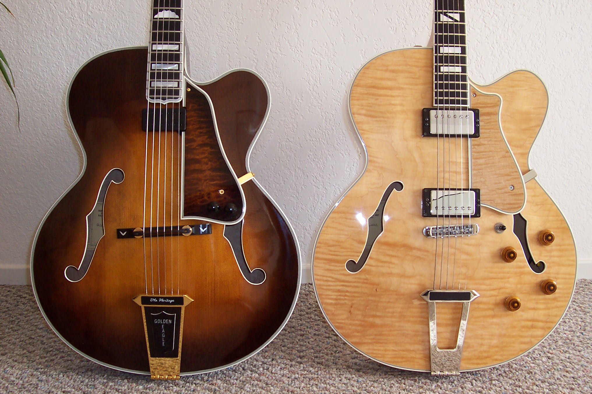

Gitfiddler Posted February 24, 2011 Posted February 24, 2011 Tailrise?? I've never heard of such a condition except in poopy farm animals. Seriously, I think he is not familiar with how relatively flat the 550 top is comared to other archtops. It is a laminate top, so there is less of an arch over the midsection of the top. There appears to be a very slight rise near the tail piece. It looks odd but is very normal for a 550. When I first received my used 550 that was what startled me about it. I thought the top was sunken. To the contrary, it was made more flat then arched. I would encourage the new owner to call Heritage and inquire about this so called condition and let them explain how it supposed to look vs. his expectations. If other 550 owners have something different then maybe mine has 'tailrise' also. All I know for sure is that I love it and it plays and sounds great. Finally, for reference purposes, look at the difference between a Golden Eagle's arch and the H550's in the attached photo.
Patrick Posted February 24, 2011 Posted February 24, 2011 Will: While I have never heard of it being referred to a tailrise, what the guy might be talking about is a situation, almost a phenomenon, where the "tail" end of the fret board rises up. It usually occurs at the very end of the fret board where it extends "over the body". The only way to correct it is with a fret job. The tech would need to pull out the frets and shave/plane/sand the finger board flat, then re fret it. If not, the strings will hit the frets at the 20th, 21st frets and die. However, if it was a problem, I would expect that you would have seen it while you were playing . . unless you had the action pretty high . . . then you might not have noticed it.

MartyGrass Posted February 25, 2011 Posted February 25, 2011 Will: While I have never heard of it being referred to a tailrise, what the guy might be talking about is a situation, almost a phenomenon, where the "tail" end of the fret board rises up. It usually occurs at the very end of the fret board where it extends "over the body". The only way to correct it is with a fret job. The tech would need to pull out the frets and shave/plane/sand the finger board flat, then re fret it. If not, the strings will hit the frets at the 20th, 21st frets and die. However, if it was a problem, I would expect that you would have seen it while you were playing . . unless you had the action pretty high . . . then you might not have noticed it. I have seen that before and agree completely with Patrick. That can occur with very well made archtops. If it is slight, it doesn't matter much. More than that requires raising the action. I have never heard of it called tailrise.
Spectrum13 Posted February 25, 2011 Posted February 25, 2011 Note: He posted on TGP! The dip in on the finger board happens to some OLD guitars and depends on how the truss rod was positioned. I looked down the neck of Will's 550 and it was straight and the action was high. That was a couple of months ago and before it made the trip up North. What was interesting on his post was his comment that Heritage HC guitars are prone to tail dive. I kind of think Tim's explaination of how the top is arched explains a lot. Could be the 550 needs a good set up. The new owner was setting the action and might be confused by the way the 550 is built and believes it was a factory QQ problem. I second the call into Ren before it becomes another Heritage dumpin.

GuitArtMan Posted February 26, 2011 Posted February 26, 2011 Will: While I have never heard of it being referred to a tailrise, what the guy might be talking about is a situation, almost a phenomenon, where the "tail" end of the fret board rises up. It usually occurs at the very end of the fret board where it extends "over the body". The only way to correct it is with a fret job. The tech would need to pull out the frets and shave/plane/sand the finger board flat, then re fret it. If not, the strings will hit the frets at the 20th, 21st frets and die. However, if it was a problem, I would expect that you would have seen it while you were playing . . unless you had the action pretty high . . . then you might not have noticed it. Patrick is correct. I had an old Guild 12 string that this had happened too. It's as if the whole angle of the neck with relationship to the body had changed. A truss rod adjustment didn't help as the neck was straight, but where it joined the body the fingerboard appeared to rise - in my case because it did! There are two choices - reset the neck or plane the frets down. I'm not sure which Guild did (probably just plane the frets) but it came back playing fine.
Guest HRB853370 Posted February 26, 2011 Posted February 26, 2011 Patrick is correct. I had an old Guild 12 string that this had happened too. It's as if the whole angle of the neck with relationship to the body had changed. A truss rod adjustment didn't help as the neck was straight, but where it joined the body the fingerboard appeared to rise - in my case because it did! There are two choices - reset the neck or plane the frets down. I'm not sure which Guild did (probably just plane the frets) but it came back playing fine. So wouldn't you agree that it is the prospective buyer's responsibility to assure himself/herself (barring any deception) that the item is exactly what he or she wants? If this was SUCH a HUGE concern to him, why didn't he ask me for closeups of the guitar? When he first asked the question, I replied, "what the heck is tailrise?" All I knew was the guitar looked and played just fine (to me, a nonprofessional player). I keep saying this over and over, but if he had any reservations about whether or not this guitar had a condition he was not going to be able to live with, he should have called me on the phone to discuss it (like I did with the seller of the cherry 535 I bought), OR just don't go through with the transaction if there is the slightest doubt. That sure sounds much safer to me than going through what he and I are going through now, which is a dispute through Pay Pal.
