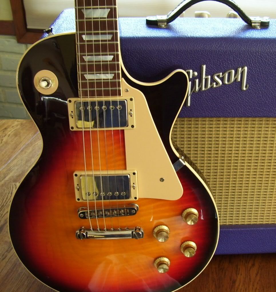

MartyGrass Posted March 11, 2011 Posted March 11, 2011 My recently acquired H170 is on the left. It had 59s put in by Pete Moreno (Heritage luthier extraordinaire) before I bought it. The Goldtop is just as it came from Heritage. The left sided pot controls the volume of the bridge pup on the burst and controls the volume of the neck on the GT. So they are wired in the opposite way concerning the volume pots. I believed the burst was wired incorrectly and took it to Pete today to correct it. I was surprised when he said the left pot (the one closest to the bridge) is supposed to control the bridge pup. He added that many players need it that way for volume swells during their leads, which usually occur with the bridge pup. He was willing to switch the wiring, which is a five minute job. But I thought he made a good point. I do know that I don't want one of each setup, which I now have. That's too confusing. I'm interested in your thoughts on this.

H Posted March 11, 2011 Posted March 11, 2011 I concur: neck top, bridge bottom. That's how it is on a four pot guitar and it makes sense to follow the 'rules'. Unless it's my 150 which I recently realised I have rewired the wrong way round. Doh. Anyone have a diagram for coil-splitting in a three pot guitar? I'm looking at push/pull pots for my 170 to add that single coil spank. Apologies for the thread hijack!

NoNameBand Posted March 11, 2011 Posted March 11, 2011 No offense intended. You're right, it wouldn't matter. I'm just losing my grip on reality. I've reached for the volume knob at that position in LPs since I was a kid and it always controlled the neck pup. It's like waking up in an alternative universe when the knobs are switched. I'll pull myself together. I just need a few moments alone. I disagree, on a Paul, there would be another knob more forward that would be the neck volume. I understand that the (top) line of knobs would be the neck pup but also understand with a Three knob set-up, it makes sense to have the top knob bridge (based on it's position) and the more forward but lower knob neck vol. I also agree based on your your instinct to go with your comfort zone so you're not changing the wrong pup vol. Like a custom mod. I forgot to say, what a beautiful pair of guitars!!!

fxdx99 Posted March 11, 2011 Posted March 11, 2011 Beautiful guitars - know what you mean about goldtops, but that one does look special. I'd be tempted to have the wiring like a 150 with the pot near bridge controlling the neck pickup. 170s just have a toggle where the neck tone control usually is, otherwise seems logical to leave the other '3' pots as wired on a 150 style. Volume swells are difficult on 150 style anyway... or most any guitar outside of a strat (and one of the many reasons to have a strat style in the arsenal...). btw - received the new pots for my 150 to swap out the neck pu vol control which had stopped working up in the '9/10' area - right where you HAVE to have them working. Back in business as of last night - 'bout time!

NoNameBand Posted March 11, 2011 Posted March 11, 2011 Beautiful guitars - know what you mean about goldtops, but that one does look special. I'd be tempted to have the wiring like a 150 with the pot near bridge controlling the neck pickup. 170s just have a toggle where the neck tone control usually is, otherwise seems logical to leave the other '3' pots as wired on a 150 style. Volume swells are difficult on 150 style anyway... or most any guitar outside of a strat (and one of the many reasons to have a strat style in the arsenal...). btw - received the new pots for my 150 to swap out the neck pu vol control which had stopped working up in the '9/10' area - right where you HAVE to have them working. Back in business as of last night - 'bout time! Nice guitar, beautiful burst, where did you get the pickguard?
fxdx99 Posted March 11, 2011 Posted March 11, 2011 Thats the Seth Lovers in the old semi-hollowbody I keep telling everyone about and no one seems to notice. No wax potting on the Seth Lovers, great pups, great tone, no wax potting = feedback. I know, Mark - I've seth lovers in my 535 (love 'em btw), but don't have the feedback problem that Katy describes. Why I'm curious (and suspect a lot of gain into the amp?). Pickguard came with the guitar, which is from Wolfe in '05, then thru golferwave to me. Replaced SD59s in it for Stormy Mondays (Bareknuckles). Yeh, it works okay...
