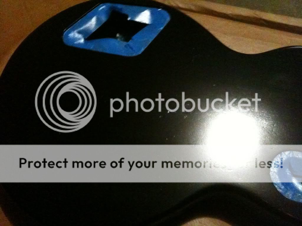

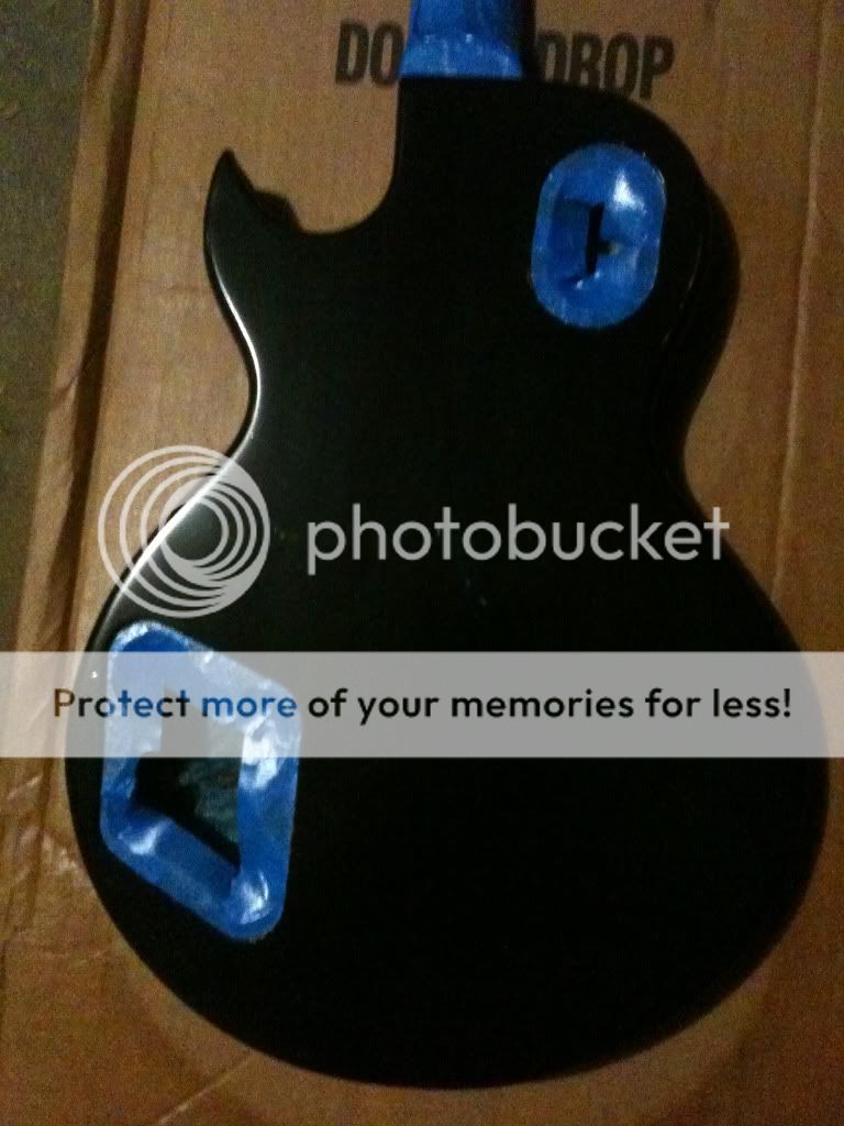

big bob Posted March 17, 2011 Author Posted March 17, 2011 So did you refinish the back? I did not refinish. the old finish is what will stay. but in order to wet sand out the buckle dents I must make the finish thicker while also getting new finish into the divots. So I shot three coats of new clear nitro over the old nitro and also into the old divots, now I will effectively sand most of the new finish off leaving only new finish in the low spots/divots rinse and repeat.. eventually the finish will be smooth and rash free, then I will shoot a coat of new nitro over the whole guitar so the finish will be thick enough for me to buff out. In theory an old Heritage finish with a new shiny top coat. Sorry guys no good pictures, it's hard to shoot a dark back and have anything show up.. I'll get some soon I hope. Here are a couple of shitey cell pics

big bob Posted March 18, 2011 Author Posted March 18, 2011 So I got her sanded down, still a ways to go but overall coming along..
kbp810 Posted March 18, 2011 Posted March 18, 2011 Looking good Big Bob! Nitro is cool stuff in the way it fills and auto levels itself, I bet it turns out great!
