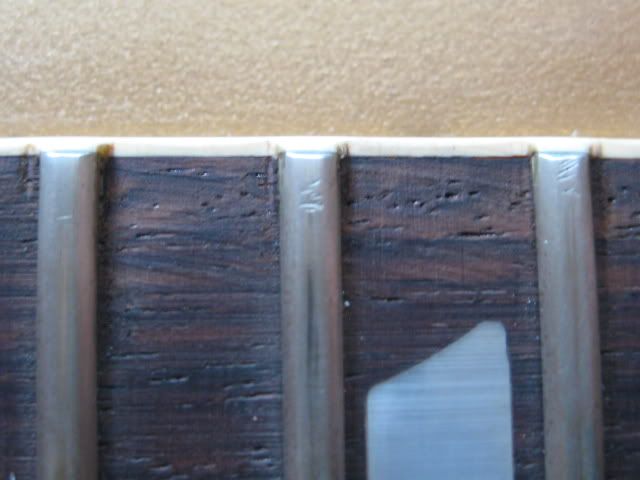

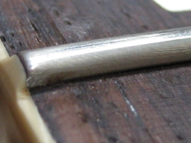

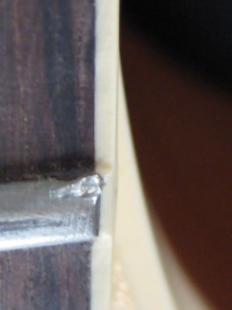

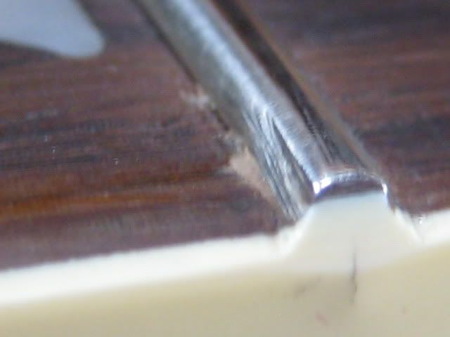

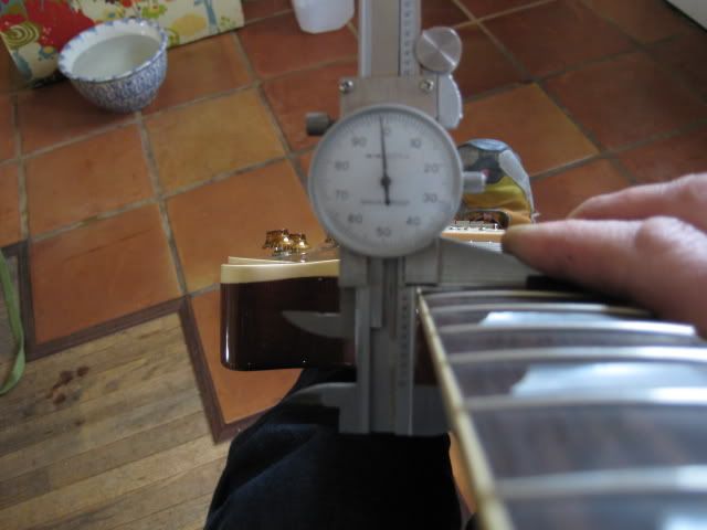

zguitar71 Posted April 2, 2011 Posted April 2, 2011 Here are some Photos of a Heritage factory fret job. tool marks on the 17-19th fret Bigger tool marks on the treble side 10th fret The 17th fret treble side Bass side, leftover piece from the original cutting of the fret Thick neck anyone? 1" at the 12th I do not think that the fret work seen in these pictures would come from Gibson or PRS or any of the small makers out there. The only way to get rid of some of the tool marks on these frets is to replace them, the marks are simply too deep to remove with a file. There is a bulge in the fret board from the 9-17th fret on the treble side and 12-17 on the bass side too. It is all fixable but should not exist on any higher end guitar from the factory. I think Heritage should step up there game a little and get this type of thing right. I understand why some people stay away from Heritage when this type of finish work exist. I am going to level the frets as best as I can for now and then do a refret and board level after the summer. I think I should let it acclimate, the guitar spent its life in the Midwest with high humidity and now is in Montana with summer humidity as low as 5% at times so I am sure it will settle a little.
sheetsofsound Posted April 2, 2011 Author Posted April 2, 2011 wow, that's really bad. None of my 3 were anything like that. The factory fretwork was fine. It was the fingerboard on all 3 that had dips and humps that caused the problem. Here are some Photos of a Heritage factory fret job. tool marks on the 17-19th fret Bigger tool marks on the treble side 10th fret The 17th fret treble side Bass side, leftover piece from the original cutting of the fret Thick neck anyone? 1" at the 12th I do not think that the fret work seen in these pictures would come from Gibson or PRS or any of the small makers out there. The only way to get rid of some of the tool marks on these frets is to replace them, the marks are simply too deep to remove with a file. There is a bulge in the fret board from the 9-17th fret on the treble side and 12-17 on the bass side too. It is all fixable but should not exist on any higher end guitar from the factory. I think Heritage should step up there game a little and get this type of thing right. I understand why some people stay away from Heritage when this type of finish work exist. I am going to level the frets as best as I can for now and then do a refret and board level after the summer. I think I should let it acclimate, the guitar spent its life in the Midwest with high humidity and now is in Montana with summer humidity as low as 5% at times so I am sure it will settle a little.
zguitar71 Posted April 2, 2011 Posted April 2, 2011 Yea it is kind of disgusting. Mostly because I tell people how great Heritage is and then they see that type of work and think I'm crazy. Heritage could make guitars that leave the factory with perfect necks and frets and charge $200-$300 more.Tthey would still be a great deal and not have to have the possibility of a tarnished reputation because of quality control.
sheetsofsound Posted April 2, 2011 Author Posted April 2, 2011 Yea it is kind of disgusting. Mostly because I tell people how great Heritage is and then they see that type of work and think I'm crazy. Heritage could make guitars that leave the factory with perfect necks and frets and charge $200-$300 more.Tthey would still be a great deal and not have to have the possibility of a tarnished reputation because of quality control. I've heard that they're improved now with the new owner. Have you checked out the new instruments? Also, I guess one trick is to buy through jay wolfe who apparently returns any instruments that are not made properly so you can be sure of getting a good one. If you buy used (like I did) you should probably figure on the fret level or refret. I was looking at a used sweet 16 recent and the dealer admitted to me it needed a planing. So, folks can say they're no worse than Gibson but it's just not true. I think they're great guitar and I'm one who believes that an instrument is worth working with to make right but I agree with your sentiment.
DetroitBlues Posted April 2, 2011 Posted April 2, 2011 There is no way that came from the factory like that. Someone exposed the fretboard to moisture and tried to fix it crudely with a file.
