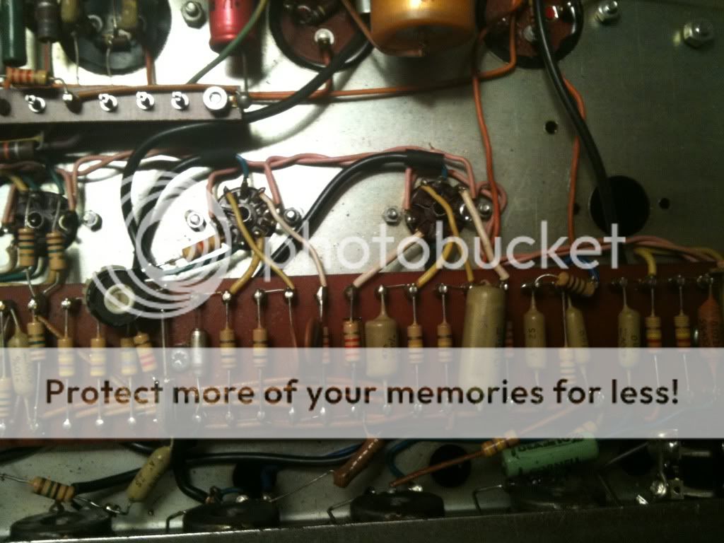

Heres an inside shot of my next amp, or rather the amp that is taking center point of my gaseous state.(its quite bad. Im thinking of selling stuff. Already have buyers lined up)

Looks like something straight out of Petaluma...

I always get a kick out of seeing that!
Yeah, it's good for a chuckle while I'm in there resoldering the tube-socket pins.....
