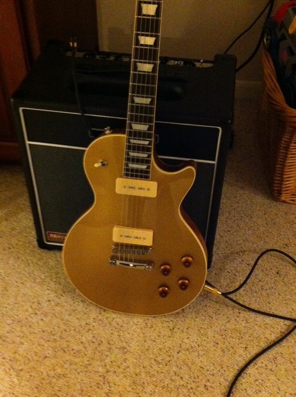

VTGoose Posted April 12, 2011 Author Share Posted April 12, 2011 Thanks for the thoughts. Spoke with my amp guy last night. Looks like I may need two switches. Not a big deal. Fender may be the safest route. I have an email into the guys at Weber and I'll see what they say. Here is a pic of the Goldtop. I will be sure to post some better pics of the guitar with the amp when its done. Indeed yes! (pictures of that H150 Goldtop would be great too ) I realized I referenced the verb and vibrato style switching, but didn't mention channel switching; The basic channel switching method is going to use a 3 conductor "stereo" type jack, where as one contact is channel 1, second contact is channel 2, and the third is a common ground. I'm not sure if there are any production three switch footpedals that will accomplish all three tasks given the two different jack types, you might either need to have something custom made, or just use two seperate pedals. Link to comment Share on other sites More sharing options...
