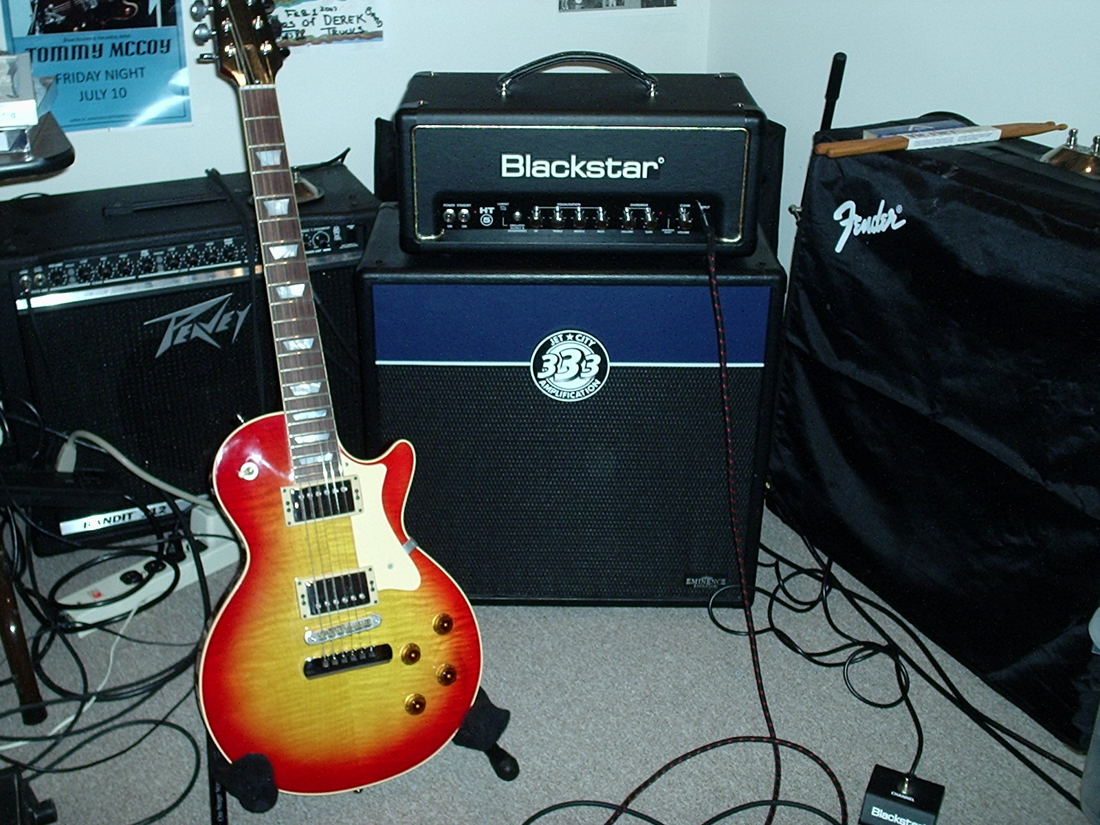

Guest HRB853370 Posted April 13, 2011 Posted April 13, 2011 Thanks -- my main concern is not ending up with a big chunky neck, like Gibson 50s or Epiphone 335 clones. If they are all like the one I played, I'd jump at the right on when it comes around. I figure with a Strat and an H535, I'd have almost any tones I'm interest in covered. Almost! You will soon be longing for an H 150 to get that vintage LP tone! Then, you will have all the bases covered! Welcome!
Guest HRB853370 Posted April 13, 2011 Posted April 13, 2011 Almost! You will soon be longing for an H 150 to get that vintage LP tone! Then, you will have all the bases covered! Welcome! Like this one!

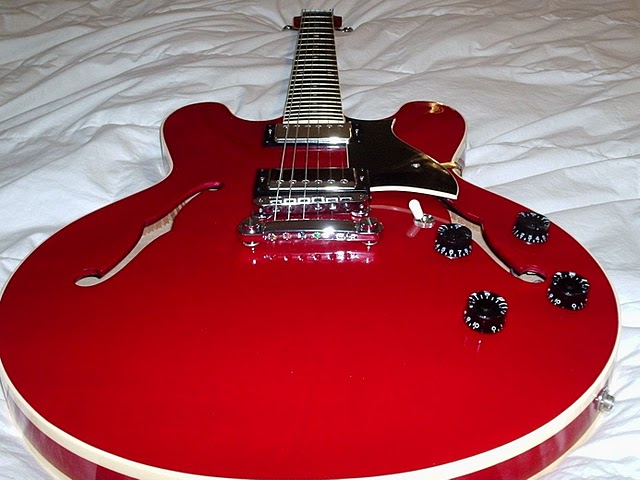

yoslate Posted April 14, 2011 Posted April 14, 2011 and this one........... One of the finest looking 535's...ever!

kidsmoke Posted April 14, 2011 Posted April 14, 2011 One of the finest looking 535's...ever! Agreed! Beautiful. I recently picked up a 9 year old 535 (April 2002 build) and it has a slim-ish neck which felt perfect in my hands, and was the deciding factor. The build quality is peerless. It's one of only two Heritage guitars I've ever held in my hands, so I cannot speak to the consistency issues that you're asking about. Just offering the data for your used guitar search. Good luck, and welcome!
