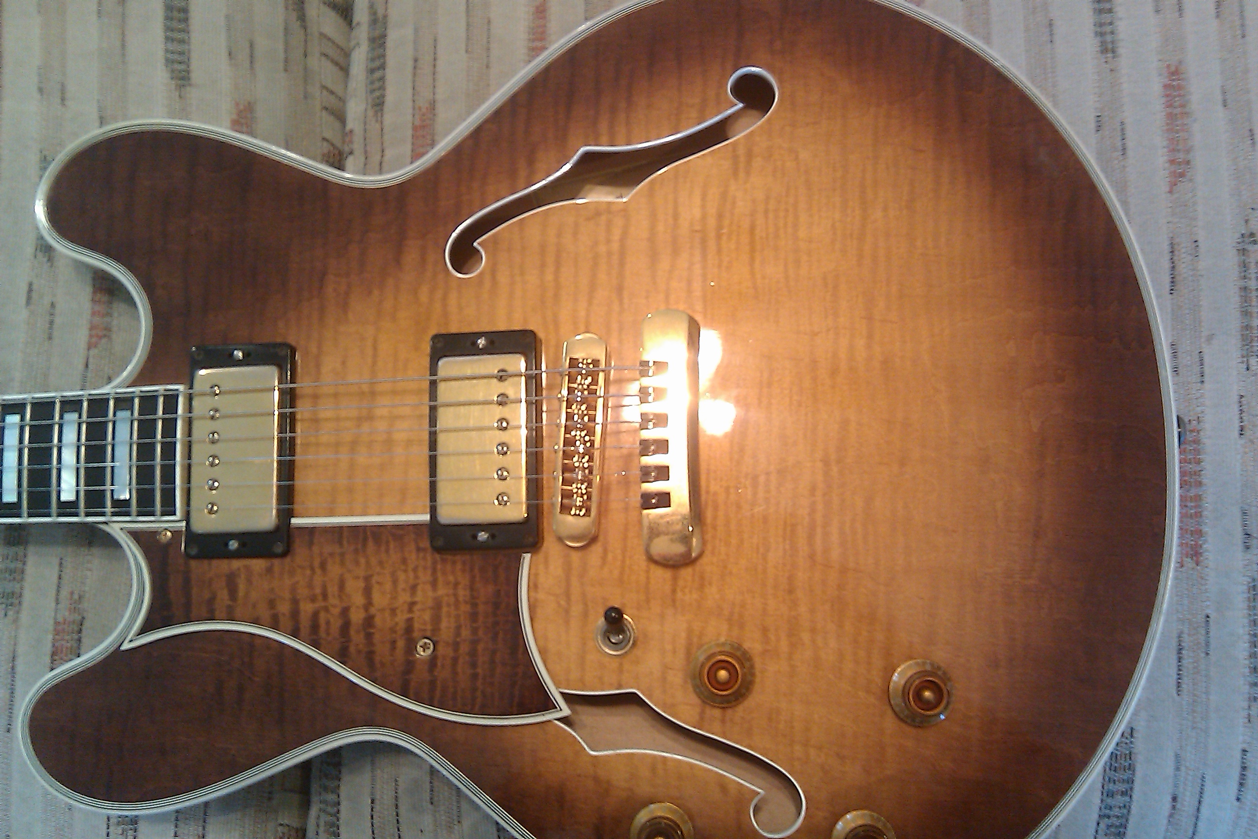

blues24 Posted April 22, 2011 Posted April 22, 2011 I recently bought a 1992 555, it has the Schaller hardware.... Has anyone upgraded Their hardware? I like to get rid of the roller bridge and tail piece.. Any info shared would be great...
