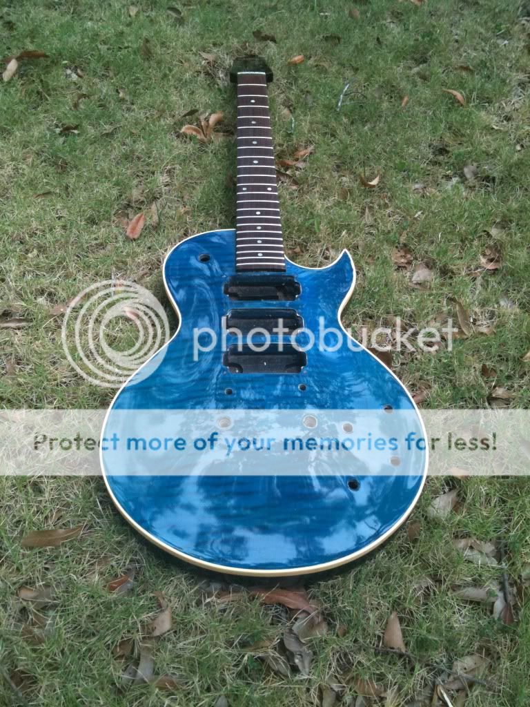

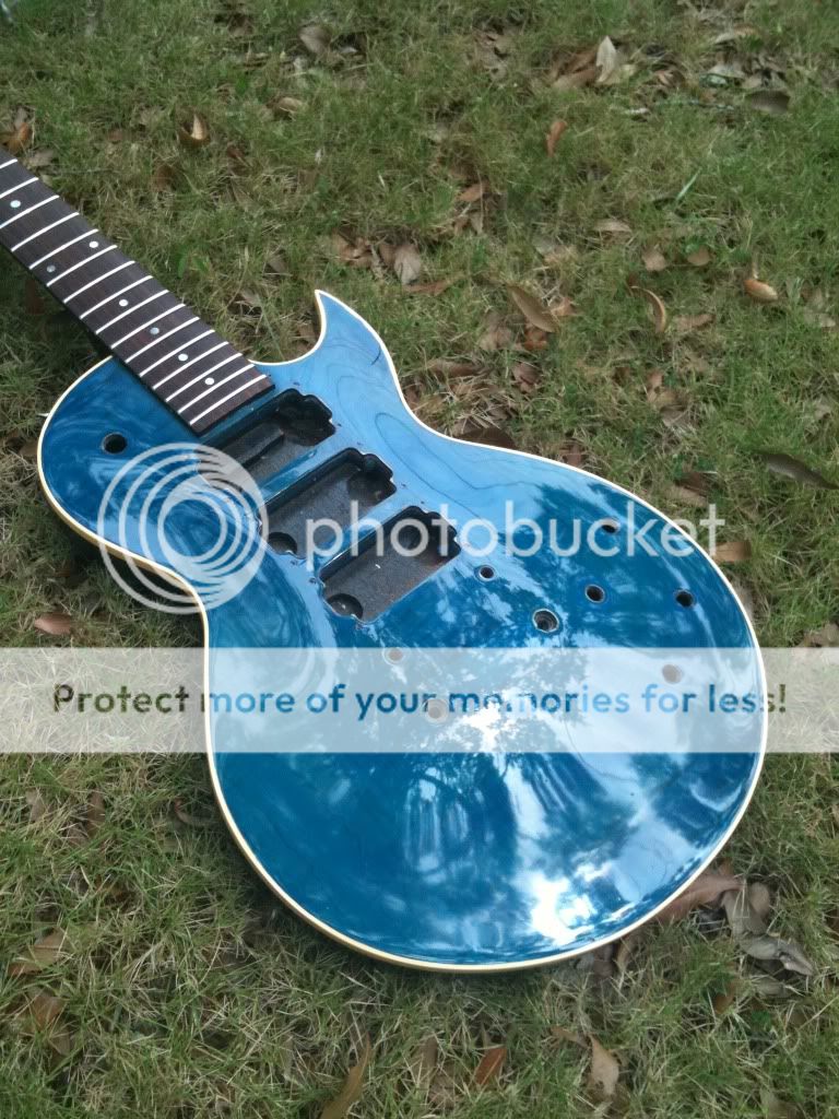

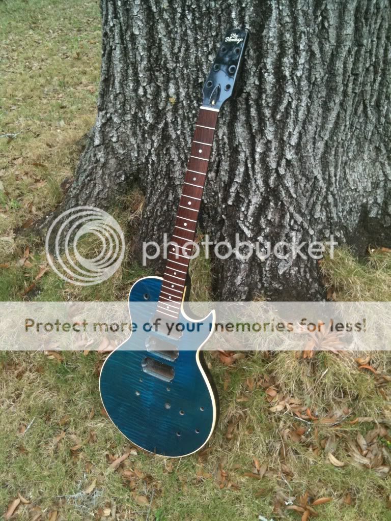

So today I got off my lazy arse and wet sanded the 140 to 2000 then buffed her all out. She came out great..
Oh yea, pics
Yes, that came out GREAT ..!!!!
That finish looks incredible. When this one is put back together it's going to be a killer axe.
Does that work on a headstock vaneer too?
Not sure what the question is? for this guitar I sanded the clear coat off and added a new one in order to get rid of some real bad finish worming/ buckle rash.
Very, very, nice Lance. Professional work there. I am impressed!
That turned out nice!
Everybody into the pool!!!
That guitar looks fine enough to dive right in to the middle; cannon ball :icon_thumright:

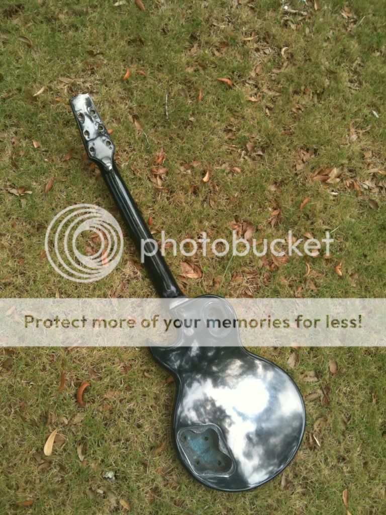

Conorb, I did not start with 140 grit, she is a 140, an H-140 that is, H-code
I started with 600,then went to 800. That pretty much lifted all the clear coat off the guitar. Next step was to shoot six coats of new nitro clear on the guitar. Next wet sand the orange peal of with 1000, then 1500, then 2000. then polishing compound.

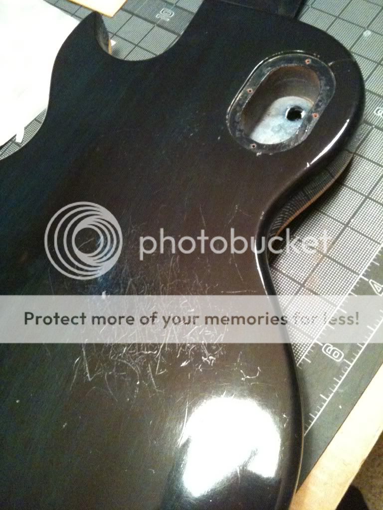

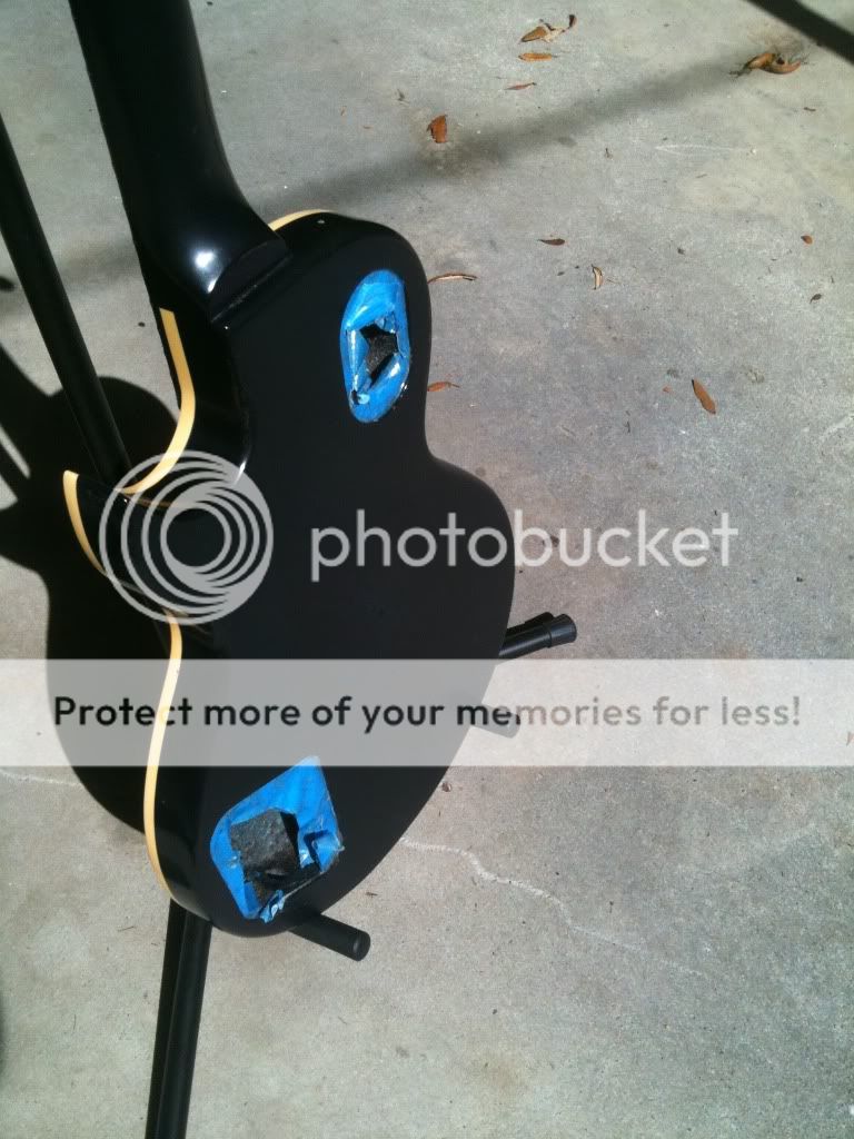

this is how she looked when I started

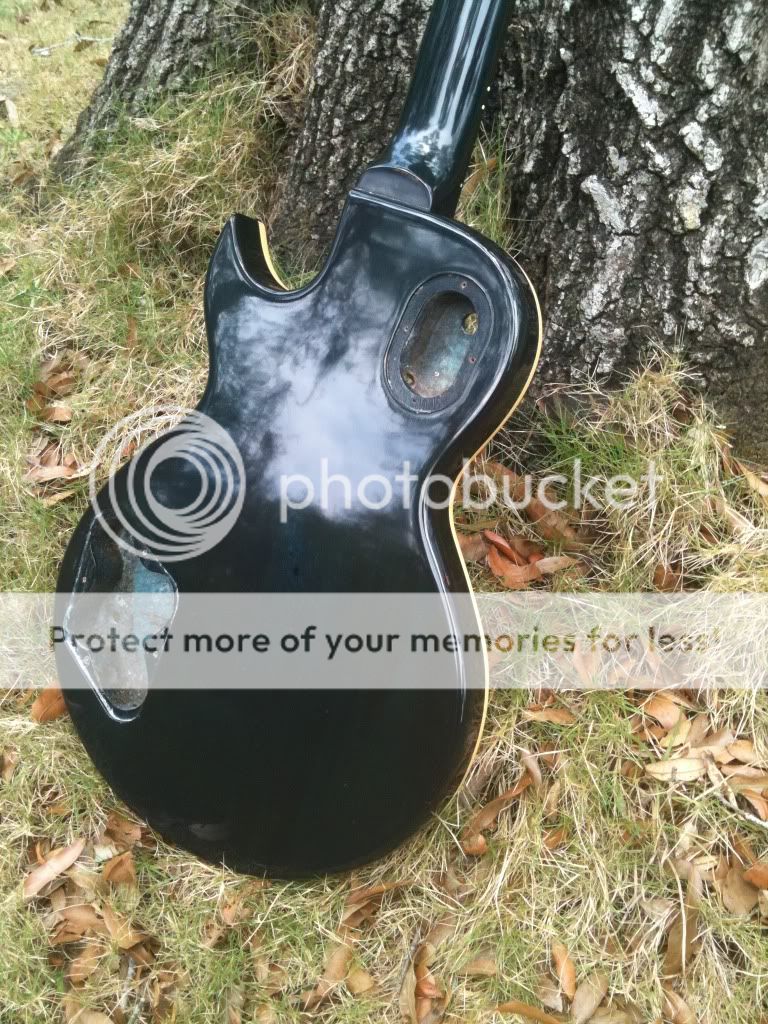

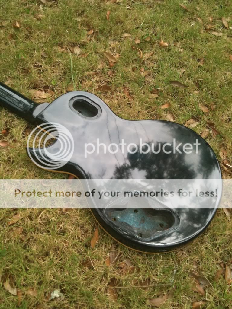

You are doing a great job Lance, its looking very nice indeed. I wouldn't mind trying a restoration project myselfone day.
