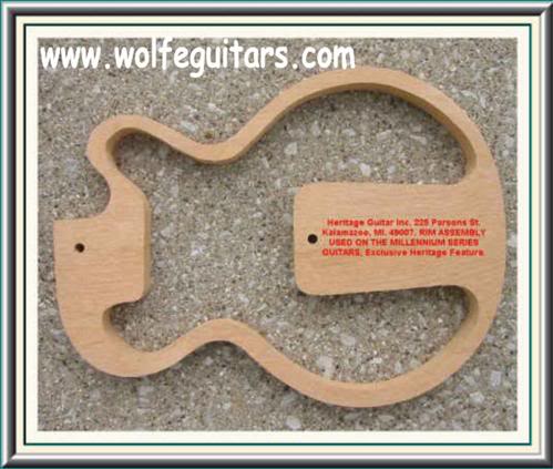

tulk1 Posted June 11, 2011 Posted June 11, 2011 The H110 is listed as both a semi-solid and a solid body, isn't it? The LWs and the Millies, near as we can tell, have this carve inside. Jimbob's diagnosis seems to match.

Jimbob Posted June 12, 2011 Author Posted June 12, 2011 The H110 is listed as both a semi-solid and a solid body, isn't it? The LWs and the Millies, near as we can tell, have this carve inside. Jimbob's diagnosis seems to match. Wow! I hadn't seen that image before. With the exception of the curves in the bout areas, that's very close to the carve of the 110. I don't know if I'd call my sketch a "diagnosis"...LOL....but I was quite curious as to what I had purchased and why it sounds as it does. If anyone were to ask me about a sound comparison between a solid and semi-hollow, I would definitely say that it leans more toward the sound of a solid guitar as opposed to the semi-hollow, but there is just a hint of hollow in it. Hey Blueox, I've probably already said this, but that custom 110 you have is an absolutely gorgeous guitar! I can only imagine that the thinner maple top adds a new dimension to the overall tone, too. Either way, it's great to own one of these fine instruments. I've only had mine for a few days now, but it grows on me more and more with each passing day. And, thanks to everybody for your input! This was truly great fun for me!
tulk1 Posted June 12, 2011 Posted June 12, 2011 Wow! I hadn't seen that image before. With the exception of the curves in the bout areas, that's very close to the carve of the 110. I don't know if I'd call my sketch a "diagnosis"...LOL....but I was quite curious as to what I had purchased and why it sounds as it does. If anyone were to ask me about a sound comparison between a solid and semi-hollow, I would definitely say that it leans more toward the sound of a solid guitar as opposed to the semi-hollow, but there is just a hint of hollow in it. That's how I've been explaining the sound of my Millie DC NFH (no f-holes) since I had it made.
