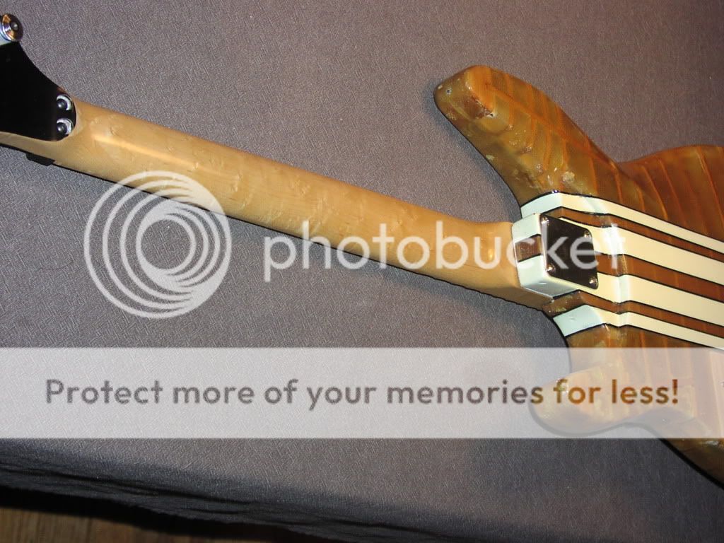

Trouble Posted June 15, 2011 Posted June 15, 2011 I have a neck that I did in true oil (gun stock product) that is just plain fast. you can also clean the neck off with mineral spirits. then a nice polish. It also makes for an attractive finish IMO, especially on maple.
rooster Posted June 15, 2011 Posted June 15, 2011 I rub it down with Micromesh. I start with about 3600 grit and work up to the 12000 grit. Works great. None of my necks are sticky, they're hard as glass. rooster.
DetroitBlues Posted June 15, 2011 Posted June 15, 2011 I have a neck that I did in true oil (gun stock product) that is just plain fast. you can also clean the neck off with mineral spirits. then a nice polish. I want to see the rest of that guitar! There's some unique textures on the back of that thing!
