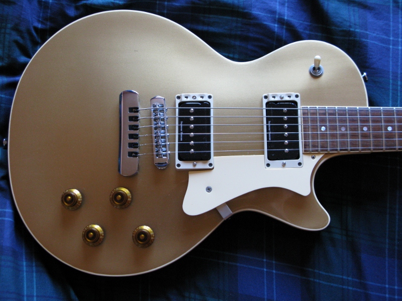

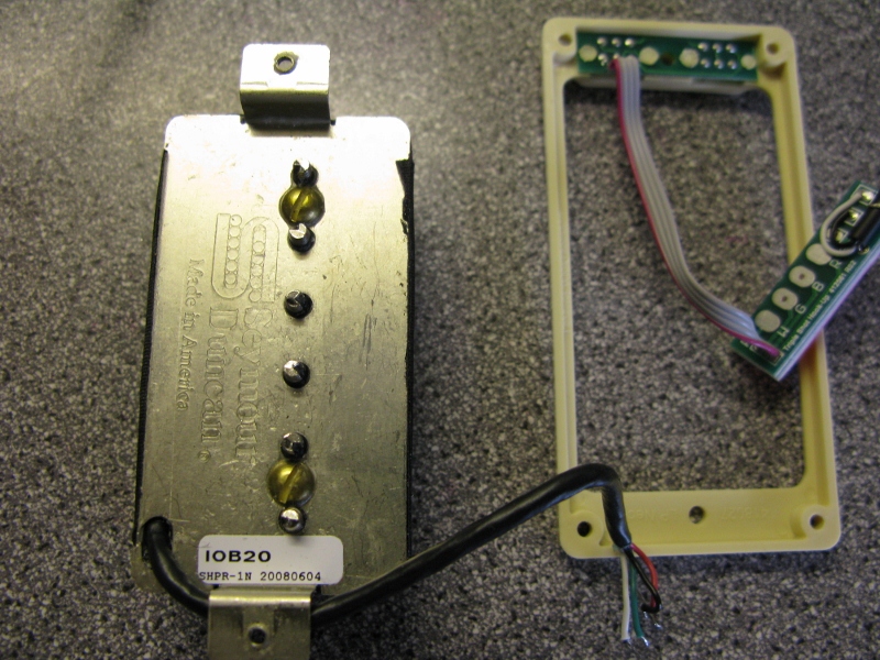

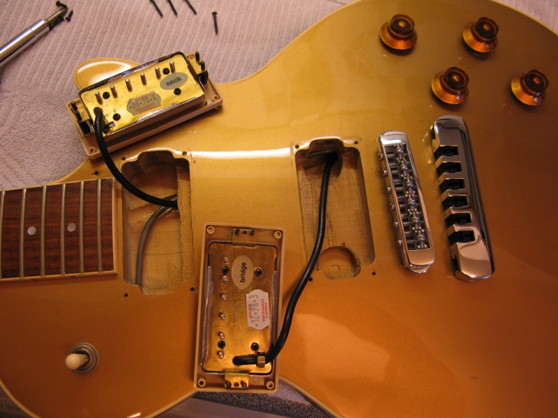

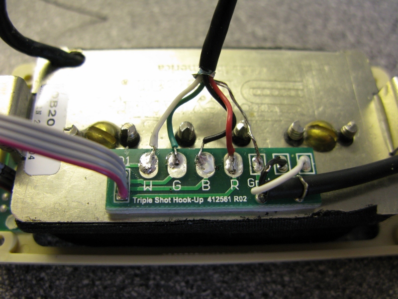

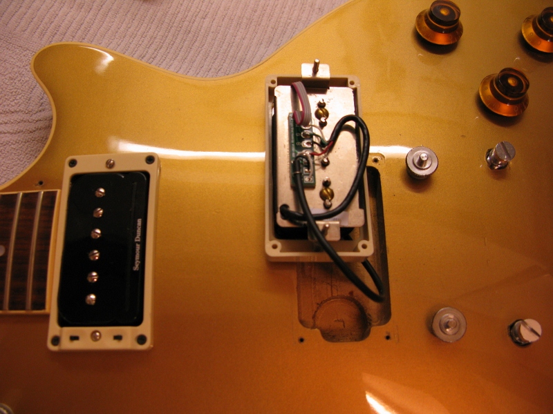

bobmeyrick Posted June 30, 2011 Posted June 30, 2011 When I first bought a set of P-Rails, I installed them in my Edwards LP with push-pull pots to give the four switching options. Then I discovered the Triple-shot mounting rings and bought a set of the flat-mount ones and put the P-Rails into my Godin Freeway. However, the Godin is not a guitar I gig with - the other guitarist in the Pete Donaldson Band (Pete himself)) uses a strat, so I've always used Gibson or more recently Heritage guitars. So, noticing that Hot Rox (my local pedals/tubes/accessories supplier) had a pair of Triple-shots for LP style guitars, I decided to give the 150 Special a makeover! I'd already trimmed the leads from the pickups (pic. 1), so the next job was to mount the pickup in the ring and stick the small circuit board to the bottom of the pickup and solder the leads (pic. 2). Make sure you put the neck pickup in the neck pickup ring! Next remove the old pickups (pic. 3) and replace with the P-Rails (pic. 4). Finally replace the strings - job done! (pic. 5) Plug in and check it all works... A useful feature of the Schaller bridge is that if you slacken the strings sufficiently you can just pop them out and easily replace them when you've finished. The supplied instructions were were clear and straightforward. If you're considering P-Rails, get the Triple-shots as well. By the way, I wasn't worrying too much about the white balance of the pics (hence the variation), I was too busy fitting the pickups!

bobmeyrick Posted June 30, 2011 Author Posted June 30, 2011 I never trim the lead as usually there is some room to leave them in place. I've heard good things about those pups. Hope you enjoy them. Ordinarily I wouldn't trim the leads either, but it's a very tight fit, and if I were to change the pickups (unlikely), the triple-shots would go with them. They are by far the easiest way to get the best from P-Rails.
