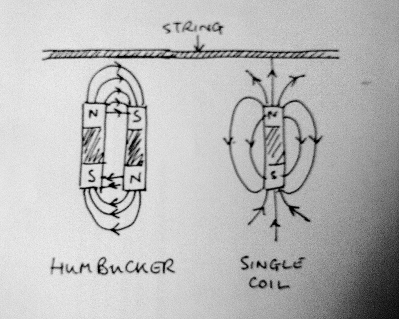

bobmeyrick Posted July 9, 2011 Posted July 9, 2011 On 7/9/2011 at 3:24 AM, DetroitBlues said: Pickups are magnets, humbuckers will pull just as much as a single coil, if not more. Great thing with humbuckers is you can get it rather close using the height adjustment screws, but you can fine tune the height with the screws in the pole pieces. In a single coil pickup, there is only one set of pole pieces, but in a humbucker there are two sets with opposite polarity, so the magnetic force from each set will sort of cancel out. I reckon that the magnetic field (lines of force) from the single coil pickup would be at right-angles to the string and so pull the string towards the pickup. With the humbucker the field would be mainly parallel to the string, resulting in less pull. I've attached a quick sketch (photographed with my phone) which hopefully explains it.
