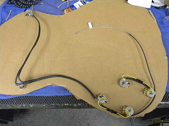

MartyGrass Posted July 24, 2011 Author Posted July 24, 2011 1/8" shim added to the bridge. The heights are fine now. The neck is very slightly louder than the bridge, which is fine. The pup screws can handle any fine tuning. Here's a picture of the RS Guitarworks harness that I should receive in a couple of days.

MartyGrass Posted July 28, 2011 Author Posted July 28, 2011 It's off to Pete Moreno today for the RS Modern harness install. RS is not cheap, but they treated me very well with excellent communication and great attention to technical detail. They were also very fast. I'll report on how it sounds in a week or two.
