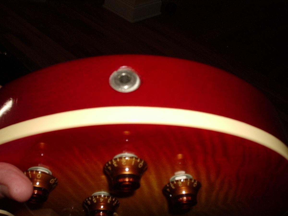

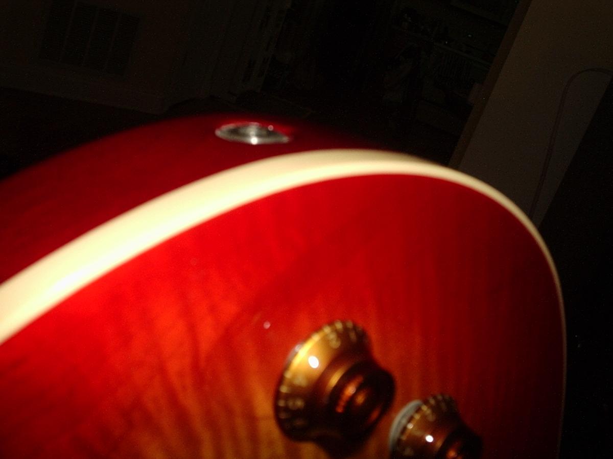

Guest HRB853370 Posted July 29, 2011 Posted July 29, 2011 Mark, the little knurled thumb nut or whatever it is called is so recessed, there is nothing I could grip it with. Even needle nose pliers wont grip it (that is the technique I used on my G&L bass) without damaging the surrounding wood. I should bring it to PSP to show some of you. I can play it-as long as I pull the cable slightly out of the jack so it grips tightly. But that is simply a gerry-rig. This might help
mars_hall Posted July 29, 2011 Posted July 29, 2011 Mark, the little knurled thumb nut or whatever it is called is so recessed, there is nothing I could grip it with. Even needle nose pliers wont grip it (that is the technique I used on my G&L bass) without damaging the surrounding wood. I should bring it to PSP to show some of you. I can play it-as long as I pull the cable slightly out of the jack so it grips tightly. But that is simply a gerry-rig. Are you able to grip the barrel end with needle nose pliers within the cavity and use the small crescent? It shouldn't take a lot of torque to loosen the nut. Heritage had similar tools to install it in the beginning.
H Posted July 29, 2011 Posted July 29, 2011 If you have a old jack plug (or something of the same diameter), you could superglue it inside the jack and then use that to get a grip while you remove and replace it.
Guest HRB853370 Posted July 29, 2011 Posted July 29, 2011 Are you able to grip the barrel end with needle nose pliers within the cavity and use the small crescent? It shouldn't take a lot of torque to loosen the nut. Heritage had similar tools to install it in the beginning. Now I see what you are talking about!
Blunote Posted July 29, 2011 Posted July 29, 2011 Mark has a whole lot more room in the cavity shown than I had. I managed to use a pair of right angled needle nose pliers to get a grip on the nut and loosen it. You probably already know this, but it's best to detach the wires before removing, and attach the leads to the new switch only after installing the nut because there's bound to be some spinning of the whole barrel when you tighten that nut.
mars_hall Posted July 29, 2011 Posted July 29, 2011 Mark has a whole lot more room in the cavity shown than I had. I managed to use a pair of right angled needle nose pliers to get a grip on the nut and loosen it. You probably already know this, but it's best to detach the wires before removing, and attach the leads to the new switch only after installing the nut because there's bound to be some spinning of the whole barrel when you tighten that nut. Yes some can be tighter. The first pic was one I had handy from when I was restoring my 157V. This pic is one I replaced.
