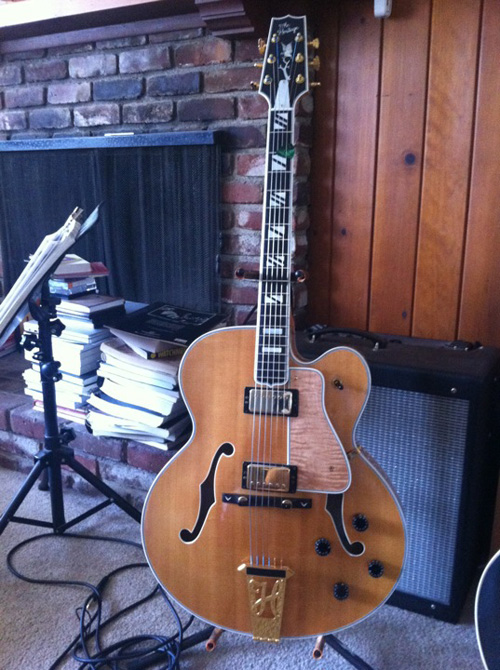

setemupjoe Posted July 25, 2011 Posted July 25, 2011 I recently bought a 2006 Super Eagle to replace my previous guitar, a Gibson Super V, as my day to day workhorse jazz box. One of the things that interested me in the Super Eagle is that the neck was identical to my Super V as both guitars use the Super 400 style neck and inlays. One thing I've noticed is that the string tension on the Super Eagle is markedly less than on my Super V. I use Thomastik George Benson flat wound strings .014-.055 so I'm used to a fairly firm tension with the strings not bending too much but on the Super Eagle they feel much lighter. If I didn't know better I'd swear they were .011's or .012's. Now this is only my perception but I've played many archtops over the years and this guitar definitely feels lighter than any I've played before. Has anyone else had a similar experience or am I just going loopy with this? I find when I want to dig in to the strings like chomping away Freddie Green style or pushing hard on the strings when I'm playing faster lines that the light tension really bothers me. My tech guy suggested changing out the tailpiece for a finger tailpiece which is what I have on my Gibson Super V. That way we can adjust the string tension. Any feedback on this is appreciated.

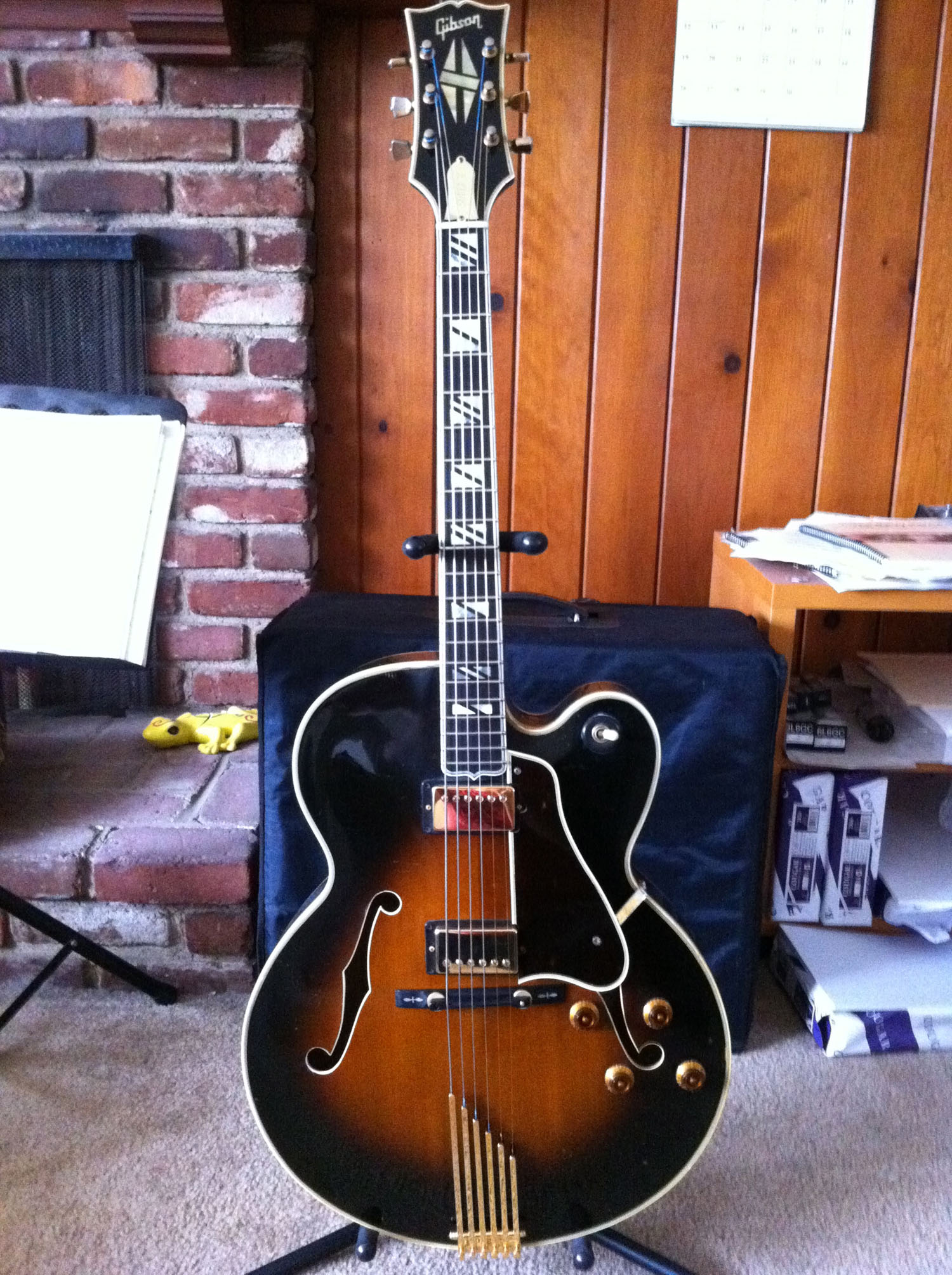

setemupjoe Posted July 25, 2011 Author Posted July 25, 2011 This is my Super V. It's been through hell with me for the last 30 years. It was crushed in the trunk of a cab in Atlantic City, it was stolen from my girlfriend's apartment on the Lower East side in NYC, and it's been played on tour in about 20 countries and counting. Incredible guitar. It just needs to be put into semi-retirement before it runs out of steam.

Steiner Posted July 25, 2011 Posted July 25, 2011 The only guitar I have with the fingered tailpiece has the jack on the treble side of the lower bout. The Golden eagle Heritage shows on their site has a fingered tailpiece and the jack on the lower bout. You could send the tailpiece to Big Bob to be "augmented." He's the kind of guy that's handy with tools Beautiful looking Super you got there! I have one of her smaller cousins with a 17" lower bout; blonde too! You chose well!
