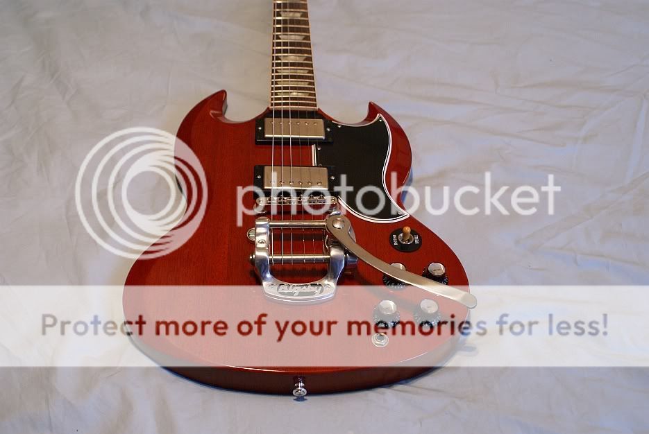

bolero Posted September 27, 2011 Posted September 27, 2011 I had one on an H150, it worked GREAT because of the steep topcarve on a 150/millie, the flat plate looked a bit strange hanging over the bout if you looked sideways, but I got used to it & it functioned 100% fine you could try a B3 but it would be iffy if you had enough stringbreak to hold the strings down on the saddles or you could just go whole hog & bolt a B7 on there here's a pic of my150 when I had the vibramte + B5 installed.....I may get another, currently that's on my 535 & is staying thread link: http://www.heritageo...__fromsearch__1 hope that helps...
rockabilly69 Posted September 28, 2011 Posted September 28, 2011 It seems like there would be better access to the controls with that type of trem! But hell it looks like a robot:) How well does it work????
rooster Posted September 29, 2011 Posted September 29, 2011 It seems like there would be better access to the controls with that type of trem! But hell it looks like a robot:) How well does it work???? Very well. You have to do all the nut tricks that you'd do with any trem, like backfiling the nut slots to minimize the surface drag, and you gotta go to locking tuners (I used Sperzels). However, I can drop the strings till they rattle and pull it right back into tune. It's pretty pricey, but Stets does great work -- fantastic machining. rooster.
