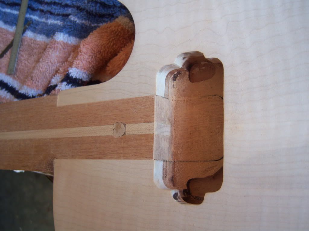

The top shows the neck pocket of a LP Standard. I'm told reflects the current production. The pocket is not hand fitted to the neck like in the old way (lower image). The neck can rock in the pocket, making assembly and neck angle adjustment easier.
When I saw how the Standards are made, it really shocked me. We discuss whether a long tenon matters on the HOC. But how about rocker fit? It looks like there is minimal neck-to-body contact. That can't be good.

I think it was marketing for the historics, I don't think the standards etc really have that much gap in there, it's just a shorter tenon
I pulled this from the LPF from 2007.
I didn't see anyone refute that Standards are made with a "roller method" in the neck pocket.

I'm not sure to what degree that they use the roller tenon,so I can't say about that.
Neck03.jpgBut pics taken from the top look like a short tenon would glue up to be quite strong.swisscheese8je.jpg
It's cutaway pics from the side that show a bit of a gap.

The rocker tenon is a miserable idea for a lot of reasons. Variable neck angle? Have you noticed that the ones with a shallower neck angle feel better?

The rocker tenon was basically made to make fitting the neck faster. I don't know if they still use the rocker tenon, as the partial machine-made Gibson USA models probably don't need them anymore. most of the strength in the neck joints seems to come from the glue on the sides, with the shape tenon that gibson uses. It is narrow and fits into a slot. Other makers like Hamer, PRS, use a much wider tenon, that is also shorter.

Here's a 57 VOS Long tenonpost-2267-0-60464800-1319055431_thumb.jpg See how well it's set and glued.
Now wonder why so many necks on these body styles get broken?post-2267-0-75934500-1319055514_thumb.jpg
