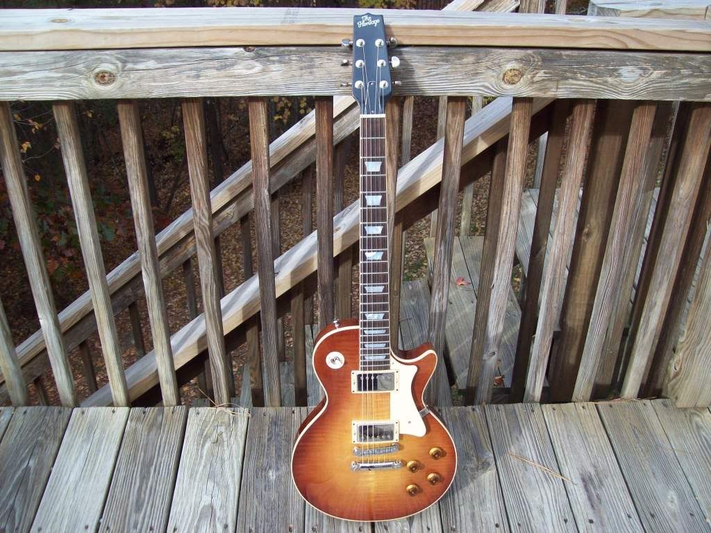

Well, I just picked this guitar on TGP a couple weeks ago and after a few "changes" I'm blown away again by the superior quality of heritage versus "G".
The biggest change done to it was pickups and pots. The last owner had Suhr pickups there and I think they sounded great, just not what I like. So I replaced them with Fralin pure PAF which has become my favorite affordable humbucker and I put the Gibson historic spec CTS pots. This ones are great and actually I prefer them over the RS super pots which are good too but I think this ones recreate the performance and feel of the old centralab pot that I think is a very important part of the Gibsons from the late 50's.
Of course 50's wiring for the versatilty and smooth feel and I'm just amazed!!!
The guitar plays amazing and sounds awesome!!
Here she is:

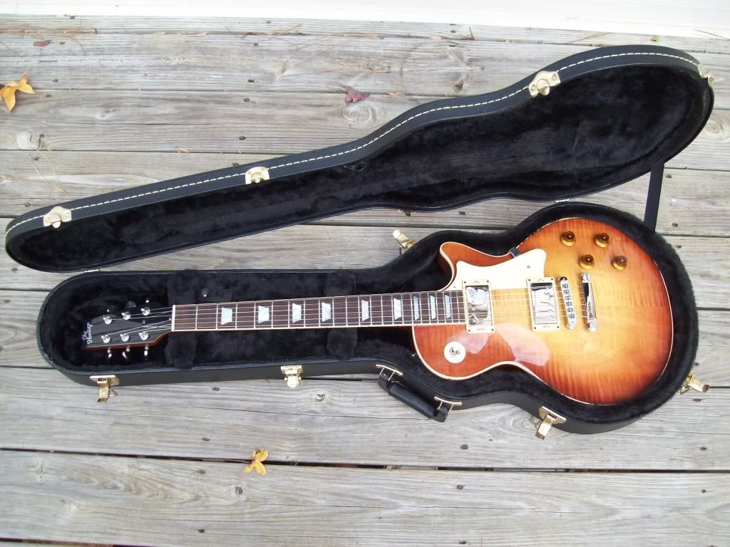

One more pic:
Thats a nice looking H150. About how heavy is a Light weight H150?
I think is like 7.5 versus 9-10 of a solidbody, Not a big diference but it feedbacks easier than my old Les Paul classic and for some reason the Fralin pure PAF's sound better in this guitar than it did on the classic. Maybe is the pots, maybe the woodiness of the chambered, maybe diferent winding on this pickup set compared to the other, who knows...it could be diferent things...

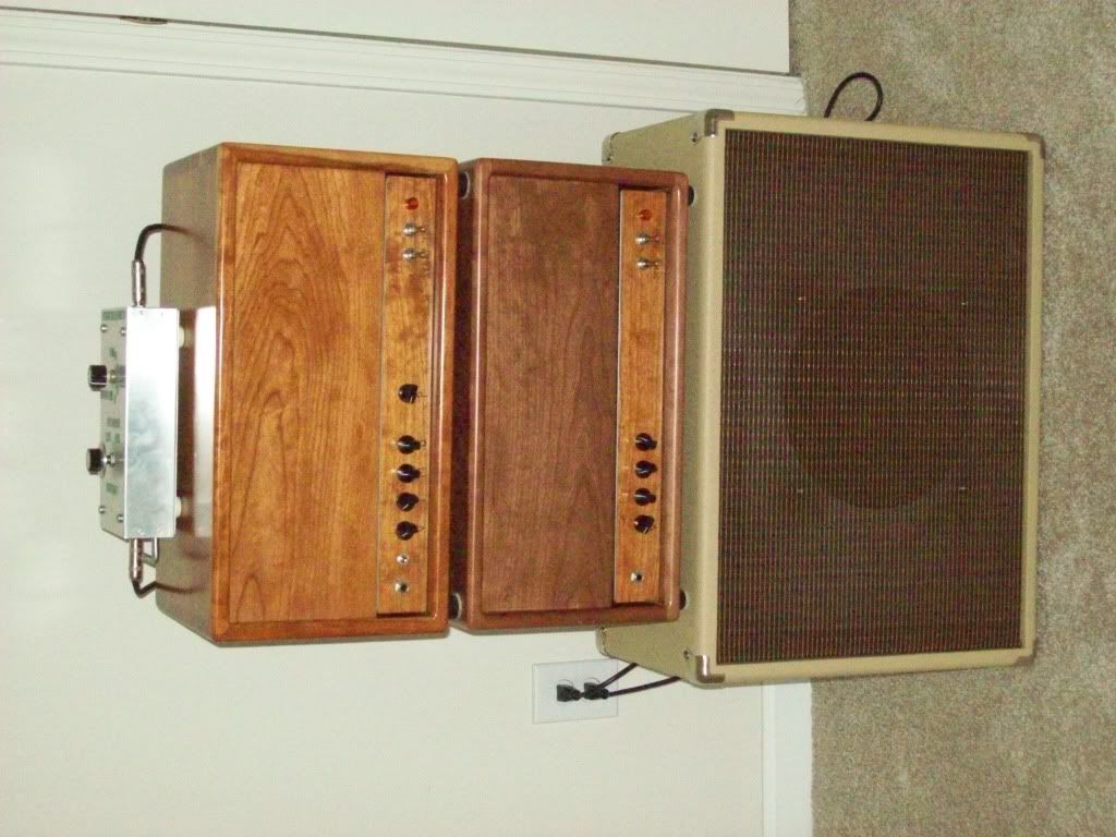

I do it myself, I learned how to use a soldering iron and actually built a couple of trainwreck clones. Is good to have a roomate that is an electronic tech!! ;) he showed me some electronics and to use the iron.
This are my amps by the way, I always use 50's style wiring....

what does the box on the top do?

OK I will try to answer the questions. Bolero, the box on top is an attenuator, basically clone of an airbrake. Slammer, my guitar cables are not 50's style, actually guitar cables are better now when low capacitance cables started being popular (for some aplications). When I talk about vintage and 50's wiring is the way the capacitor between the tone and volume controls on the guitar is wired. Yes you can follow schematic of some pickupmakers. Is also known as 57 wiring. What is more important to get the old feel of the late 50's Gibson guitars is an audio taper potentiometer 500k with a taper like the old style (80:20 ratio). Gibson paid CTS a bunch of money to clone that old centralab pot and is sold now as Gibson historic pot. Those ones are very good.
