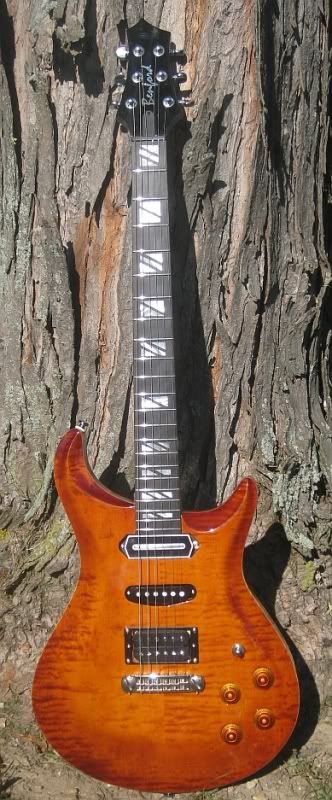

Halowords Posted December 23, 2011 Posted December 23, 2011 I think the Charlie Christian is pretty versatile. Mine is from Vintage Vibe. I think they are cheaper and you can more easily swap the magnets, some have reported they are a bit more P-90'ish than the Lollar version. I really like mine though. It has a very thick/warm/smooth sound to it, like you'd expect, so it is obviously a great choice for Jazz, but it also handles rock pretty well. There's even a video of somebody doing high-gain metal on YouTube with it (although not my first choice). Regardless, it'll probably work fine in anything Heritage makes. I've read a lot of people loving on them in the necks of their Telecasters, semi- and hollow-bodied guitars are obviously more traditional, Lennon used his authentic Charlie Christian in an old LP Jr., there are some people on The Gear Page that have spoken highly of it in a Les Paul or similar style, and mine is sort of a Fender-scale PRS-ish sort of design and I like it quite a bit. So not only is that a bit of a plug for Vintage Vibe's CC-Rider (their version of the Charlie Christian pickup), it's also more-or-less a bit of a nudge to pick whatever guitar you want for the music you play and then add a CC-type pickup. Plus, Vintage Vibe has the traditional shaped CC-Rider, which I think looks really cool, as well as a humbucker-sized (I think Lollar does as well), so it is not like you have to get it shaped differently. That said, I really like everything about the pickup in terms of its sound, and aesthetics (which admittedly come second, but I still think it looks awesome). It does give you options though, particularly if you have a nice guitar that you just want to swap in a humbucker-sized CC-rider, or even one of the Vintage Vibe blade-single coils (they are a Strat-sized CC-Rider, more or less, the main difference being you cannot swap the magnets on those). Anyway, that's all I've got; well almost. If you're interested, here are the options from Vintage Vibe. It might be worth trying one of the SC or humbucker-sized in a guitar before having one custom-routed for the standard Charlie Christian shape. I love mine, and I honestly think you will be fine with them, however it was a kind of exciting leap of faith since it was a new spec'd guitar with pickups I had never tried before in anything done in a shape non-conducive to any other style of pickup ever fitting in there. I love it though and do highly recommend it, above caveats aside. CC-Rider: http://www.vintagevibeguitars.com/windows/sc_ccWin.html Humbucker-sized Blade pickups: http://www.vintagevibeguitars.com/windows/hum_bladeWin.html Standard sized single-coil Blade Pickups: http://www.vintagevibeguitars.com/windows/blade_poleWin.html Best of luck.
