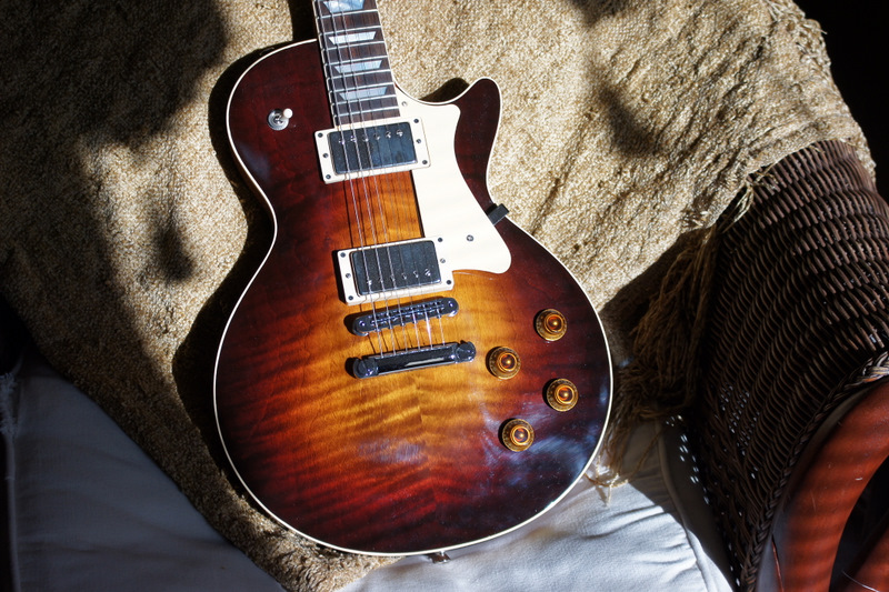

Guest HRB853370 Posted December 31, 2011 Posted December 31, 2011 I was playing the Millie a few moments ago-and when I switched to the bridge pup, the volume dropped drastically. I checked the volume pot and it was all the way up. I fiddled with the switch, from the middle position back to the bridge position a couple of times, and it finally got louder; where it should have been. Upon doing this, I noticed a slight crackle sound when moving the switch back and forth ever so slightly (not actually switching it between positions). Would a shot of electronic contact cleaner fix this? And if so, I am gravely concerned about overspray on the finish. As you know, the Millie has no cavity cover on the bottom of the guitar for the switch like the 150 does.
bolero Posted December 31, 2011 Posted December 31, 2011 could be a loose connection...too bad no access panel, but it's prolly not too hard to get to it, if you pull the neck pup & drop the switch into the body I guess you could try contact cleaner down the shaft of the switch, if you're carefull
mars_hall Posted December 31, 2011 Posted December 31, 2011 If you are suggesting spraying from the outside at the toggle pivot point, I doubt you will get any on the contacts. I wouldn't attempt it in that case. You may be able to tie a string around the head of the toggle and remove the nut, push it in the hole and then spray the contacts. Pull it back out with the string and guide into place with a jewelers screwdriver. Just thinking if it were me.
BobN Posted December 31, 2011 Posted December 31, 2011 I had the same issue on my 555. Loosened up the nut around the switch and spayed a couple of shots of compressed air in around the switch. Problem solved. Sometimes the simplest fixes are the best...Occam's Razor, or something like that.

Gitfiddler Posted December 31, 2011 Posted December 31, 2011 I like the compressed air spray idea best. No possibility of damaging that sweet almond burst finish. Also, flick the switch back n forth several times to work out any loose particulates that may be hangin' about.
