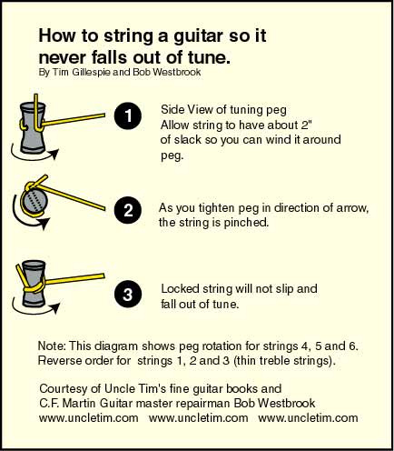

jredbone Posted February 28, 2012 Author Posted February 28, 2012 I know, I know....This is a 2004 535 fresh set-up at the factory, bone nut, new tailpiece, and this is how I string them. Maybe I am not winding the correct amount around the peg? With this method it is supposed to eliminate concern about that but I still wind at least three times around. I dont get any pinching at the nut when tuning so that should be ok I would think. I just dont know where else to look for a solution....
Sven Posted February 28, 2012 Posted February 28, 2012 Maybe I am not winding the correct amount around the peg? With this method it is supposed to eliminate concern about that but I still wind at least three times around. That's too many. 3 times should be max, and then only on the top 2 strings. Also, I never liked that tie-off method. It creates more problems than it solves, and makes it a bitch to remove the strings. T'o be fair, I was taught to do it that way, too. Since, I've learned a better way. I just put the string through the tuner and, with appropriate slack, wind 'em. The first 180 goes on top of the string, the rest go under. 1 1/2 to 2 winds total, with a little more on the high E and B. Also, I put the GHS white graphite lube in the nut slots.
jredbone Posted February 28, 2012 Author Posted February 28, 2012 That's too many. 3 times should be max, and then only on the top 2 strings. Also, I never liked that tie-off method. It creates more problems than it solves, and makes it a bitch to remove the strings. T'o be fair, I was taught to do it that way, too. Since, I've learned a better way. I just put the string through the tuner and, with appropriate slack, wind 'em. The first 180 goes on top of the string, the rest go under. 1 1/2 to 2 winds total, with a little more on the high E and B. Also, I put the GHS white graphite lube in the nut slots. So maybe I am getting a little slip...I will try the straight winding and the graphite lube. I am pretty sure the nut is ok, I dont hear or feel any pinching but I know it can cause a problem if it is.
