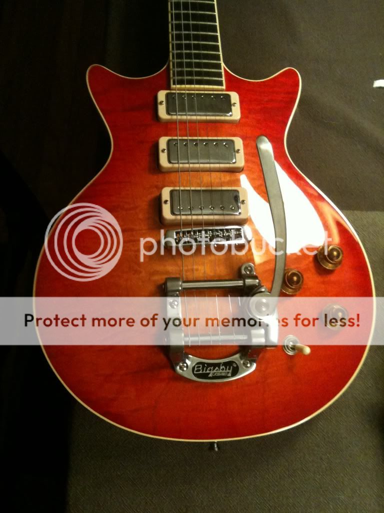

brentrocks Posted February 28, 2012 Posted February 28, 2012 The guy i bought this korina H 137 from installed a bigsby....with locking studs and locking tuners, ITS A WINNER!
