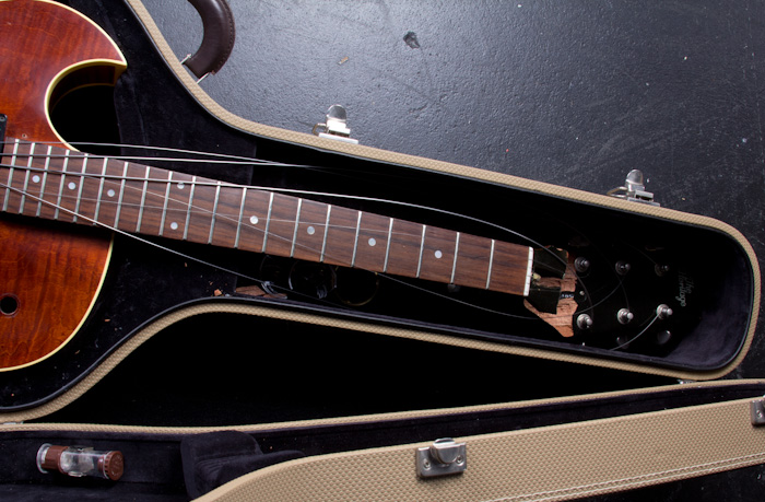

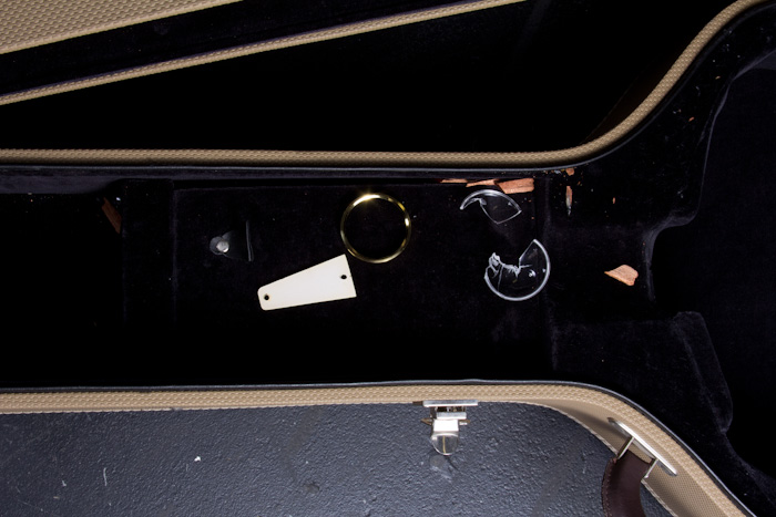

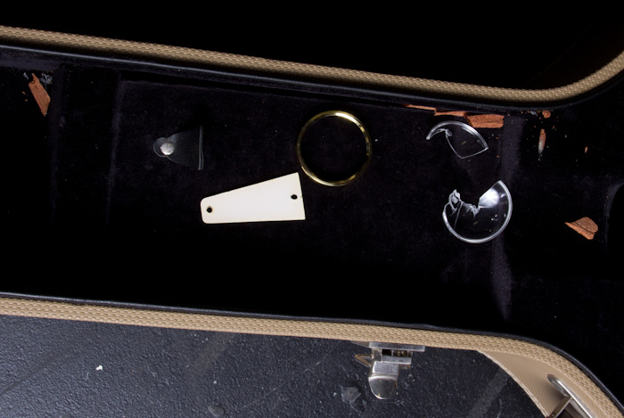

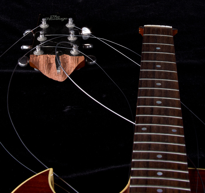

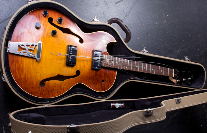

cod65 Posted March 8, 2012 Posted March 8, 2012 Well ,I managed to sell all my guitars and pay some bills, but unfortunately the 575 suffered a complete headstock snap on its way to Vermont. Im making a claim to UPS, but not very hopeful about that, since I skipped insurance. I thought 70$ shipping was already soaking me - a 'false economy'. I really screwed myself . Let this be a lesson to somebody. I packed real well, in a very substantial case, everywhere but behind the headstock. Another wierd thing is that the toggle switch is apparently inside the body. I don't understand how that happened without apparent damage, unless it rattle loose. The packaging and case are apparently undamaged. Now I have to get what's left of it back here to California and not break the top. Im not sure how to proceed. Should I make a claim first ? Any advice much aprec. cod
Jim W Posted March 8, 2012 Posted March 8, 2012 That's a damn shame. On the small bright side, it is a very clean looking break, and there's lots of skilled luthiers that can repair it and blend it in. I would almost lean to working with whoever bought it getting it repaired and you refunding them some agreed upon amount if they would do it.

MartyGrass Posted March 8, 2012 Posted March 8, 2012 I feel your pain. I had an Eagle do this. The case design favors snapping the neck at the headstock when the case is dropped on its back. The high end of the neck is supported almost up to the headstock, and the headstock has no support, especially under it. This can cause decapitation with rapid deceleration. The headstock of Heritage's archtops are heavier than the solid bodies, and the tuning pegs add to the mass. The headstock-neck junction is the vulnerable point. To make things worse, it is customary to loosen the guitar strings before shipping. String tension actually helps prevents this kind of break but would have the opposite effect if the case was dropped on its front. What I do is pack the guitar case tightly with bubble wrap so the headstock cannot move. I would be very surprised if UPS pays you a cent for this tragedy. It's difficult enough to collect when you have insurance. There are a couple of luthiers in the Kalamazoo area who can reneck it. Both are substantially cheaper than a factory job. Still, you're looking at about $600. A headstock repair, if possible, should be a heck of a lot cheaper.

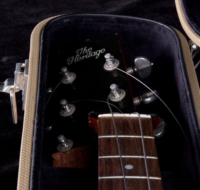

cod65 Posted March 9, 2012 Author Posted March 9, 2012 Somebody take a look inside a real 575 cas and tell me if there isnt the same open-air gap behind the headstock ?

TalismanRich Posted March 9, 2012 Posted March 9, 2012 It almost looks like they stood the box up and let drop straight back. That would be really hard on an unsupported headstock. I can see that happening if someone is pulling a box off a pile and dropping it on to a conveyor. I bought a condenser microphone a while back and when it arrived the whole element was just hanging inside the screen. Luckily the insurance paid enough to cover the loss for the seller.
yoslate Posted March 9, 2012 Posted March 9, 2012 '65, Just showed the pics to my wife, and even she was sympathetic! I'm currently apprenticing to a luthier who's really good at headstock repair. And though I'm certainly no expert, should you decide to fix that one, you might be able to get a good repair there. That's a clean break, with a lot of glue-able surface to work with, though jigging it might prove problematic, from what I can tell of the pictures. I'll show the pics to Tom tomorrow, to see what he thinks, and I'll get back to you, for what that may or may not be worth. Sorry!
