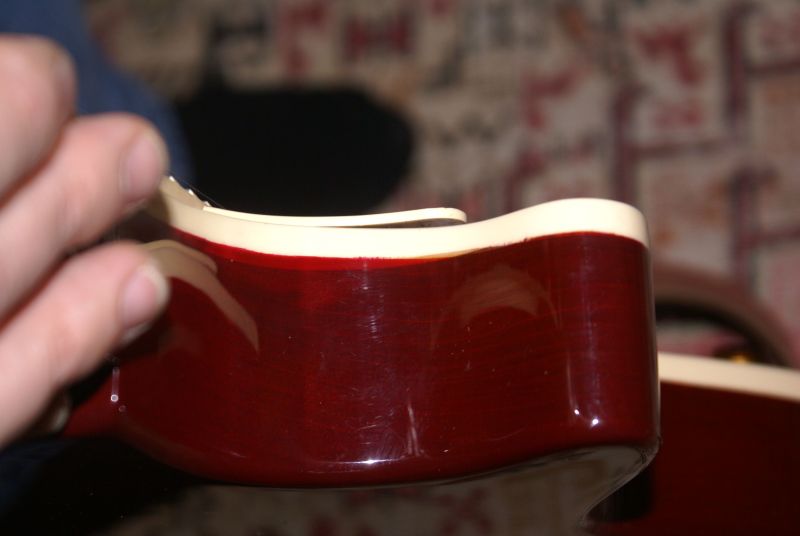

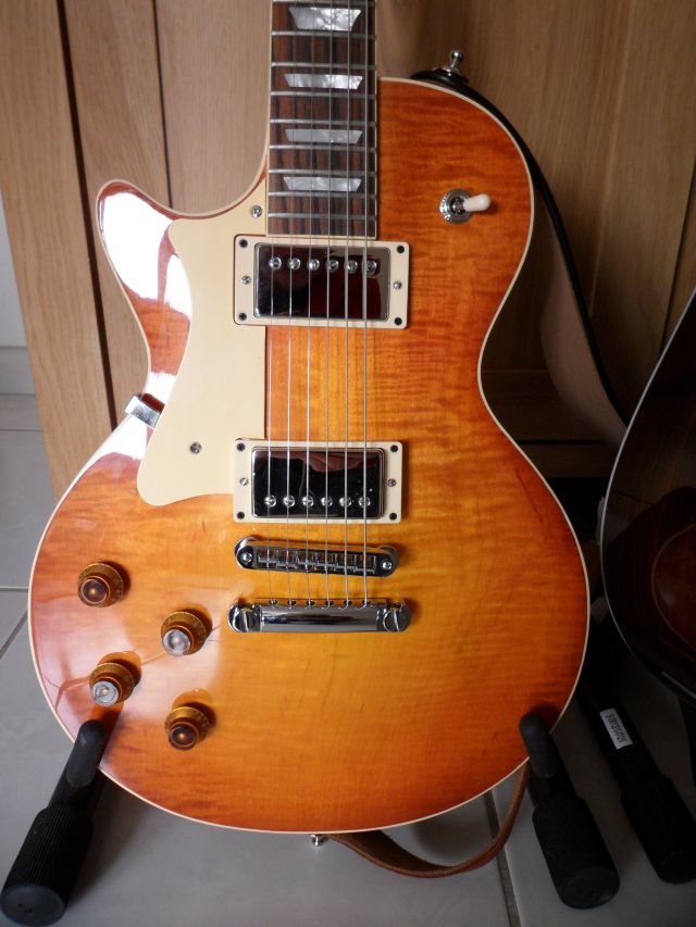

Hodbad Posted March 11, 2012 Posted March 11, 2012 Hi there So first of all I'm left handed, and English living in Switzerland so I just can't pop around the corner to the Heritage dealer to try out a selection of models, I had to trust on a variety of reviews, and buy online from the States. My overall opinion of the guitar is that it is a great instrument both in looks and playability. However there is one minor defect which jumped out at me as soon as I held it, the binding around the cutaway looks scrappy compared to the rest of the body. I'd be interested in your opinions, I'm pretty sure its not upto the standard Heritage normally put out, any ideas what has happended here, almost looks like it was rectified some how, but I'm no expert. One other thing is that I was under the impression (maybe wrongly) that the Ultra came with Gold Plated Hardware, this is obviously Nickel. Is there a definative spec for this model or do the specs change from time to time/. Ive figured out CM stands for Curly Maple but not sure what the Ultra title covers. Anyway its a keeper and not going back over the pond. But would be grateful for your input. Cheers Mark
bolero Posted March 11, 2012 Posted March 11, 2012 first off congratulations that is a beautiful guitar!! the small wood coloured bit there looks like they either masked it too much before spraying, or took too much off with the scraper ( not sure if Heritage masks the binding or just scrapes off the finish with a razor blade after spraying? ) it is normal to have a visible seam there, as the maple cap comes down below the binding in the cutaway so it could be touched up....whether I'd go to the trouble of shipping it all the way back or not, I don't know. but if it is a new guitar the dealer should be prepared to do that, if you so wish!!
tulk1 Posted March 11, 2012 Posted March 11, 2012 I believe Ultra refers to the top wood. Meaning the guitar is guaranteed to have really good flame, movement, etc. in the maple. Don't know if it refers to the hardware or not. Perhaps you didn't get an Ultra. Did you look at the control cavity plate? That has the real ID in it. That's a very nice guitar. But looking at that top, from the pics I'm not convinced it's an Ultra. Sorry. Oh, and welcome to the HoC.
Hodbad Posted March 11, 2012 Author Posted March 11, 2012 Thanks Heir Apparent, I really don't think it's worth the risk of two more Trans Atlantic crossing to repair a cosmetic detail, I,ll look into having it done here if the dealer will cover it.

blueox Posted March 11, 2012 Posted March 11, 2012 " . . . I was under the impression (maybe wrongly) that the Ultra came with Gold Plated Hardware, this is obviously Nickel. Is there a definative spec for this model or do the specs change from time to time/. Ive figured out CM stands for Curly Maple but not sure what the Ultra title covers. Anyway its a keeper and not going back over the pond . . . " "I believe Ultra refers to the top wood. Meaning the guitar is guaranteed to have really good flame, movement, etc. in the maple. Don't know if it refers to the hardware or not. Perhaps you didn't get an Ultra. Did you look at the control cavity plate? That has the real ID in it. That's a very nice guitar. But looking at that top, from the pics I'm not convinced it's an Ultra . . . " The H-150CM-Ultra included an "ultra curly maple top" and "two gold-plated Heritage premium HRW humbucking pickups", as described in the 2005 Heritage catalog. The 2009 and latest (2010) catalogs do not list the H-150 Ultra model. My 2007 H-150 Ultra includes the above features along with all gold-plated hardware. One major reason they haven't been produced is due to the lack of available HRW pickups. One problem is at least a couple of dealers continue to include the Ultra model in their online inventories, even though they are no longer in stock nor are they being made at the factory. Otherwise, you have a great-looking H-150 there, and your dealer should right any problems that you find with it. Welcome to the club!
FredZepp Posted March 11, 2012 Posted March 11, 2012 Welcome to the club. Maybe the Ultra designation has changed a bit over time with customer preferences.. but it would always include premium wood package, I believe. I can't remember if we've seen one with chrome hardware. As to the binding issue... do a google search on" Les Paul binding bleeding" , these kinds of small binding imperfections are common on instruments like this. It was common on the original Les Pauls also. I know that you're looking closely at your new instrument , of course, but I don't really notice that kind of small cosmetic detail too much. But it's hard to tell how noticeable it would be in real life when looking at a photo... It's your guitar, if it really bugs you, contact the dealer and talk about it. BTW, that's a great looking guitar... their VSB finish is simply beautiful.

yoslate Posted March 11, 2012 Posted March 11, 2012 Just piling on here, as I think what needs to be addressed, has been. That's a really nice looking VSB 150! Congrats. These issues are always tough to evaluate from photos. But I think Fred has sent you to the right place, to understand what is happening with the binding in the cutaway. Looks like a combination of the color bleeding into the binding (very common), and perhaps a not-so-good job of scraping the binding, after finishing. A good luthier would likely be able to address that. That lighter moon-like sliver of lighter color is the maple cap of the guitar. That maple takes the finish color differently from the mahogany of the body. Those particular colors, as opposed to, for example, the walnut stain sometimes used, will often (not always) reveal that "aberration" in the finish. Gibson addressed that in the Norlin era Les Pauls by making the binding there wider, to cover that. Brent addresses the real issue, though. How that guitar plays and sounds is what it's all about! Once you get a bit of play wear on that guitar, and you should, if you use it for what it was built for, the issues you raise here won't matter. Enjoy playing that beauty!
MartyGrass Posted March 11, 2012 Posted March 11, 2012 Not an Ultra. You should not have paid more for it than a standard VSB H150. Looks like the binding wasn't scraped meticulously. That happens. Of course it's a beautiful top.

Gitfiddler Posted March 11, 2012 Posted March 11, 2012 That is a very nice 150!! Is that a 1 piece top? It is hard to tell from the pictures. I hope you can work things out with your dealer. Most of all, enjoy that beautiful guitar and play it in good health.
Hodbad Posted March 11, 2012 Author Posted March 11, 2012 Actually hard to tell until you really eyeball it , it is book ended but very good join , and subtle matching of the grains. Final question guys what's a fair retail price for a new H150

Moxnix228 Posted March 12, 2012 Posted March 12, 2012 I just bought a new old stock from a dealer last month. Mine is the same way. To me it's no big deal because it plays and sounds so good. If that is the only flaw I can live with it. Enjoy your new purchase.
GuitArtMan Posted March 12, 2012 Posted March 12, 2012 Wow , 24 posts and nobody has noticed that's the top wood showing underneath the binding in the cutaway. My Les Paul (and I'm sure every Les Paul/H-150 with a maple top) has the same thing. The maple top is a little thicker in the cutaway so the binding doesn't fully cover it and a little shows through underneath. I'm surprised nobody here knew that. Anyway, beautiful guitar - enjoy!
