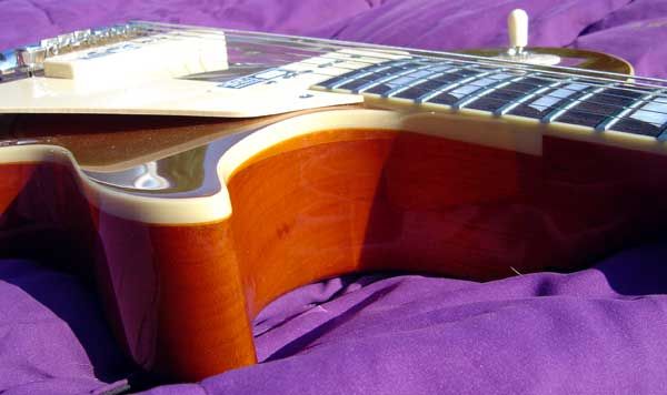

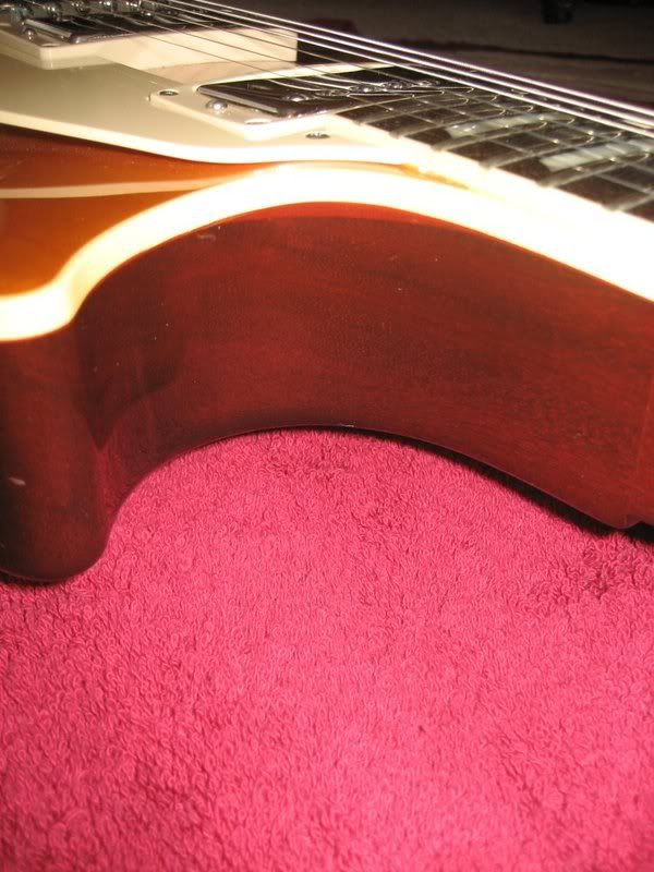

bolero Posted March 12, 2012 Posted March 12, 2012 well, I did say that in the first reply "it is normal to have a visible seam there, as the maple cap comes down below the binding in the cutaway" but there is a sliver of wood ( maple ) where it either got scraped off, or missed during spray...not a huge deal in my opinion, but on a brand new guitar definitely a faux pas & I would talk to the store/mfr
tbonesullivan Posted March 12, 2012 Posted March 12, 2012 Hmm. awesome looking guitar, but I don't think that's an "ultra". Usually those have gold hardware, and possibly upgraded other things. The top looks to be a standard top. I have pretty much the same guitar, right handed in sunsetburst. It does look to be a very nice guitar. Also, as others have said, it looks like someone over taped or over scraped around the binding. I've seen it on guitars before. I've got a bit of it on my Gibson SG SUPREME where the back color meets the top coolor. I wouldn't worry about it, and again, it's just the nature of things being hand made sometimes. I say enjoy it, and play it well! definitely talk to the dealer you got it from about that whole "ultra" thing though. If it's an ULTRA it should say ultra. on the sticker inside the control cavity.
blueox Posted March 12, 2012 Posted March 12, 2012 Basically, H-150CM Ultra=H-150 "with ultra top, gold parts, and HRW pickups" (from 2005 price list). At that time, the HRWs alone were an extra $160.00 each. You should at least get some money back because you didn't get the pickups that you ordered. The Duncans will sound great, but you didn't get what you ordered. The problem is the dealer sold something that doesn't exist anymore. I'm curious about another angle. Check the back of the headstock for the serial number. Look up the letter prefix to see when your guitar was made.

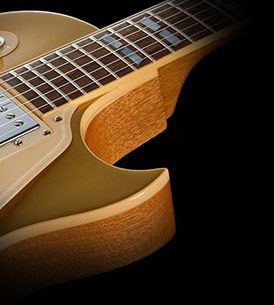

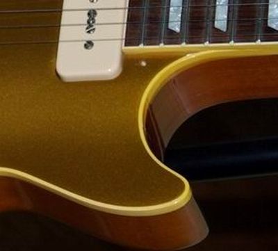

Sven Posted March 12, 2012 Posted March 12, 2012 Wow , 24 posts and nobody has noticed that's the top wood showing underneath the binding in the cutaway. My Les Paul (and I'm sure every Les Paul/H-150 with a maple top) has the same thing. The maple top is a little thicker in the cutaway so the binding doesn't fully cover it and a little shows through underneath. I'm surprised nobody here knew that. Anyway, beautiful guitar - enjoy! I saw it right away...and I did know that, but how could you not know that for a number of years, LPs were made with a wider binding that hid that seam?
FredZepp Posted March 12, 2012 Posted March 12, 2012 oh... I thought we were talking about the finish bleed into the binding and that it isn't a nice clean line at that binding..

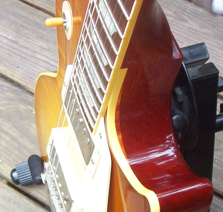

GuitArtMan Posted March 12, 2012 Posted March 12, 2012 I saw it right away...and I did know that, but how could you not know that for a number of years, LPs were made with a wider binding that hid that seam? Just a few examples. It's quite common. Not sure if vintage Les Pauls had this or not, or if it's just the RIs.

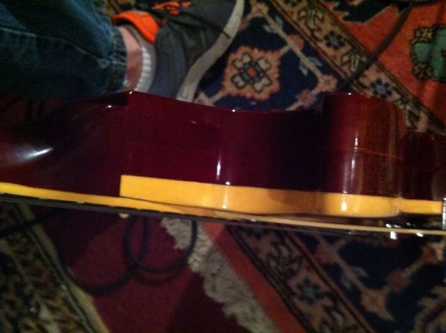

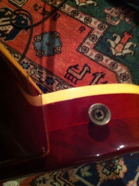

kidsmoke Posted May 8, 2012 Posted May 8, 2012 resurrecting this old thread, just because the build of these guitars is so interesting. Last night in the studio, I spent my fair share of time sitting while others worked, and for most of that time, I played my buddy's '72 Deluxe, unplugged, of course, just noodling. I started to notice the construction, however, and remembered this thread. I let the pictures tell the rest of the story. What's happening here? This seem like a completely different build. Again, this is a Kalamazoo built '72 Lester Deluxe, bone stock. It seems that there are two layers of mahogany, and no visible cap by the neck joint, like the photos in this thread indicate these two photos are just for fun. Sorry the quality is so bad.

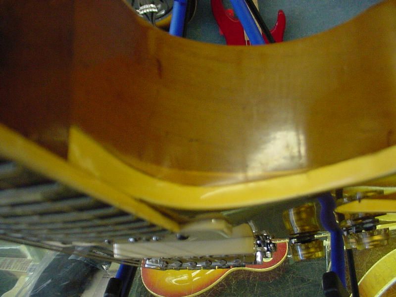

the jayce Posted May 8, 2012 Posted May 8, 2012 Hi there So first of all I'm left handed, and English living in Switzerland so I just can't pop around the corner to the Heritage dealer to try out a selection of models, I had to trust on a variety of reviews, and buy online from the States. My overall opinion of the guitar is that it is a great instrument both in looks and playability. However there is one minor defect which jumped out at me as soon as I held it, the binding around the cutaway looks scrappy compared to the rest of the body. I'd be interested in your opinions, I'm pretty sure its not upto the standard Heritage normally put out, any ideas what has happended here, almost looks like it was rectified some how, but I'm no expert. One other thing is that I was under the impression (maybe wrongly) that the Ultra came with Gold Plated Hardware, this is obviously Nickel. Is there a definative spec for this model or do the specs change from time to time/. Ive figured out CM stands for Curly Maple but not sure what the Ultra title covers. Anyway its a keeper and not going back over the pond. But would be grateful for your input. Cheers Mark I had a 150 ultra in vsb, and it had the same type of attempt at blending from the maple to mahogany, looked pretty similar to what your does. But there should be gold hardware if it's an ultra as well as hrw pickups.
SouthpawGuy Posted May 8, 2012 Posted May 8, 2012 resurrecting this old thread, just because the build of these guitars is so interesting. Last night in the studio, I spent my fair share of time sitting while others worked, and for most of that time, I played my buddy's '72 Deluxe, unplugged, of course, just noodling. I started to notice the construction, however, and remembered this thread. I let the pictures tell the rest of the story. What's happening here? This seem like a completely different build. Again, this is a Kalamazoo built '72 Lester Deluxe, bone stock. It seems that there are two layers of mahogany, and no visible cap by the neck joint, like the photos in this thread indicate these two photos are just for fun. Sorry the quality is so bad. I'm no Gibson expert but that looks like a pancake body, two piece with a three piece top.

tbonesullivan Posted May 14, 2012 Posted May 14, 2012 resurrecting this old thread, just because the build of these guitars is so interesting. Last night in the studio, I spent my fair share of time sitting while others worked, and for most of that time, I played my buddy's '72 Deluxe, unplugged, of course, just noodling. I started to notice the construction, however, and remembered this thread. I let the pictures tell the rest of the story. What's happening here? This seem like a completely different build. Again, this is a Kalamazoo built '72 Lester Deluxe, bone stock. It seems that there are two layers of mahogany, and no visible cap by the neck joint, like the photos in this thread indicate these two photos are just for fun. Sorry the quality is so bad. Looks perfectly normal to me. Les Paul's of that area had a "pancake body" which was too slabs of mahogany glued together. Also, they used thicker binding and were able to cover up all of the top, which has switched back and forth a lot over the years. That is one beautiful guitar. It's very rare to see an original LP deluxe in that condition with the original pickups. Often people bought them and routed them out for full-size humbuckers.

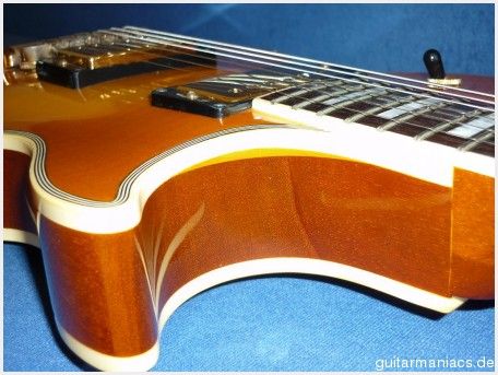

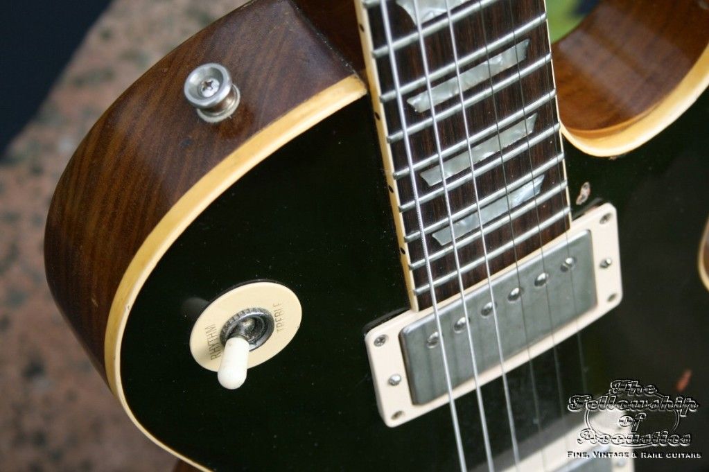

sk8centilli Posted May 17, 2012 Posted May 17, 2012 Are you talking about the odd colored wedge between the binding and the body? If so, that's the maple top peeking through. I'm not sure if Heritage ever attempts to cover this, but Gibson occasionally uses a wider binding in that area to prevent the maple cap from showing. Take a look at my Deluxe for example: Of course, if this is not what you are referring to, then disregard this and accept this woo hoo! instead.
