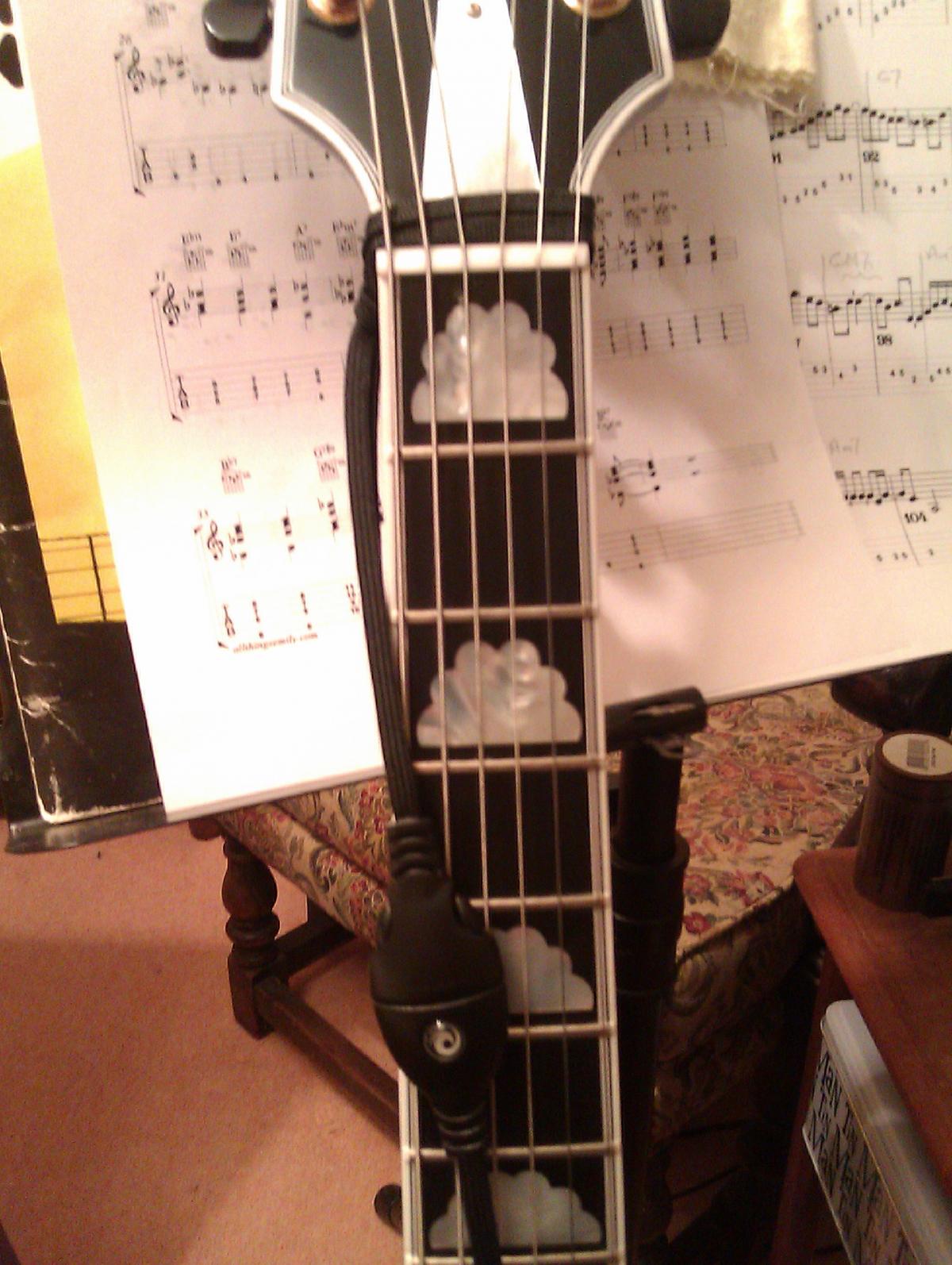

MartyGrass Posted March 12, 2012 Posted March 12, 2012 Interesting thread. For 18" guitars 1 or 2 seems best. A 4 works for smaller ones. No one loops the headstock anymore. Here's one more option.
Teeky Posted March 12, 2012 Author Posted March 12, 2012 No one loops the headstock anymore. Except yours truly
DC Ron Posted March 12, 2012 Posted March 12, 2012 I've been trying to get the "Wes tone" for year. Now I know it's the headstock loop. I don't have an upper strap button on my big body archtops. My belief is if they had been meant to have one, Ren would have put one on.
