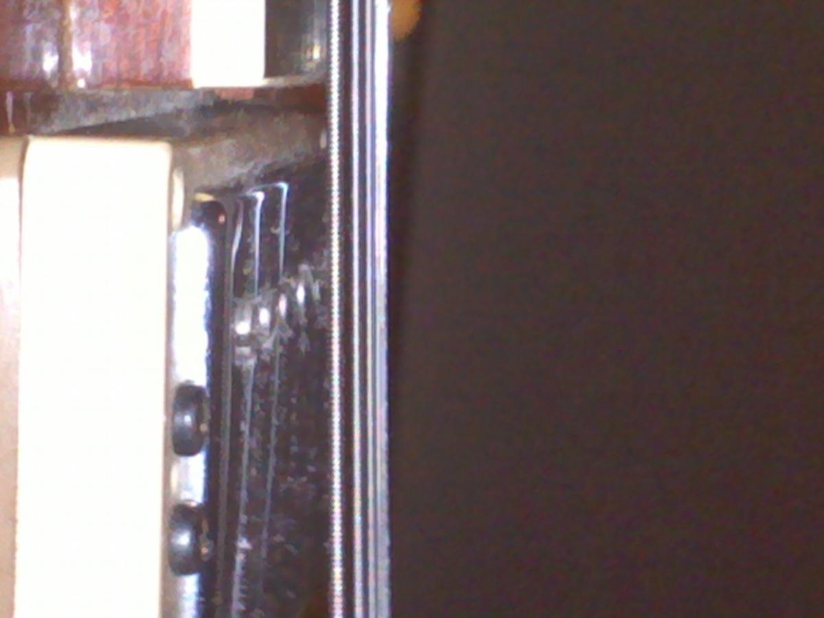

MartyGrass Posted March 26, 2012 Posted March 26, 2012 Ted Greene was one of the best guitarists. He died young and only had one album. I was listening to interviews of him on YouTube yesterday. One of them was on humbucker pickup height. For decades he buried the neck pickup to the same level as the pickup ring. He explained that this maximizes clarity. I have kept the neck pickup low on my Super Eagle. Last night I dropped it further so that it was flush with the ring. The clarity really did improve. The muddy thunking of the 5th and 6th strings disappeared. The HRW will never sound like a PAF. But it sounds as good with a little chiminess thrown in. In case you don't know Ted Greene, please take a moment and listen. He played this on a Tele and used harmonics a lot. If you are busy, at least see the last video. It's a hoot. Ted Greene's version of Clowns. First, here's the recording. http://www.youtube.com/watch?v=AdHD5WBAETM Here it's played in the real world. Funny.

MartyGrass Posted March 27, 2012 Author Posted March 27, 2012 My pickup is even lower. It's about flush. It's a thrill to drop the pickup to that low level because at any time the screw could disengage and the pickup would have to be removed and reinstalled. I'll bet that many won't side with me on this, but I've found that pole piece adjustments make for only subtle changes. I've tinkered with them when either the 6th string is too loud but the 5th isn't or when the transitions strings between wound and unwound have uneven volume.

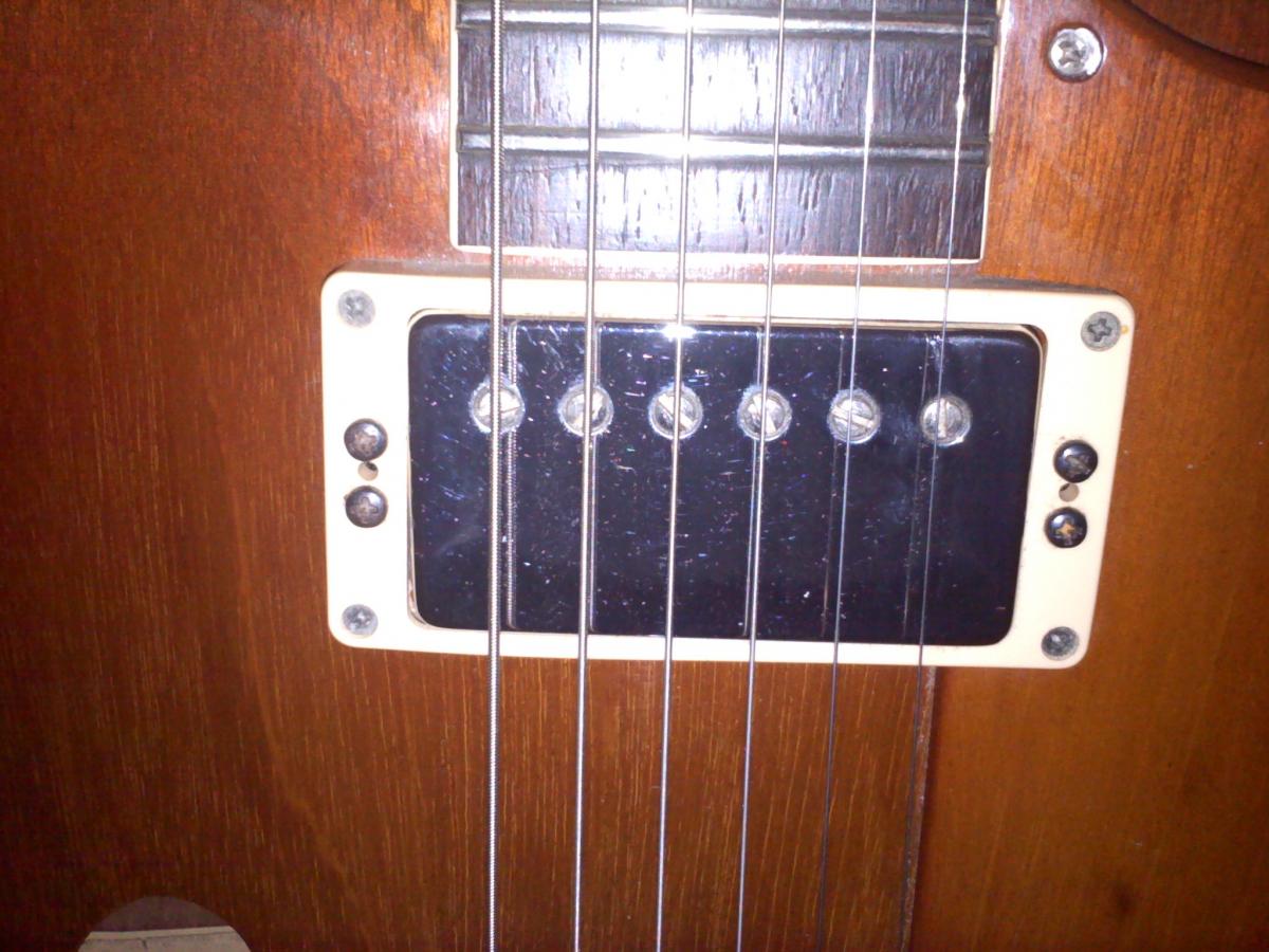

SouthpawGuy Posted March 27, 2012 Posted March 27, 2012 I've also found that with HRWs on two of my Heritage guitars, none are arch tops though, the pickups are screwed right down into the pickup rings. Visible on this shot of the VIP2 ( about as far from an arch top as is possible ) .
MartyGrass Posted March 27, 2012 Author Posted March 27, 2012 Flush with the pickup cover.... As good a place as any.
MartyGrass Posted March 27, 2012 Author Posted March 27, 2012 I've also found that with HRWs on two of my Heritage guitars, none are arch tops though, the pickups are screwed right down into the pickup rings. Visible on this shot of the VIP2 ( about as far from an arch top as is possible ) . Looks like mine! How did this affect your tone?
SouthpawGuy Posted March 27, 2012 Posted March 27, 2012 Looks like mine! How did this affect your tone? It wasn't so much about the tone as the output level. I found the HRWs were overdriving the JC120 setting on a Cube 30x, couldn't get a clean tone without harsh clipping so I dropped them way down, and also did the same on the Millie.
