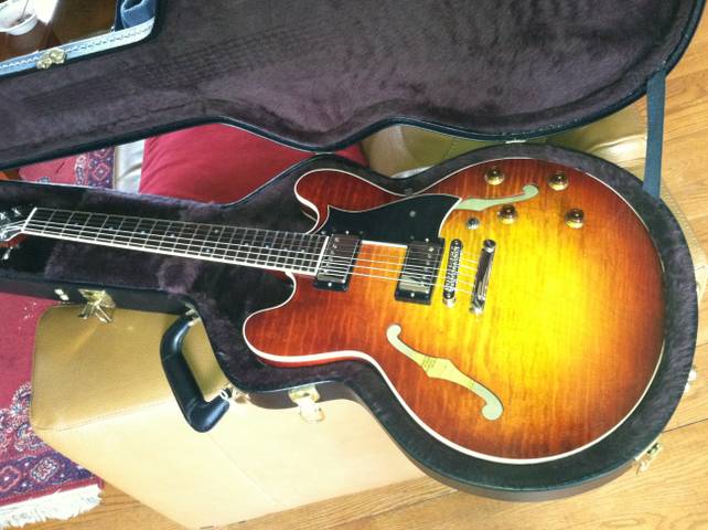

PAdaytonaman Posted April 1, 2012 Author Posted April 1, 2012 heres a shot of the gee tar. She's a beauty.
FredZepp Posted April 1, 2012 Posted April 1, 2012 heres a shot of the gee tar. She's a beauty. Awesome !!
