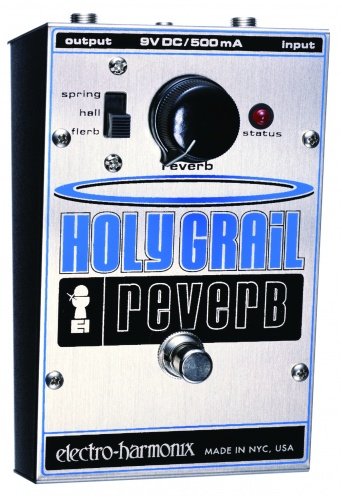

Gitfiddler Posted April 21, 2012 Posted April 21, 2012 My original issue Electro Harmonix Holy Grail Reverb pedal sounds fantastic. The only drawback is that it does not use batteries and needs to be connected to a 9vDC/500mA power supply. I bought it used and the seller did not have the EH original power supply. OK, so I connect it to my Visual Sound 9v/500mA plugs along with a few other pedal friends and we're good to go. I just noticed that the Holy Grail stays a little warm, even when not turned on. No other pedal feels warm to the touch, even when on. Is this a problem? Fire hazard? Normal? Visual Sound hook-up not compatable?
yoslate Posted April 21, 2012 Posted April 21, 2012 Had one for a while, Tim. Mine did the same thing. Never caused a problem. They sound great, don't they!

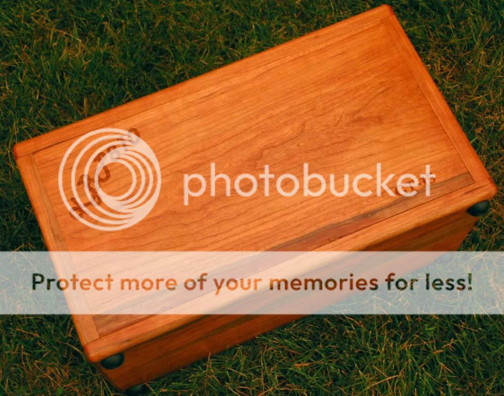

kbp810 Posted April 22, 2012 Posted April 22, 2012 Steiner~ That KBP Reverb looks HOT!! It doesn't take batteries either
Steiner Posted April 22, 2012 Posted April 22, 2012 Steiner~ That KBP Reverb looks HOT!! Real tube driven reverb pan, handmade in the United States! Lovely, luscious tone. If you wish, Detroit Blues and / or I can hook you up with the builder. I cannot survive long without a splash of reverb while practicing
DetroitBlues Posted April 24, 2012 Posted April 24, 2012 I'm surprised you can use the One Spot. The Holy Grail's polarity is backwards from most other pedals.....
Gitfiddler Posted April 24, 2012 Author Posted April 24, 2012 I'm surprised you can use the One Spot. The Holy Grail's polarity is backwards from most other pedals..... That might explain the additional 60 cycle hum I'm hearing. I need to see if one of my many orphaned wall warts fits the Grail. If not, I'll check Fleabay for the specific plug for it.
smurph1 Posted April 25, 2012 Posted April 25, 2012 That might explain the additional 60 cycle hum I'm hearing. I need to see if one of my many orphaned wall warts fits the Grail. If not, I'll check Fleabay for the specific plug for it. Be careful about orphaned wall warts.. you can destroy a perfectly good pedal if you're not careful..!!
DetroitBlues Posted April 25, 2012 Posted April 25, 2012 Be careful about orphaned wall warts.. you can destroy a perfectly good pedal if you're not careful..!! +1 I'd suggest finding the proper power supply for it...
