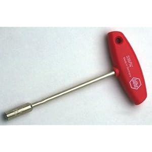

koula901 Posted May 30, 2012 Author Posted May 30, 2012 is this what I need to adjust the truss rod? A 5/16" hex wrench, for my 150? They have them at stew mac. Since I don't have this tool right now, I'll just loosen the strings for a few days and see if the neck moves. There was no buzzing, just sharp, and all of a sudden, the action got too low.

tulk1 Posted May 30, 2012 Posted May 30, 2012 is this what I need to adjust the truss rod? A 5/16" hex wrench, for my 150? They have them at stew mac. Since I don't have this tool right now, I'll just loosen the strings for a few days and see if the neck moves. There was no buzzing, just sharp, and all of a sudden, the action got too low. I haven't had to adjust any of my guitars lately. But .. doesn't Heritage use an Allen wrench?
koula901 Posted May 30, 2012 Author Posted May 30, 2012 No, there's a nut inside, that needs a hex wrench. I believe you use allen wrenches for strats and teles.

koula901 Posted May 30, 2012 Author Posted May 30, 2012 yes, indeed. or, this: But, actually, what's cool about the one you posted, Bird, is there's a phillips screw driver on one end.

High Flying Bird Posted May 30, 2012 Posted May 30, 2012 .... But, actually, what's cool about the one you posted, Bird, is there's a phillips screw driver on one end. Dat's why I'm the brains of dis' operation........ I had one in my 357 case when it came from the factory. I need to order one for each of my guitars.
H Posted May 30, 2012 Posted May 30, 2012 HFB's pic and yours of the T-bar wrench are the right types to use. With these, it's easy to see how much of a turn you have applied. The socket needs to be a 'thin wall' type as there's not much clearance at the sides of the hex nut.

DC Ron Posted May 30, 2012 Posted May 30, 2012 yes, indeed. or, this: But, actually, what's cool about the one you posted, Bird, is there's a phillips screw driver on one end. I prefer this style as you don't have to worry about clearance between the strings. Actually, I use a standard socket on an extension. I did grind the outer lip of the socket so that it fits the tighter truss rod recesses with ease.

Guest HRB853370 Posted May 30, 2012 Posted May 30, 2012 Heritage and Gibson guitars ship with the hex wrench that has the philips screwdriver on the opposite end. I just adjusted my truss rod on my Heritage 535. The action was already low, but the E and A strings were buzzing slightly. No bridge adjustment needed. I adjusted it 1/8 of a turn at a time. I had to do three 1/8 turns to eliminate the buzz. Just be careful and go slow as is reiterated constantly on this forum.
