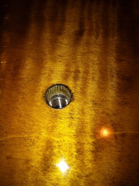

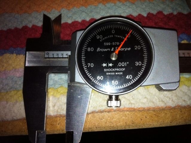

kidsmoke Posted June 27, 2012 Author Posted June 27, 2012 here's a pic of my guitar. Sorry for the poor lighting. did not finish the job last night. Gonna grind down a 1/4" dia dowel pin so it's short enough to do the job of the screw in the video. There is too much pressure retaining the bushing, I want maximum surface contact on all components. The bushing is .410" below the top! Standard? Anyone?
H Posted June 27, 2012 Posted June 27, 2012 The bushing is .410" below the top! Standard? Anyone? I wonder if the tailpiece took a serious whack at some point in history, either accidentally or intentionally. The bushing is so far down it couldn't have passed QC like that, surely?
kidsmoke Posted June 27, 2012 Author Posted June 27, 2012 worth mentioning that this was an Ed Roman guitar to start its life. It's the only Heritage I've ever owned, so i don't know what's standard. P'ups are blackbacks, his proprietary SD p'ups. So to some degree at least, he received this guitar without components. Perhaps the hardware was all installed in Vegas? I have absolutely NO idea.
DetroitBlues Posted June 27, 2012 Posted June 27, 2012 That would be an interesting fact to know. I replaced the hardware on my old 140, but the bushings were just a hair below the surface....
fretless Posted June 27, 2012 Posted June 27, 2012 Interesting , I'd probably send that pic to Heritage and see what they say .
Blunote Posted June 27, 2012 Posted June 27, 2012 I looked at mine;H150P and MIllie both have the inserts mounted at about the top surface level. H150 Deluxe (2011 model) seems to be deeper like yours. It would be interesting to know what the factory has to say about it.
