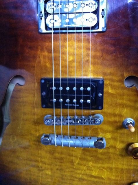

kidsmoke Posted July 30, 2012 Author Posted July 30, 2012 I intend to get some decent photos....and I still haven't finished the total refurb job....but the hardware's been swapped. And I love it. Removed: the stock TOM, a tonepros style (gotoh? "made in germany") nashville bridge and stoptail, chrome plated. Installed: Faber iNsert bridge studs Faber ToneLok Master Kit which includes ABR bridge with locking collars, Aluminum stop tail, tail studs and locking spacers, all in Aged Nickel top wrapped
PunkKitty Posted July 30, 2012 Posted July 30, 2012 Looks good, KS. Gotoh would likely be "Made In Japan". "Made in Germany" sounds like Schaller to me. Did you ever get those new pickups in?
kidsmoke Posted July 30, 2012 Author Posted July 30, 2012 Looks good, KS. Gotoh would likely be "Made In Japan". "Made in Germany" sounds like Schaller to me. Did you ever get those new pickups in? Probably Schaller then. Nope on the p'ups. He had targeted last Monday, which would have been an improvement on his normal lead times, so I haven't made it an issue. maybe this week? dunno.
fretless Posted July 31, 2012 Posted July 31, 2012 I intend to get some decent photos....and I still haven't finished the total refurb job....but the hardware's been swapped. And I love it. Removed: the stock TOM, a tonepros style (gotoh? "made in germany") nashville bridge and stoptail, chrome plated. Installed: Faber iNsert bridge studs Faber ToneLok Master Kit which includes ABR bridge with locking collars, Aluminum stop tail, tail studs and locking spacers, all in Aged Nickel top wrapped Good to hear ! Did it all work out with the bushings being inset ?

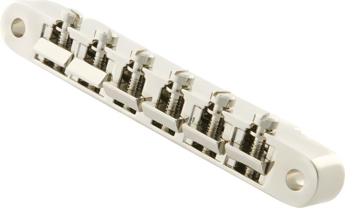

jamison162 Posted September 30, 2012 Posted September 30, 2012 Good thread....I really dig the Faber hardware, well all except the aluminum tailpiece I got, it seems subpar quality wise. The finish isn't that great and the casting is pitted a good bit around the stud collars. I'm gonna try another Gotoh aluminum sometime (not gonna spend the $$ for a Gibson, or Pigtail, etc.) I went to the Faber system on my H150 about 2 yrs ago. I really dig the locking ABR w/brass saddles and the steel posts. I did mine before the Insert kit so I had to retap the bridge posts, the BSKit or whatever it is (no biggie), so I have steel threaded posts directly into the wood rather than the retrofit bushings. The steel tailpiece studs and spacer system is genius. Only thing I did not do was replace the stock tailpiece bushings - I have no idea if they are brass, steel or zinc.
jamison162 Posted September 30, 2012 Posted September 30, 2012 Doh!! My time to edit is expired I guess. Be careful on the Fabre ABR's. I actually have two of them, the oldest is the closest to a true vintage ABR in that the screws have the cast in washer, no "c" clamps or nylon washers. The top groove that the actual saddles sit on are full length. This is very common even on current Gibson, Gotoh an other ABR bridges. The new Fabre's (locking and non-locking bridges - I have one of these also) as pictured below and on the website, IMO, are inferior to the first ABR I mentioned due to the nylon washers and shear lack of solidity. There's gaps in the top where the saddles sit to allow for the "c" clamps, etc. I've tried both bridges on the steel bskit posts that I drilled and the ABR with nylon washers sounds much "duller", kind of dead and dark if you will. A tone sucker IMO. So be warned! The first bridge that I got from Faber sounds better, I wonder if it's Gotoh or an older Shaller design. I may drill the post holes larger to allow me to use the locking bridge caps.
jamison162 Posted September 30, 2012 Posted September 30, 2012 One more thing worth noting is that the saddles on the new Fabre ABR are a little smaller (not a wide, front to back) as the original and the angle is different. I could get out my digital calipers and measure, but it's late.
jamison162 Posted September 30, 2012 Posted September 30, 2012 More accurate ABR for comparison sake.
