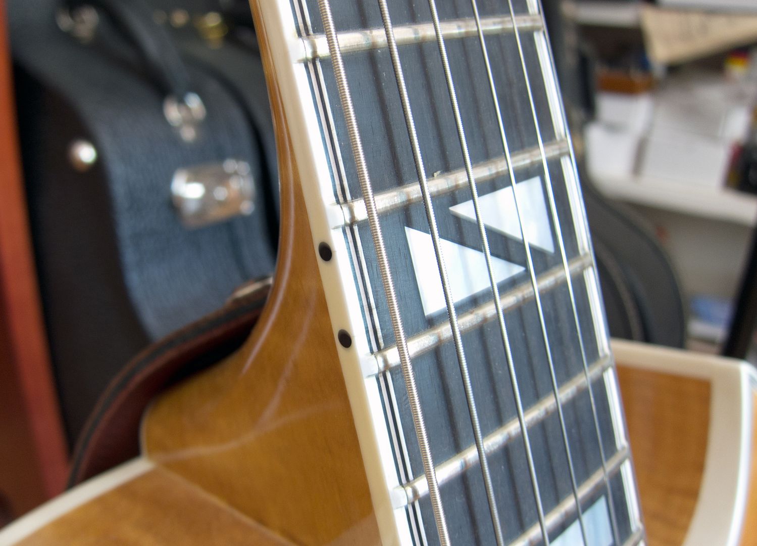

iim7v7im7 Posted June 30, 2012 Posted June 30, 2012 Here is my 2001 Sweet 16 (below). You can see that there is some modest seperation due to wood shrinkage which is very typical of an older instrument. You can also see that the nibs (I repeat nibs and not nubs) are reasonably shaped to match the fret wire. You also can see the typical stress relaxation fracture mechanics in the binding where the dots are. This happens to ABS binding. So not that this any way nullifies what the OP encountered, but this seems fairly typical of what comes out of the factory. I would not classify it as perfect but as a high quality, small factory, hand crafted instrument. I have also experienced some quality issues from Heritage on my 2009 H-535 which were discussed here on the forum a number of years ago. The quality defects related to a poorly manufactured nut, asymmetric tuning machine location , over buffing of the binding and a sanded depression in the fretboard. I was just unlucky on my custom build. That being said, after some TLC from a skilled luthier, it is a wonderful instrument to play and the defects are a distant memory drowned out by a toneful instrument. I believe defects like these to be few and far between. I would recommend Heritage to anyone considering a high quality, small factory, hand made instrument in the Gibson school of design. There just isn't much out there that can compete with them. There are better finsihed guitars, but they don't play or sound as good in my experience or the price point is 2-3x.

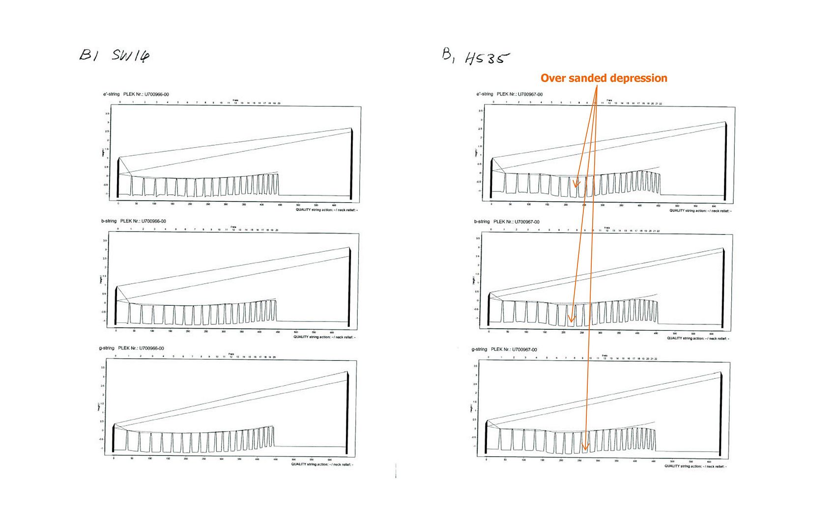

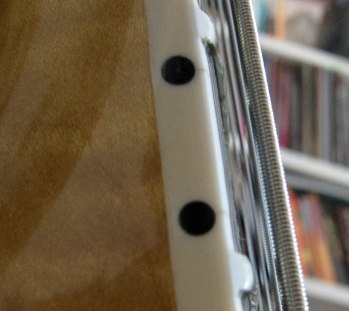

iim7v7im7 Posted July 1, 2012 Posted July 1, 2012 John, my photography skills are stuggling a bit. You can see the splits in the binding here. The other imperfections relate to small gaps between the binding at the nibs and the fret wire (very small gaps, say .002-.003") and the sign of tool marks where the nibs where shaped. That is I said that I would not classify it as perfect but as a high quality, small factory, hand crafted instrument (which is pretty darn good!). Perfect is saved for custom instruments where that last degree of finsihing and attention is applied (at a price, of course). The issues that we discussed a few years ago on my H-535 were more serious. The image below are plek scans of the e, b and g strings on both my Sweet 16 (left) and my H-535 (right) pre-plek at my luthier. Note the depression in the fretboard between frets 6-10 on the H-535. Phil Jacobly had to remove the original fret wire from frets 6-10 and replace it with taller wire in order to reach the theoretical arch. The depression is not repairable short of a new neck or a complete refret and sanding. My Sweet 16 on the other hand was pretty close to theoretically perfect, pre-plek. So the guys at 225 are capable of close to perfection and sometimes, some unacceptable stuff IMO. A depression of this magnitude is from over sanding or sanding and not being careful. This is the headstock on the H-535. You can see that the e, b and g tuning machines were drilled closer the the edge than the e, a and d string tuning machines. I had the have the nut slots custom cut to have consistent takeaway angles to the tuners as a result. In terms of over buffing, take a look at the corner of the headstock near est the high e tuner and compare the binding to the opposite side. These types of quality issues should not be let out of the door. Now CONTEXT please.... Some time has passed and I love playing this guitar and plays and sounds great. I would just say that occasionally, some issues get out of the factory when they should not have. My $.02, Bob
