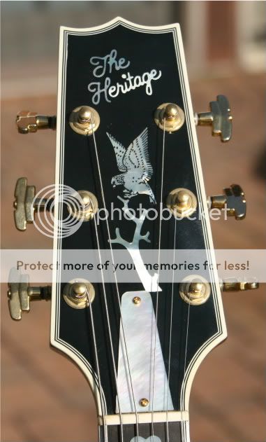

Gitfiddler Posted June 28, 2012 Posted June 28, 2012 OK, I'll admit it (again)...I like blingy gitfiddles. Give me a fully bound, pearl inlayed headstock on a 150 or 535 and I'm a happy camper. Call me shallow, but I just prefer the look of the bound headstock over the unbound version. Unless you spend the bucks for a brand new custom upgraded 150 or 535 (which I do not need) or find a used custom ordered or special edition model with a bound headstock, you're stuck with the standard black version. My question is this. Has anyone had their standard black headstock retrofitted with full binding? If so, how much was it, who did it, and how did it come out? And no, this is NOT intended to be yet another 'Heritage Headstock Shape Thread'. That topic is a total dead horse.
tbonesullivan Posted June 28, 2012 Posted June 28, 2012 Not sure. Basically they'd have to route out a channel for it, put on the binding, and then respray the clear coat... if the routing didn't damage the finish at all. The finish I think is the big issue in this case. I have seen people retrofit bodies and headstocks before. If you were asking about fretboards, I'd say "NO" because that would be far more involved and costly, as it would entail not just a longer surface area, but also a full refret.
TalismanRich Posted June 28, 2012 Posted June 28, 2012 Personally, I'm with you. I prefer my "dead horse" to have binding. I think it just makes gives a more finished appearance. There's nothing wrong with a little bling. As for a retrofit, you will need to cut a channel for the binding to fit into. That's probably going to be tough without destroying some of the finish. I think the binding is ABS plastic and they use an acetone/abs blend to glue the binding.

DetroitBlues Posted June 29, 2012 Posted June 29, 2012 I don't think it's actually bound, I think just the veneer itself is bound then glued on.
Jazzerous Posted June 29, 2012 Posted June 29, 2012 When I called the Heritage Guys said Jack is the only Luthier that does this type of alteration through Heritage . He said many famous musicians have requested this and other mods to Heritage guitars over the years ! DB is correct that the binding is only on the veneer cap so no need to do a channel in the original headstock!
Blunote Posted June 29, 2012 Posted June 29, 2012 Personally, I prefer the bound head stock as well. I like the appearance better but also that they're less likely to show dings and chips. I think that bit of binding provides protection.
Gitfiddler Posted June 29, 2012 Author Posted June 29, 2012 When I called the Heritage Guys said Jack is the only Luthier that does this type of alteration through Heritage . He said many famous musicians have requested this and other mods to Heritage guitars over the years ! DB is correct that the binding is only on the veneer cap so no need to do a channel in the original headstock! Have any of you seen photos of finished veneer headstock overlays?
